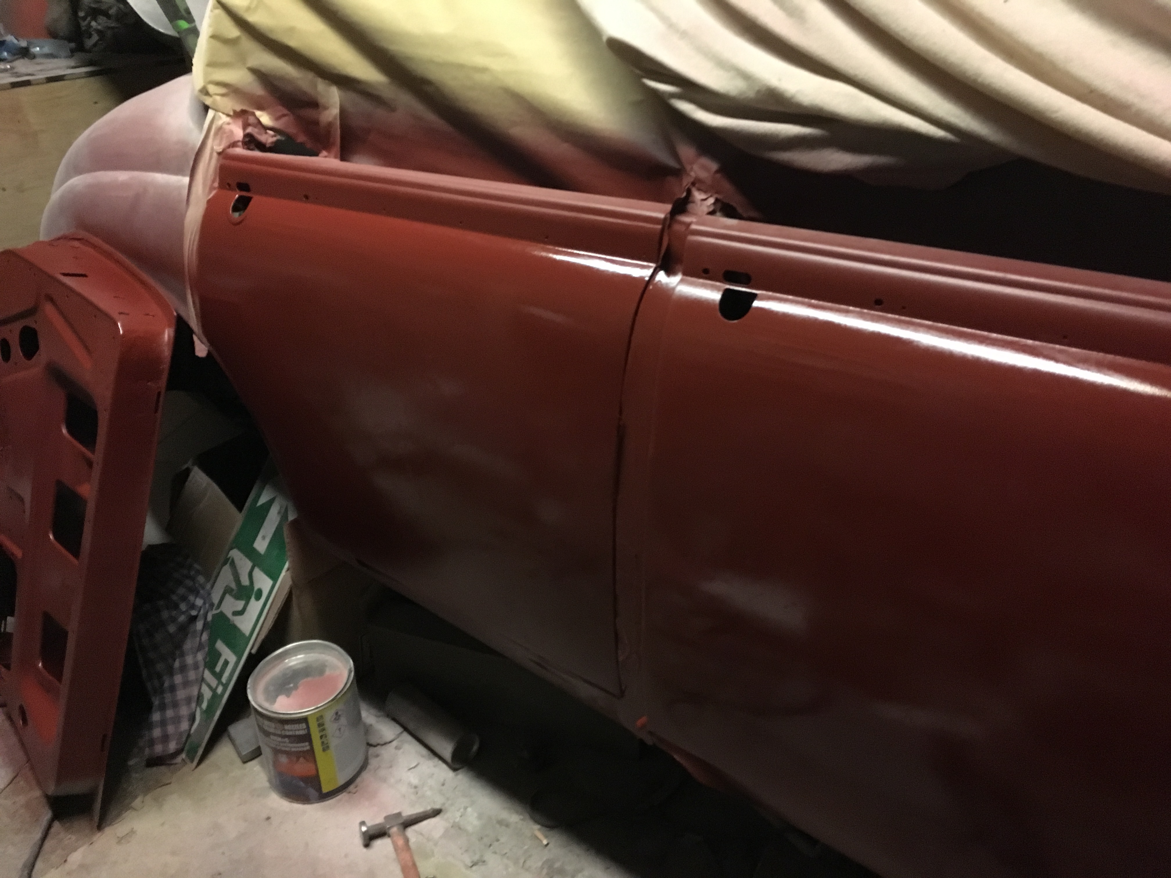

Well managed to get 2 doors on and in epoxy primer, and a 3rd door in primer, the last door skin has arrived, so I will spin the car around and get that last 2 doors on shortly.
I have ordered more Zinc rich primer for the bonnet and boot, so will get the bonnet in primer before turning her around, I can then finish the boot getting that in final paint and finish the speaker box trimming etc. I can then run the cables in the boot for the lights fuel pump etc.

Those came out really nice! You work very fast too

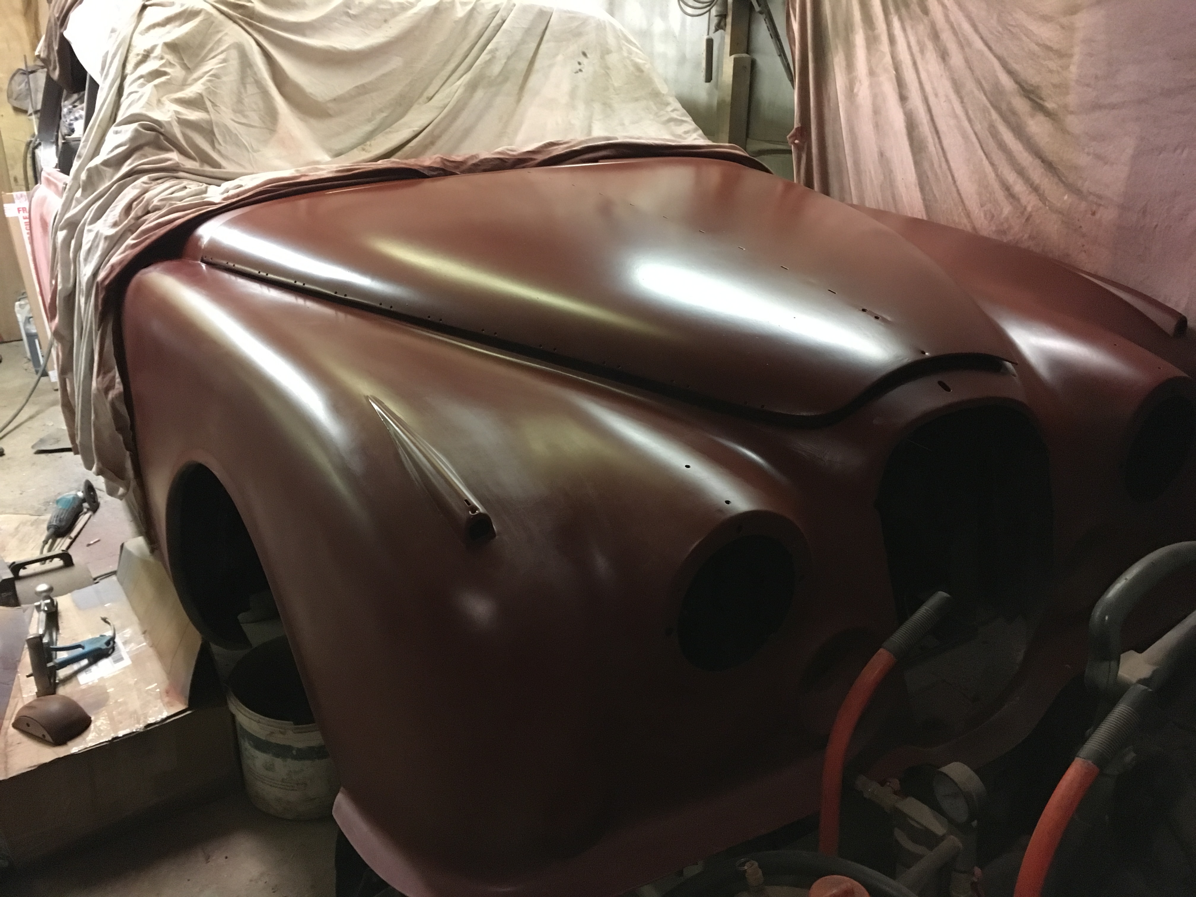

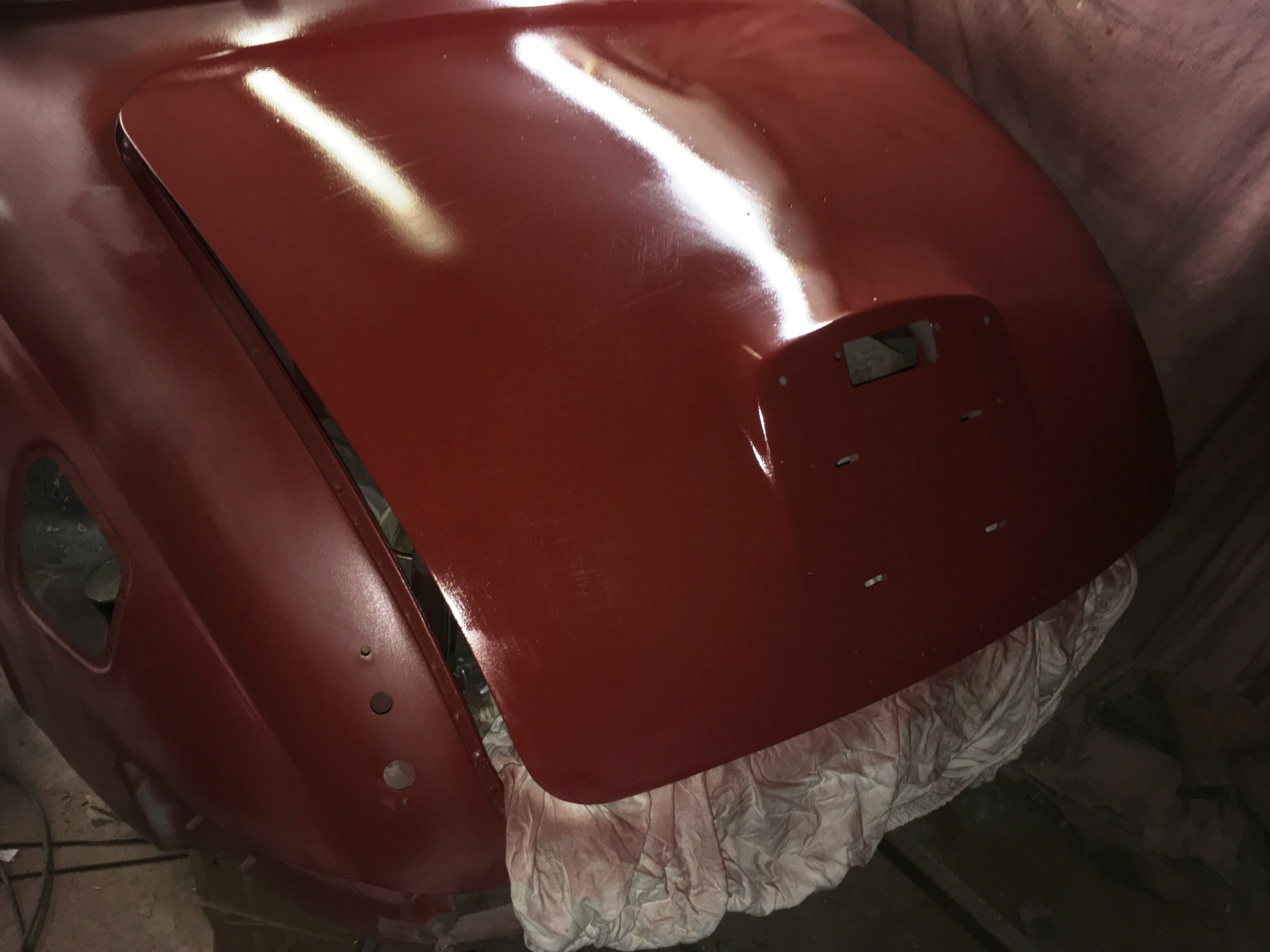

I have managed to mount the bonnet, get it into epoxy primer, and also get the boot in primer.
Just the rear Valence, 1 door skin to finish, and hang the doors, scuttle vent and filler flap and the body is done !

The Bonnet took quite a bit longer than I thought to line up, the repairs to the hinge mounting points threw it off, not a lot, just enough to make it a pain in the proverbial !
1/32nd " at that point makes a big difference at the center of the grill at the front, and when your trying to do it on your own it is not exactly simple !!!
Anyhow, the cussing is over for now. Just put the skin on the second back door, and it is nearly 1/4" shorter(front to back) than the other rear door skin, so have to gap it up with the MIG which is always fun.

That is looking more and more like a finished car!
