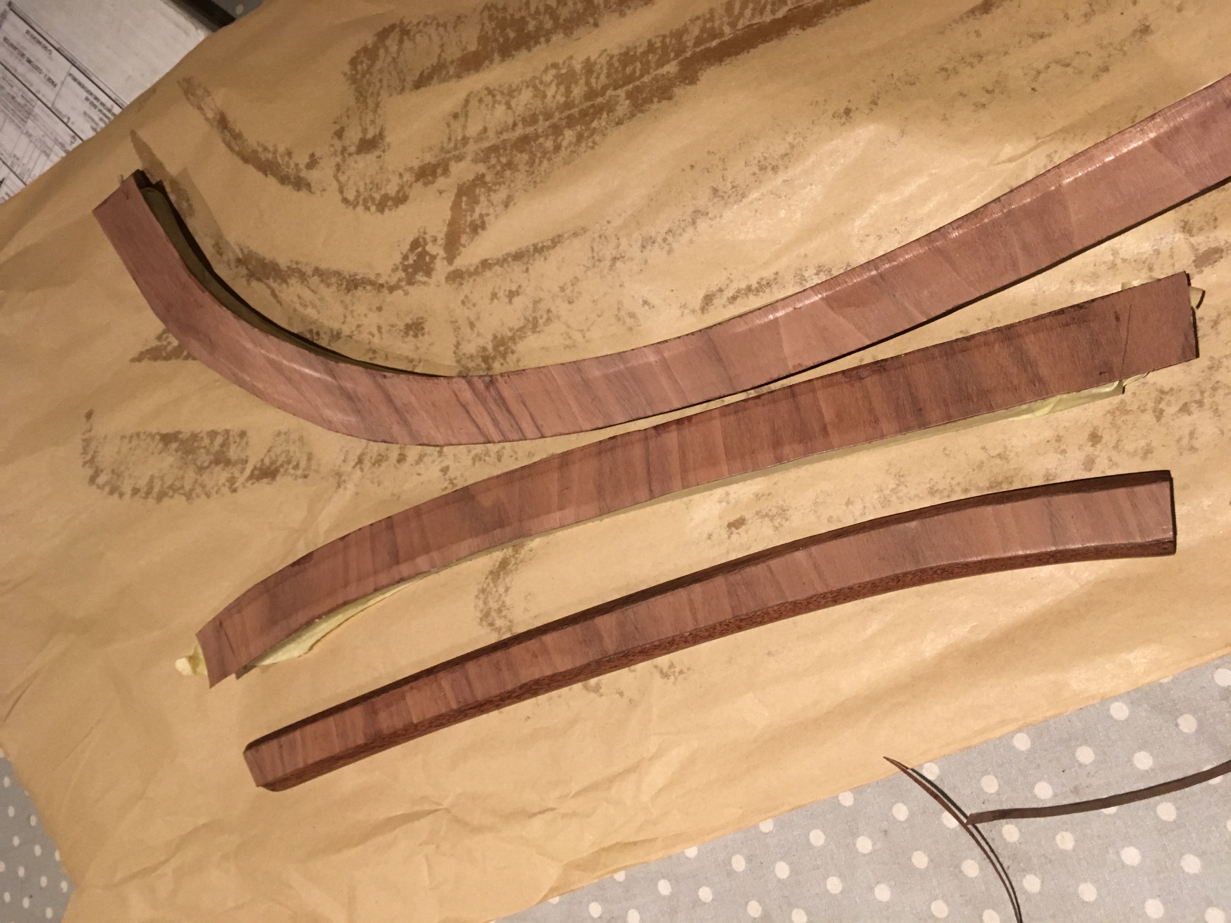

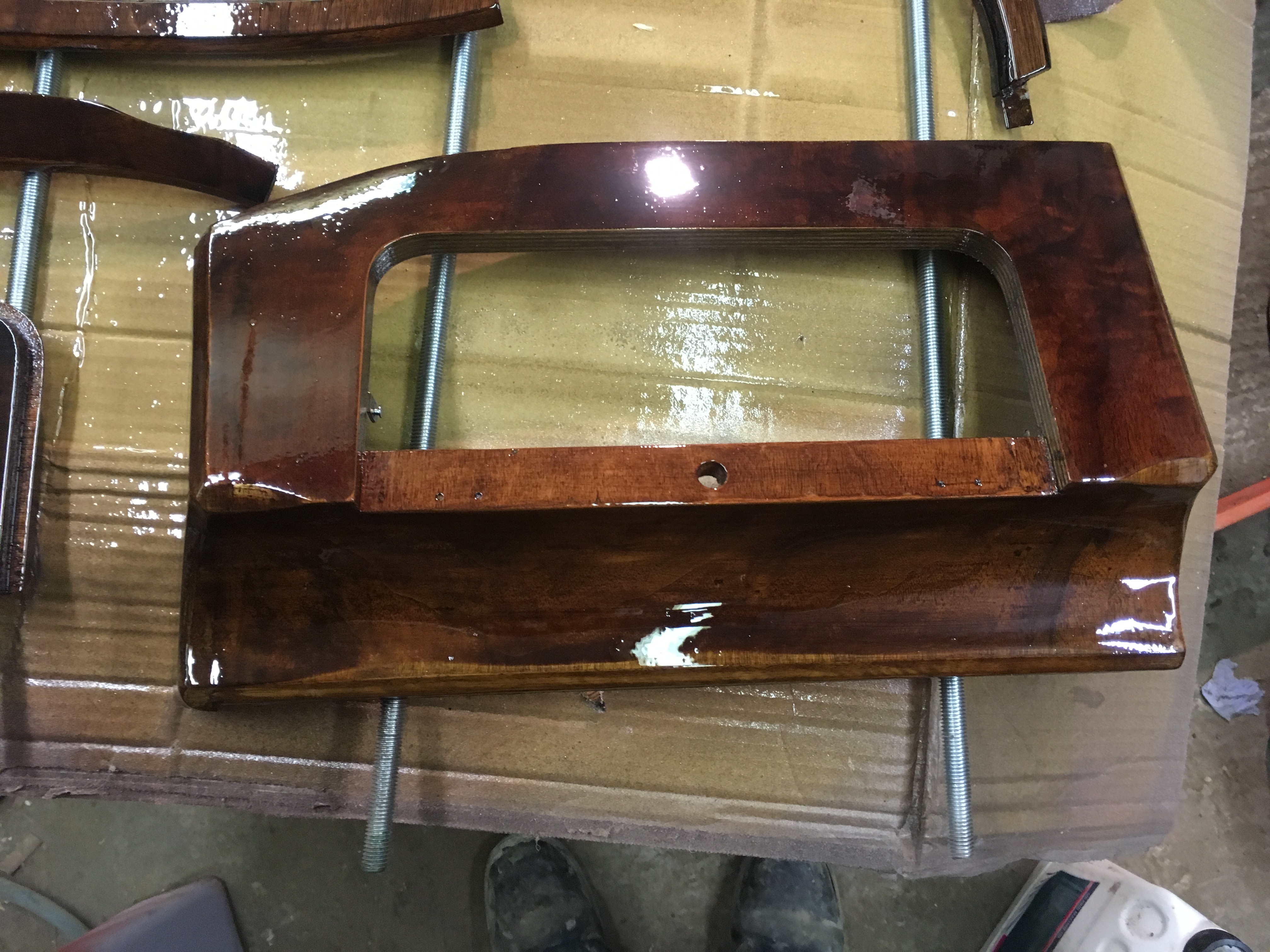

Here's a couple of shots of the veneered sections I had to re-do, these are pretty simple to do as the veneer is flat, so didn't pose much of a problem, I still have a little bit of trimming to do and spray clearcoat, but looks ok. The other hockey stick was actually broken, so I have to repair that before I can veneer it.
More pics of the other woodwork to follow, I am trying to find some before pictures, but I have a feeling I didn't take any !!

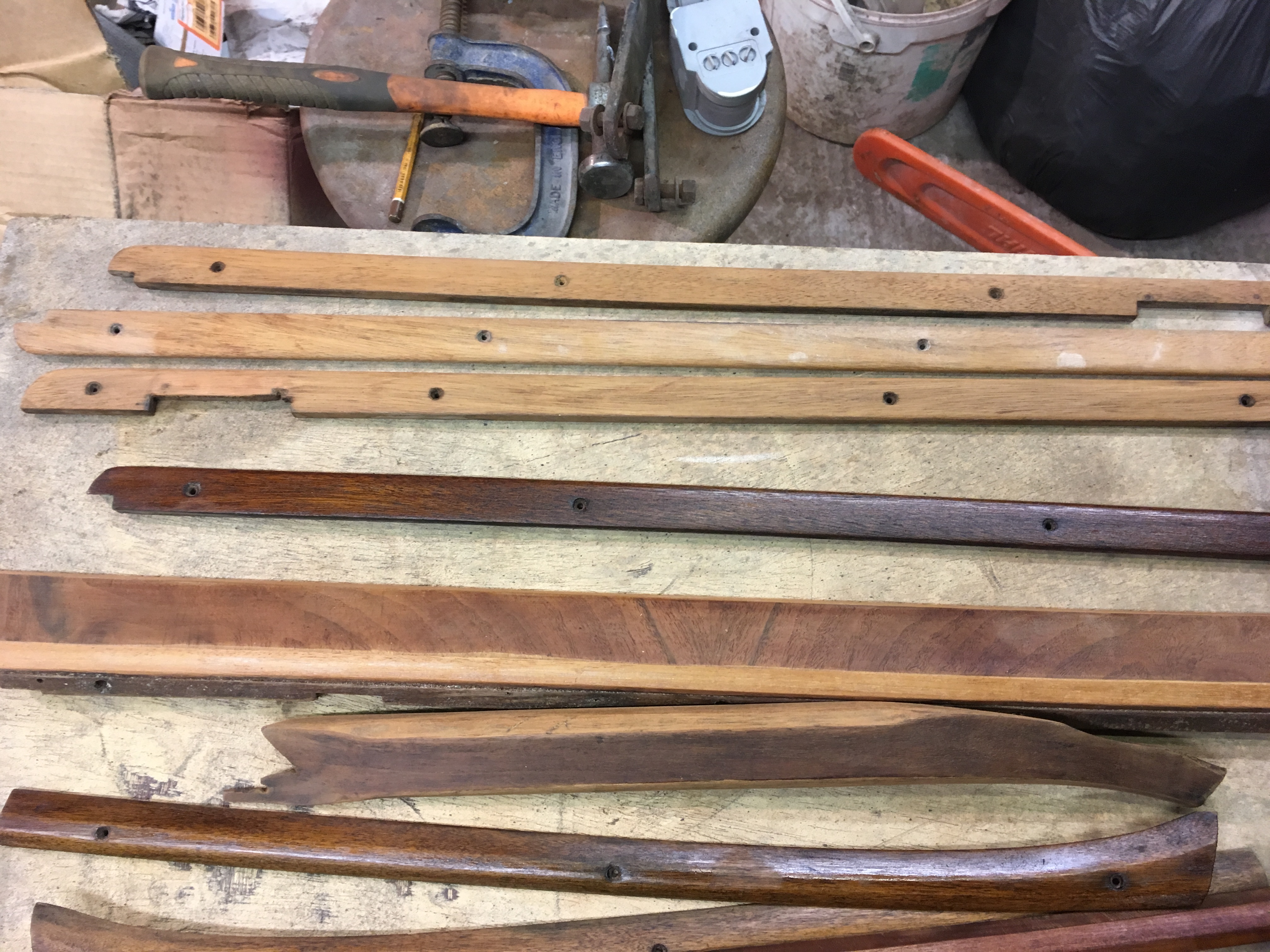

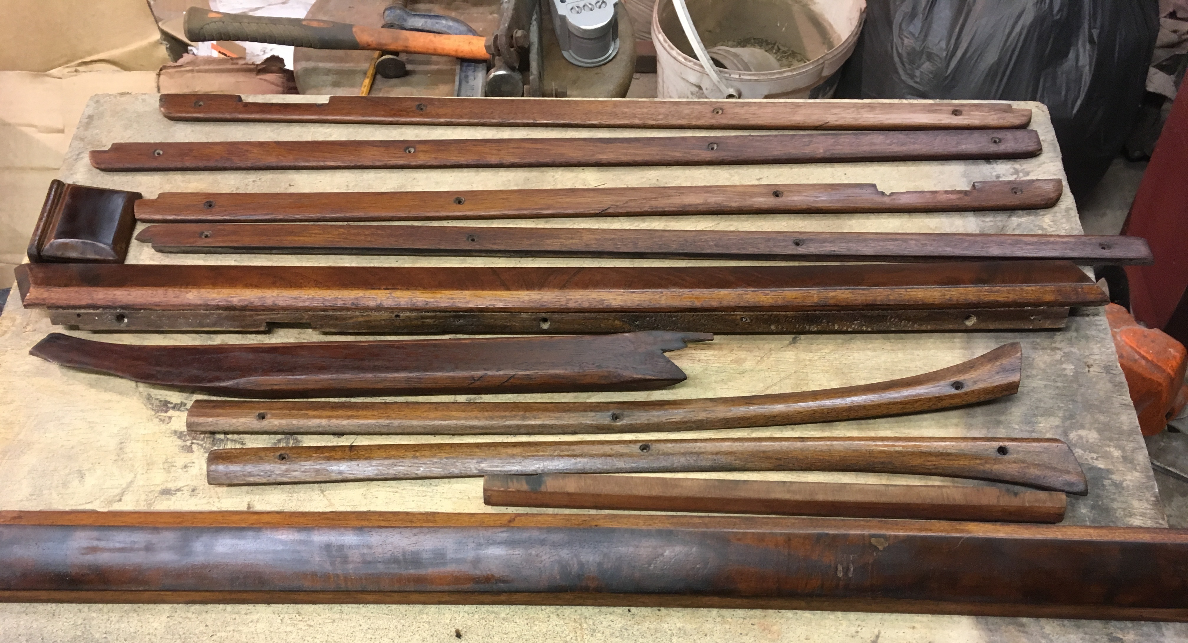

Thanks Chuck, here are a few more pics of progress.
First coat of clearcoat on some of the wood.

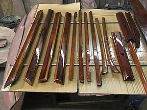

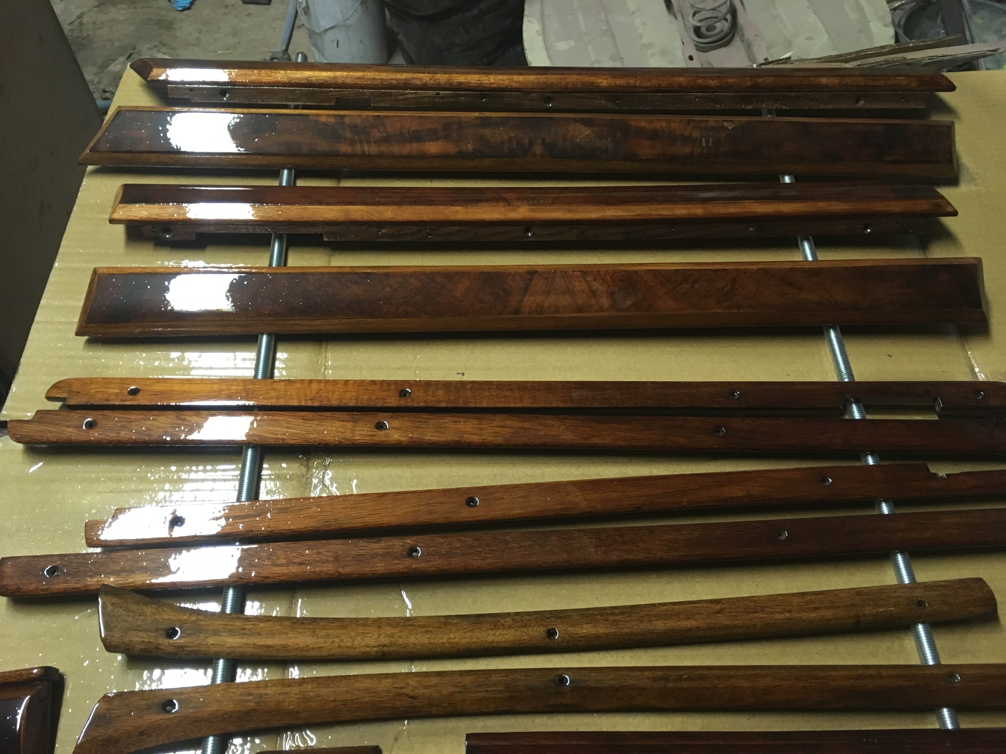

Second coat of clear on some parts, sanded back first coat before applying second coat, will sand this back again after a couple of days to harden off fully and shoot a third coat and see how it all looks.

Looks really good. Jeff advised to be patient between coats- even a week. Hard to do!

Patience is not something I'm great with when I want to do something, but when it comes to paint, I have made so many "haste" errors in the past I have to really try hard !!! Putting the heaters on and getting the workshop pretty warm helps, or I take stuff in the house and it cures faster with the extra heat.

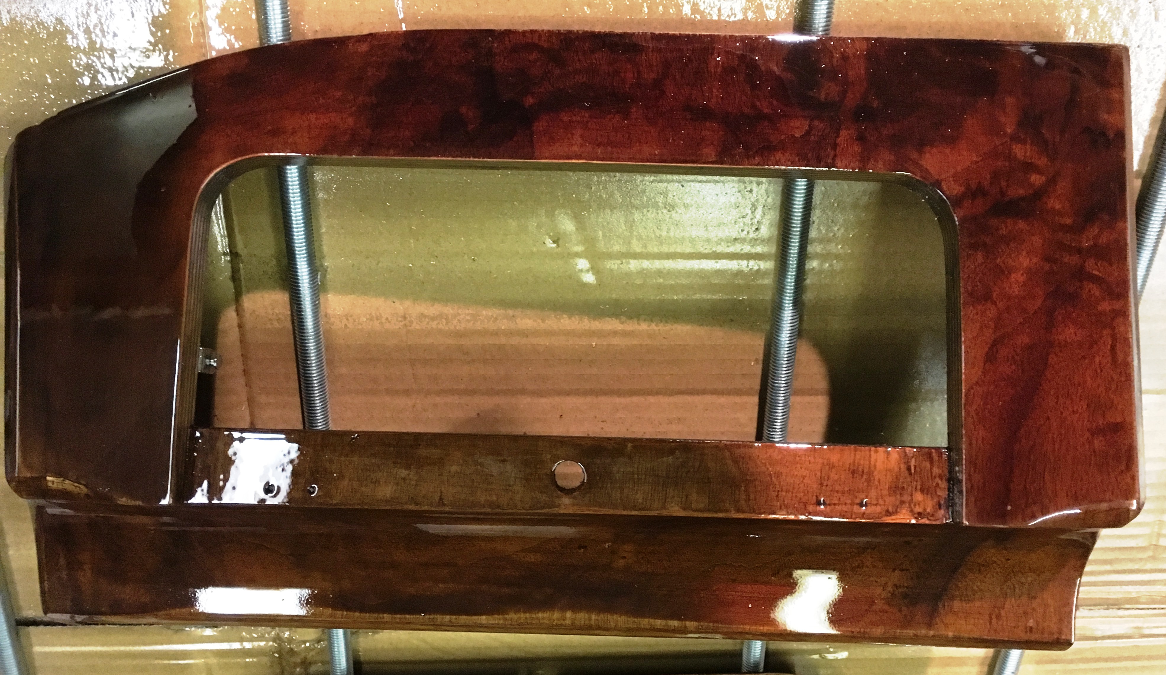

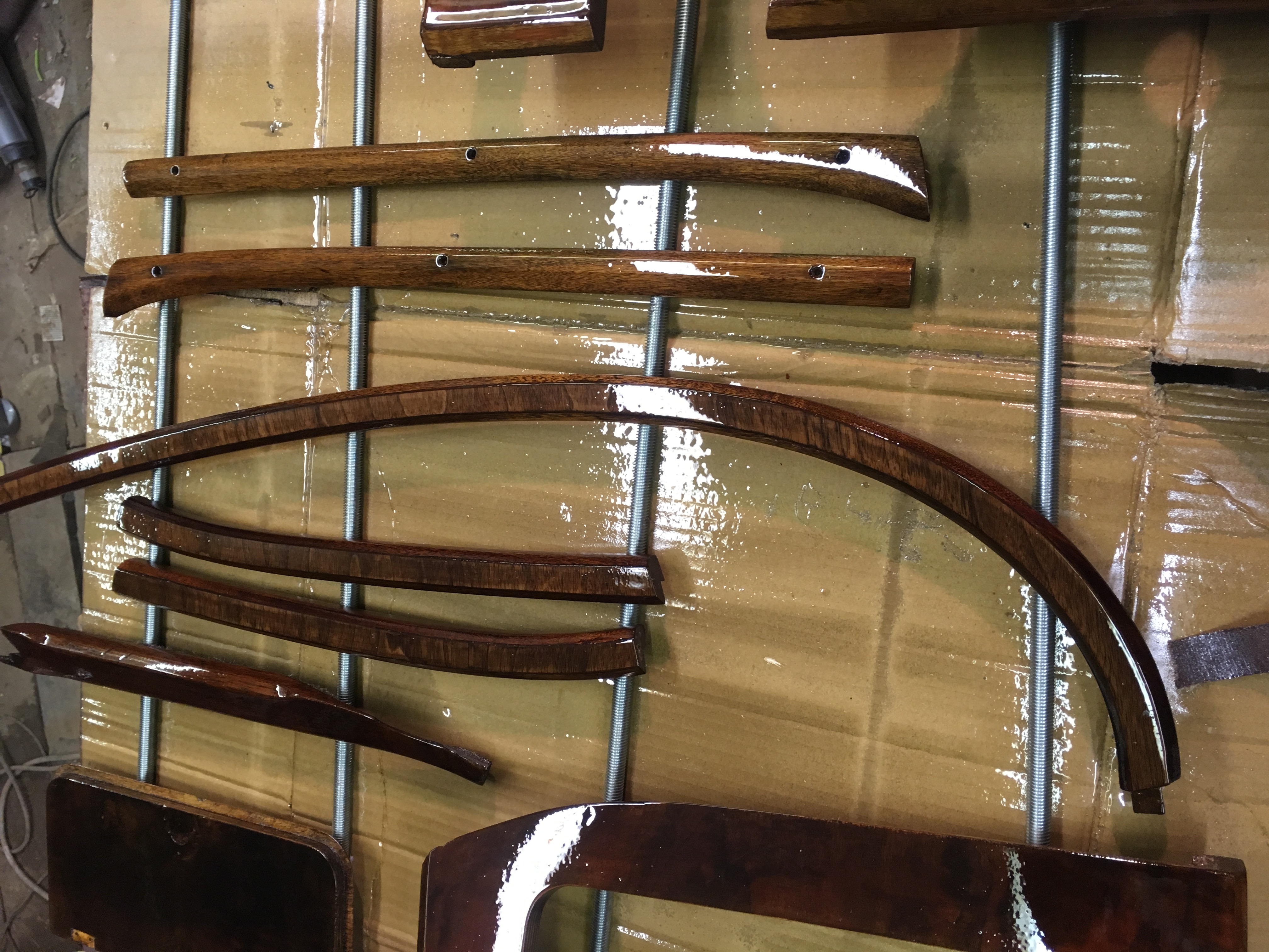

It was dear Fathers 80th Birthday last Saturday, so I had arranged a surprise party which took my mind off sanding until Monday, so all was not lost and I didn't set loose with the 340 grit too early !!
I also had a couple of other pieces I had not coated, so got a couple of coats on these too, coming up ok so far and I am quite pleased with the results to date, the clearcoat looks absolutely full of dust in the pictures which appeared to be air bubbles, not had this before but they disappeared as the clear flashed off.
Probably have another 2 to 3 coats on everything with some flatting in between before a final sand and polish with cutting compound.

Very shiny!

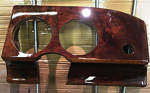

Couple of more shots with another coat on them. Still not done the one repair, one hockey stick is missing the last 3 inches ! I have to machine up a new end to match and veneer the whole piece.

I am a new member of the forum. Can you please tell me what product you are using to refinish the wood work and are you using a spray gun to apply the product ?
The results look fantastic.

I used automotive 2K HS clearcoat lacquer slightly over reduced to 20% thinners sprayed with 1.0mm tip in the spray, with a slightly higher gun pressure that usual to cut down on orangepeel.
I am up to 5 coats now, one more sand a a final coat should be there
