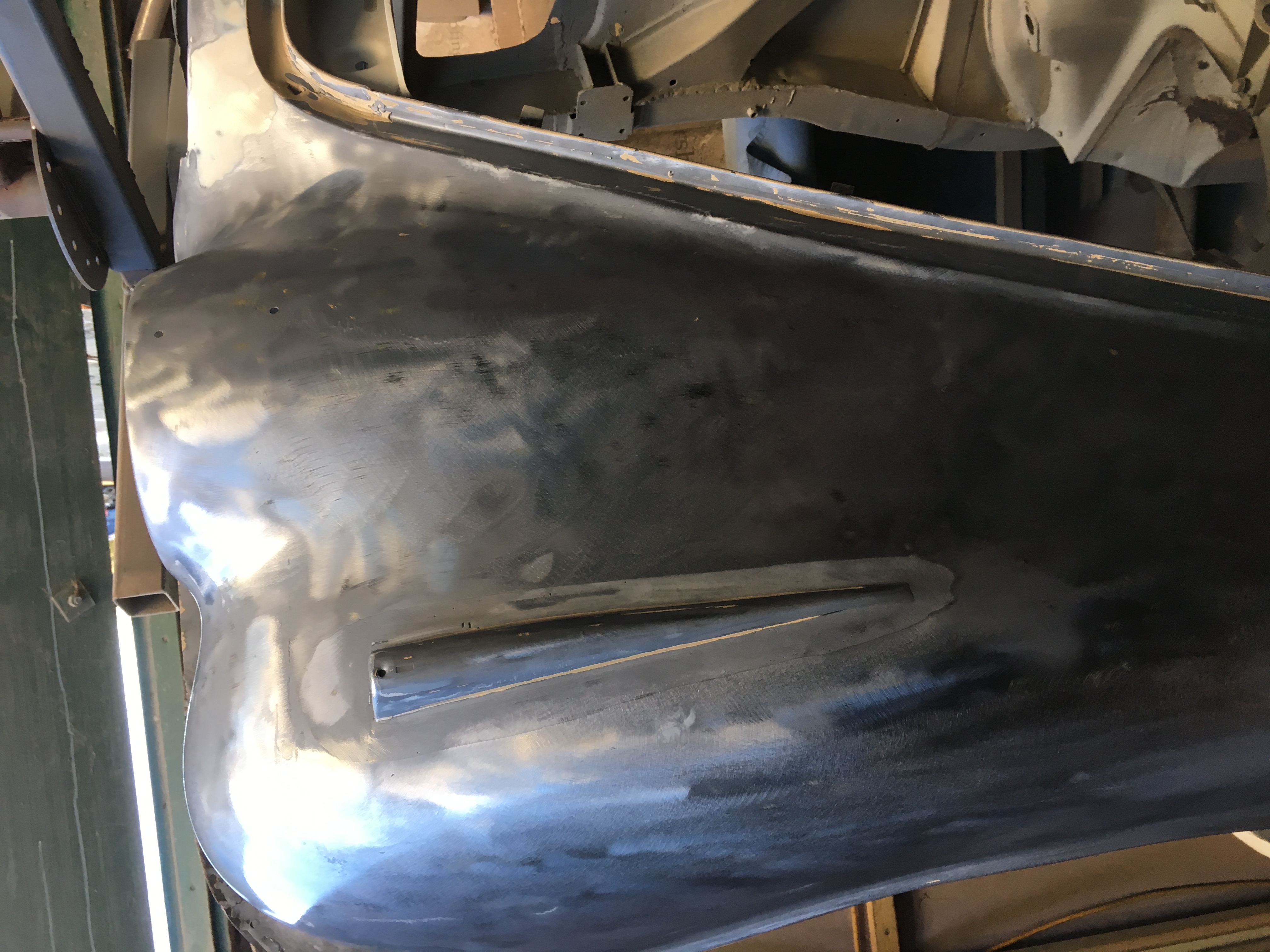

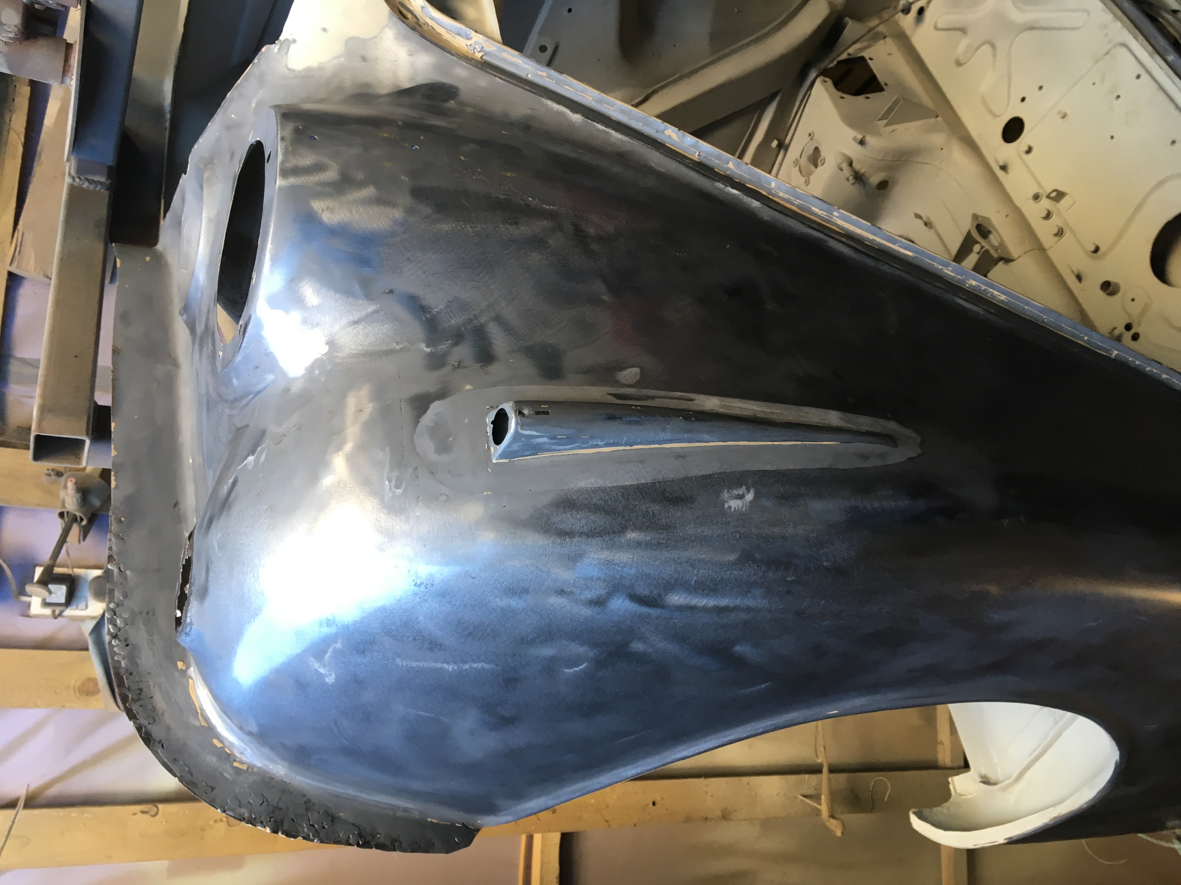

Cleaned off the nearside wing this morning went from a fully painted wing , hit the worst off with Ploy disc on the grinder, then sandblasted and then treated with phosphating solution, in all it took about 2 Hrs. so much easier than the boot !
I only have the nearside Cill and B post to finish and that will be everything back to bare metal (Well the shell that is, I still have the doors, boot and bonnet to do, but that's in a different building so I can look at what I have done rather than what's still to do !!!)

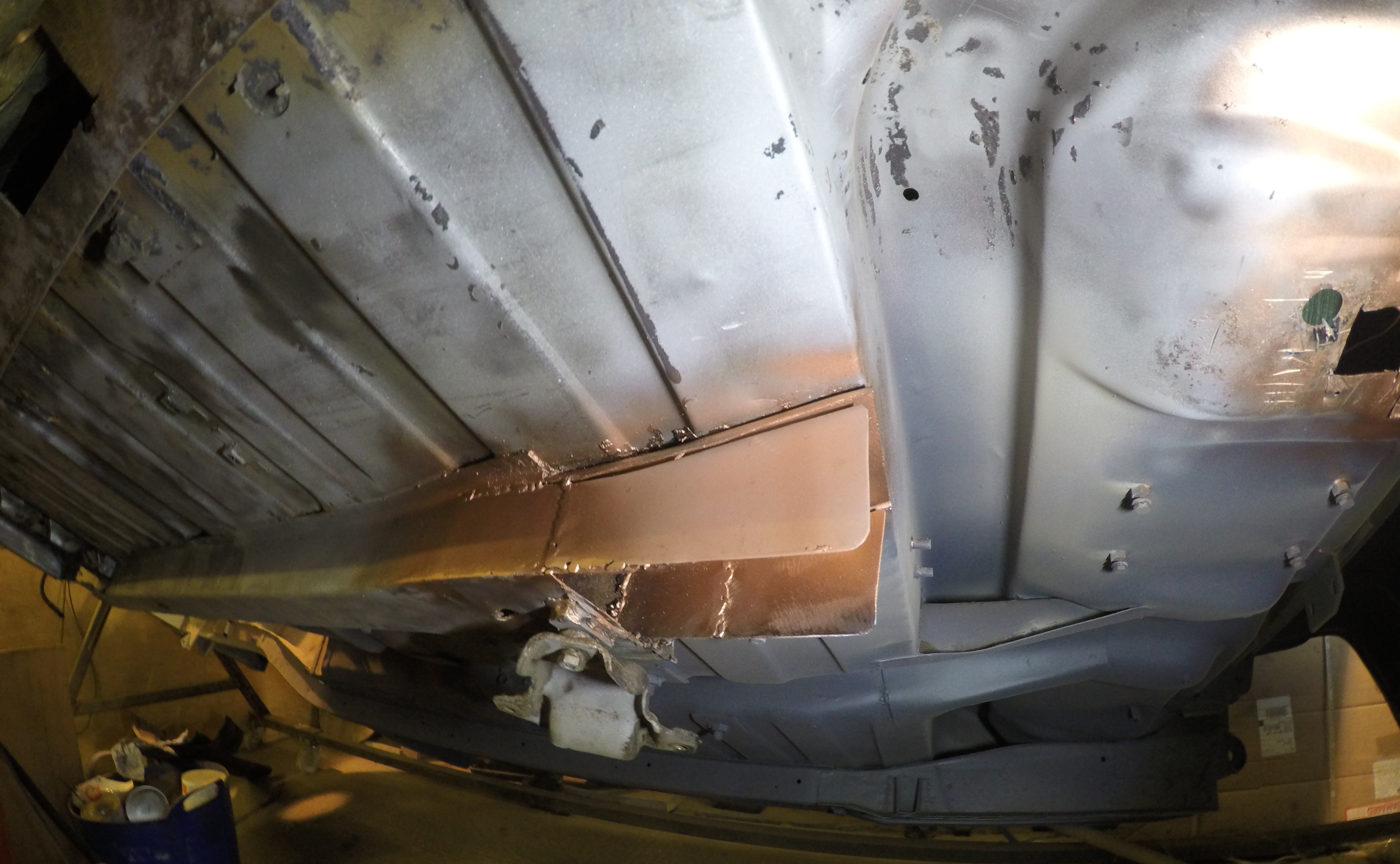

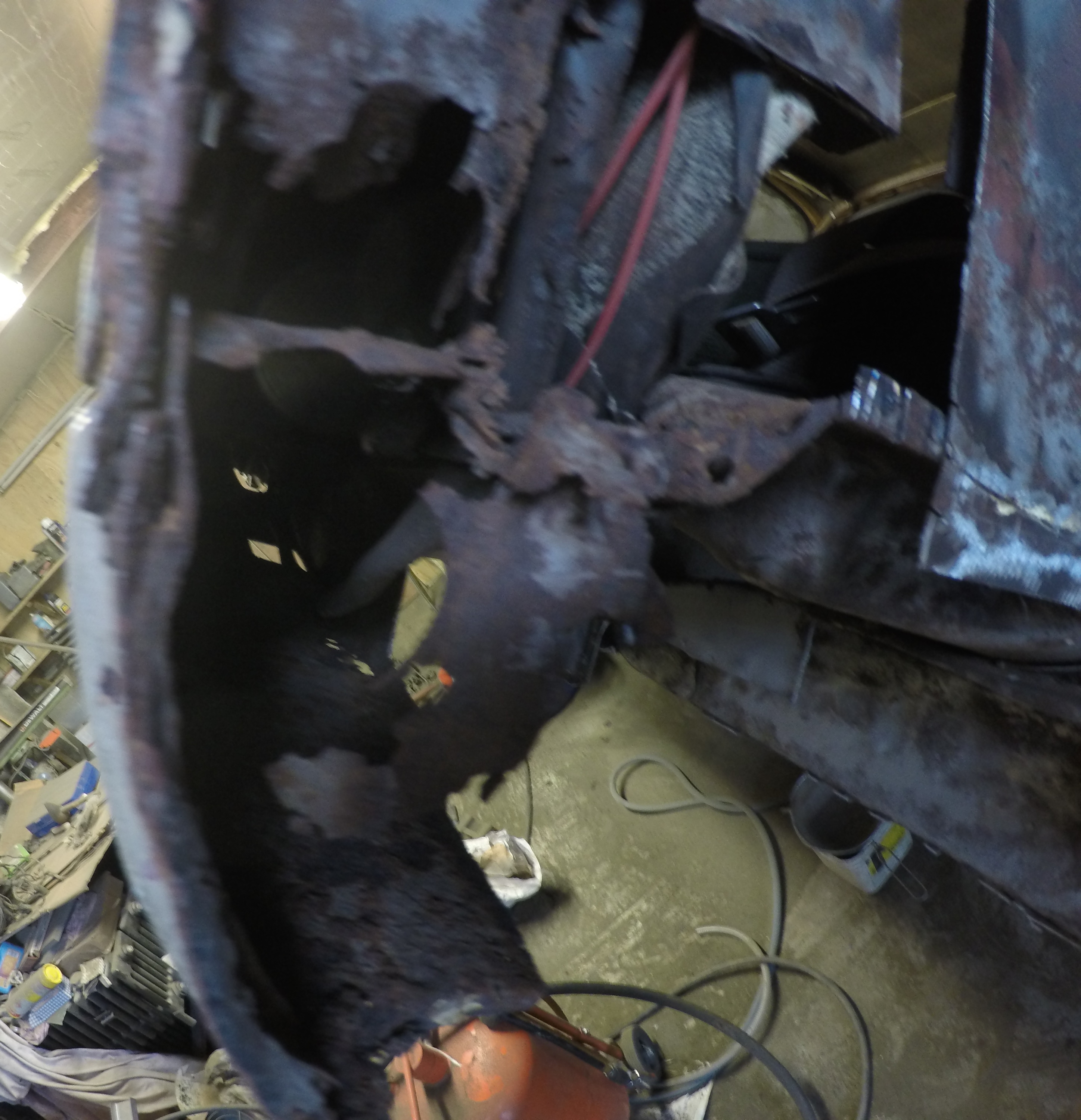

Here are some shots of the rotten right hand spring hanger box and part of the wheel arch and cill.
New spring hanger repair sections were purchased from Martin Robey, and the rest was fabricated from sheet steel, if I do this again I will buy an English wheel, it would have made life easier (if I could gain the skill to use it that is !)

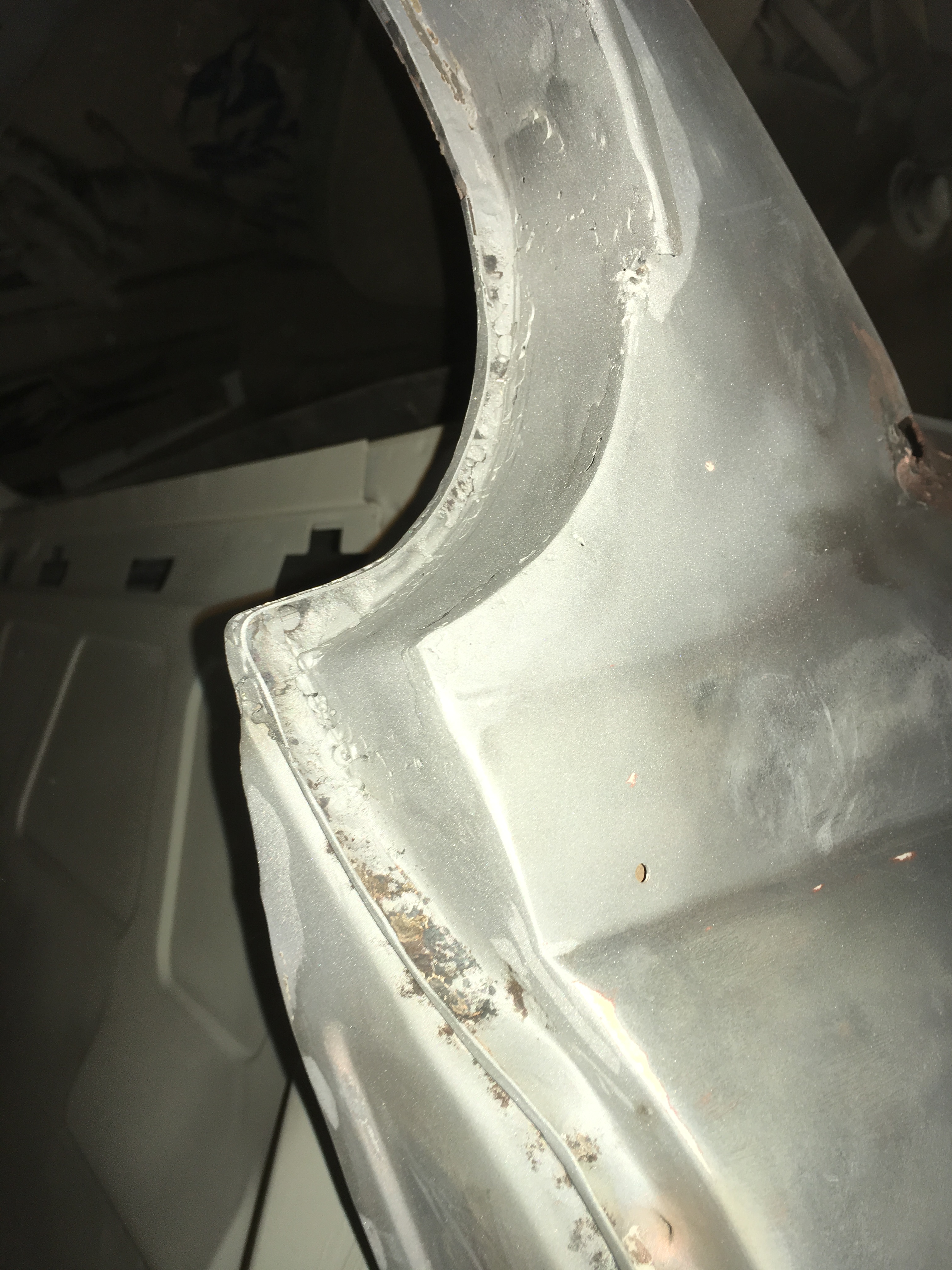

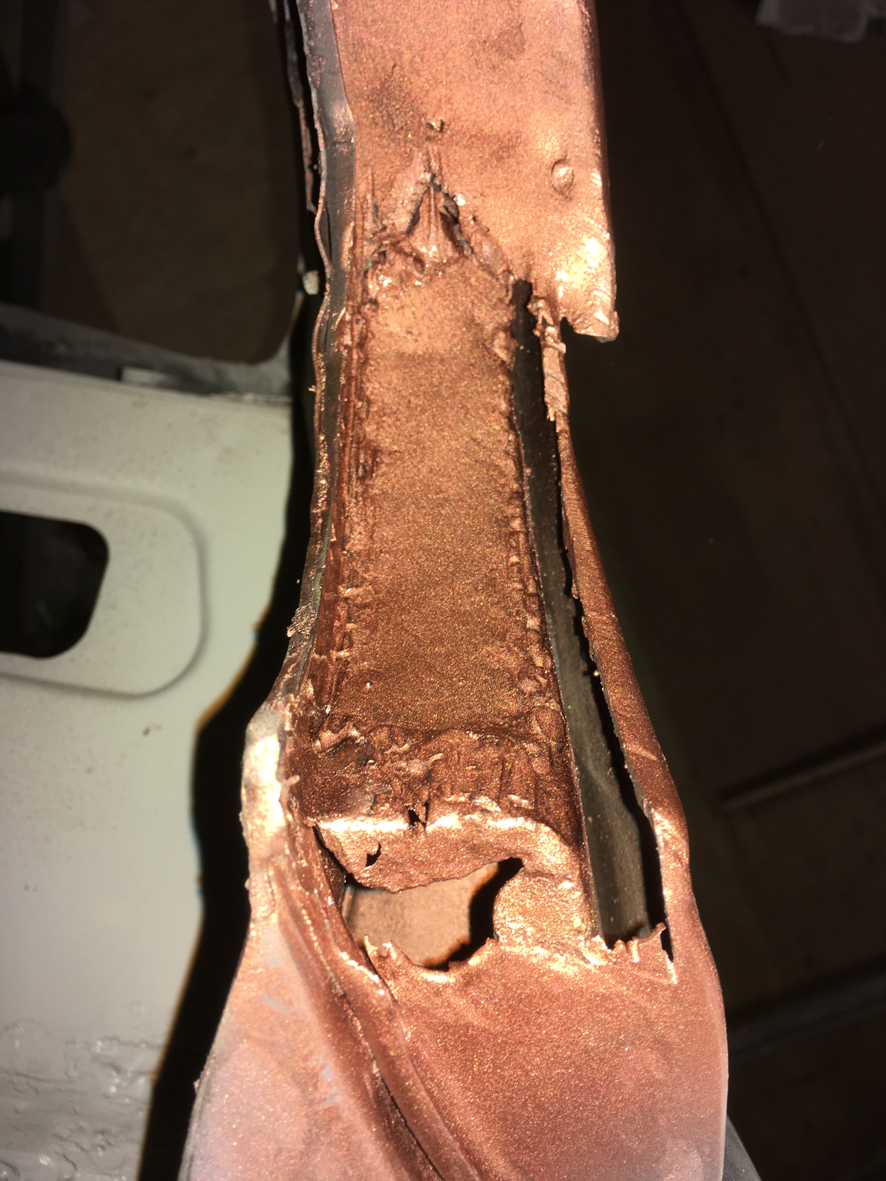

Blasting off the B post on the left and door surrounds I saw some lead where the rear quarter light goes which looked out of place, after a bit of digging with the grinder I found another rust hole !
The lead was done really quite well, I'm not sure if it was for door fit or to cover up the rust at some point as other areas of rust had been covered with filler, so I assume it was done for door fit and had simply not allowed the rust through.
There was evidence of a leak to the rear screen above this point, which must have allowed water to run down and rust this point.
Removed the rust, treated the area underneath and then after applying weld through primer welded in some patch pieces, it's now a lot more presentable.

If we are having a rust completion I have put some pictures below of the rear seat pan on mine and the panels I made to repair this, I actually had to change the panel behind the rear seats which isn't available new so I cut one out of a scrap MK2. I've also attached a picture of the front wing nose cone replacement which I had to do both sides.
Attached Thumbnails Jaguar Mk2 340 Restoration to date-2014-09-23-21.46.39.jpg   Jaguar Mk2 340 Restoration to date-dsc_0009.jpg   Jaguar Mk2 340 Restoration to date-dscf4127.jpg   Jaguar Mk2 340 Restoration to date-dscf4131.jpg   Jaguar Mk2 340 Restoration to date-dscf4132.jpg

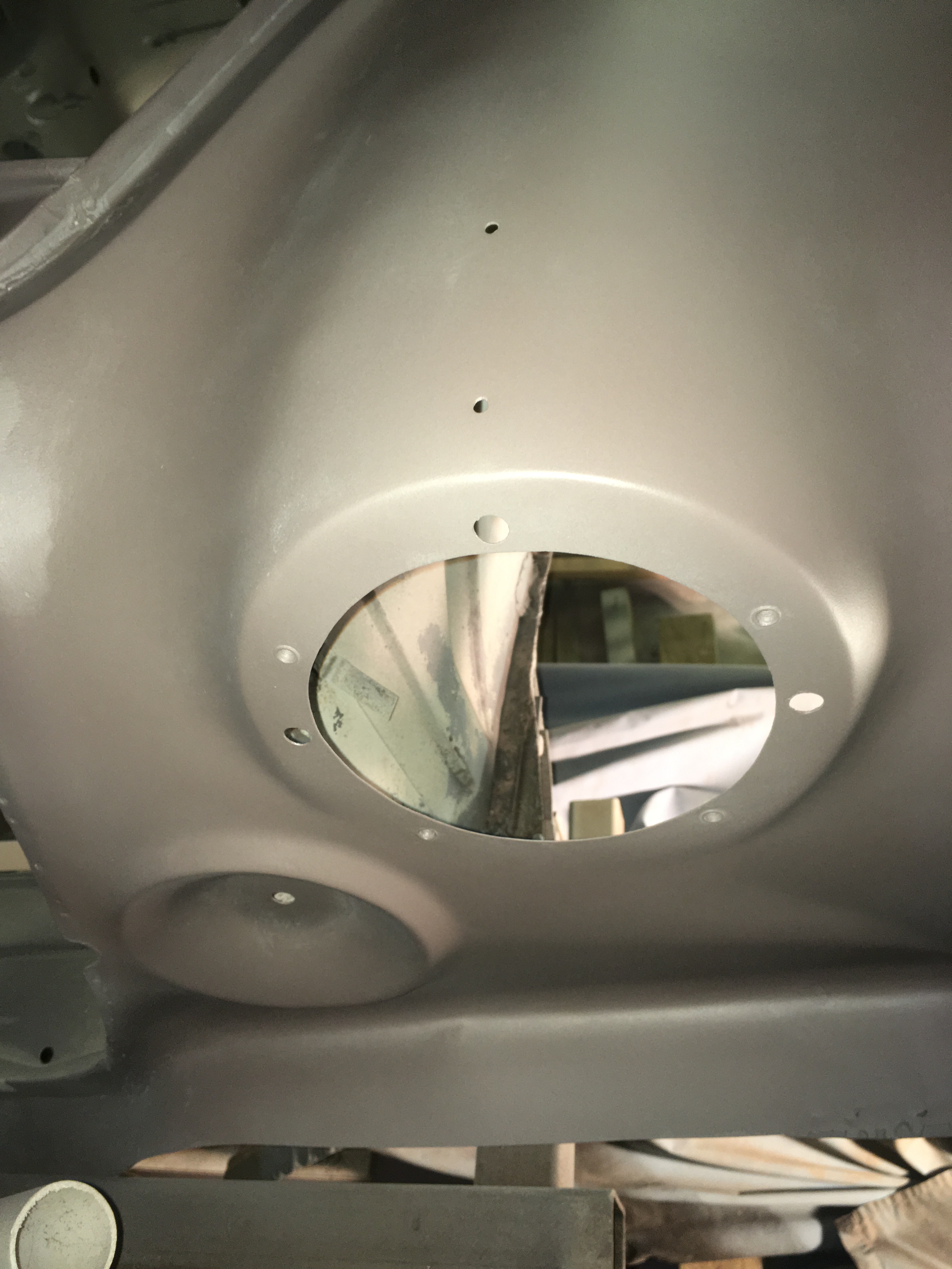

I got a couple of coats of epoxy primer on the last two evenings, I will post some pics when I get a mo, I am using a high solids epoxy mastic in a red oxide colour, which I have to warm up to get it thin enough to get through the spray gun ! It does spray nicely and sets up really hard so will be a great base. I intend to shoot another coat of grey epoxy on top so that when I am sanding the primer later I can see if I get to the red oxide coat underneath, as I don't want to compromise the Zinc base primer at all.
I have cut some holes in the front wheel wells as Primaz suggested, but have also added some splash deflectors for the wetter English climate ! Hopefully I won't have to carve anything else up later Clyde !
I will post pics of this too. I am hoping the arch repair panels arrive tomorrow so I can get on with the rear arches as that is the last of the fabrication on the main shell.
