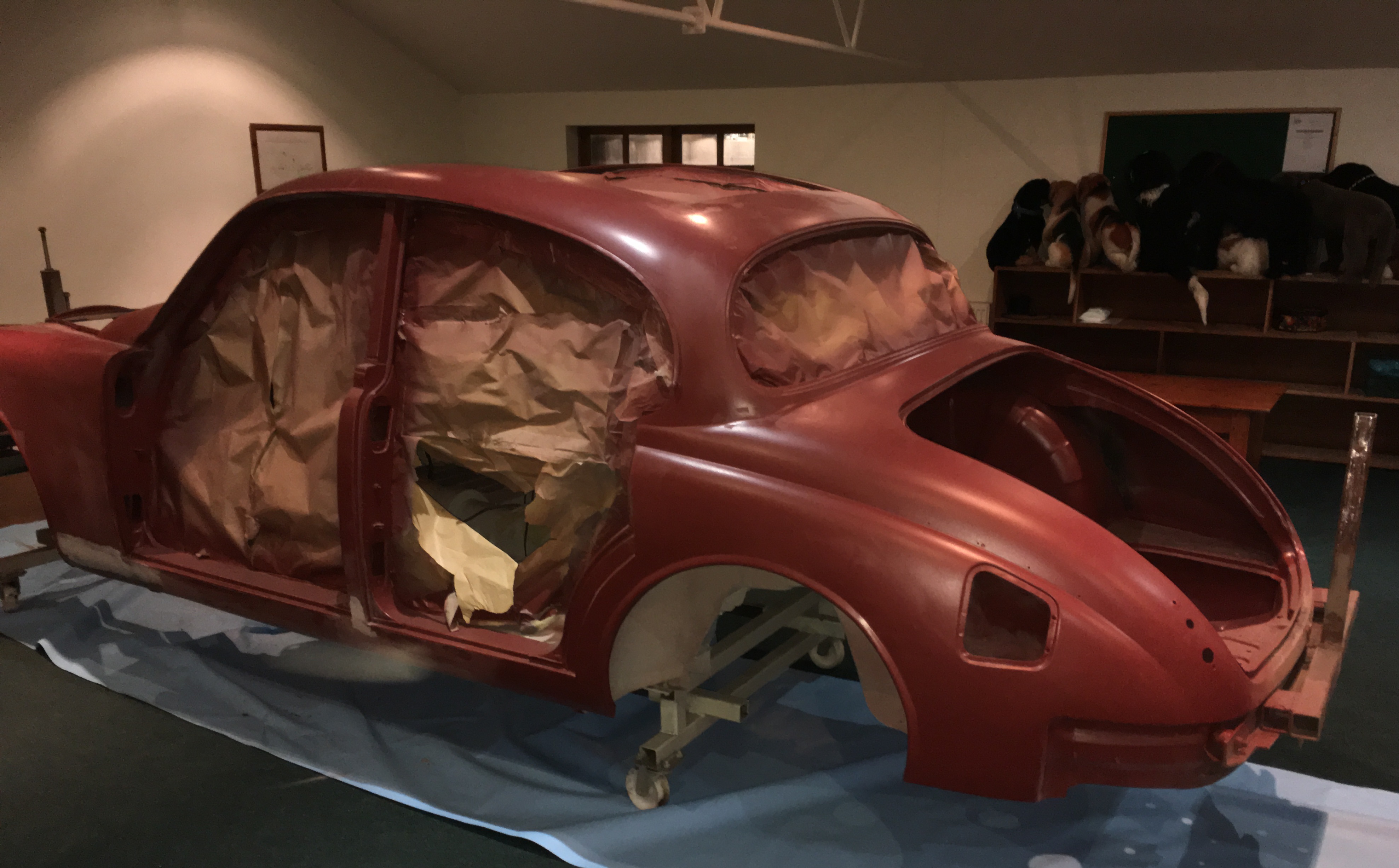

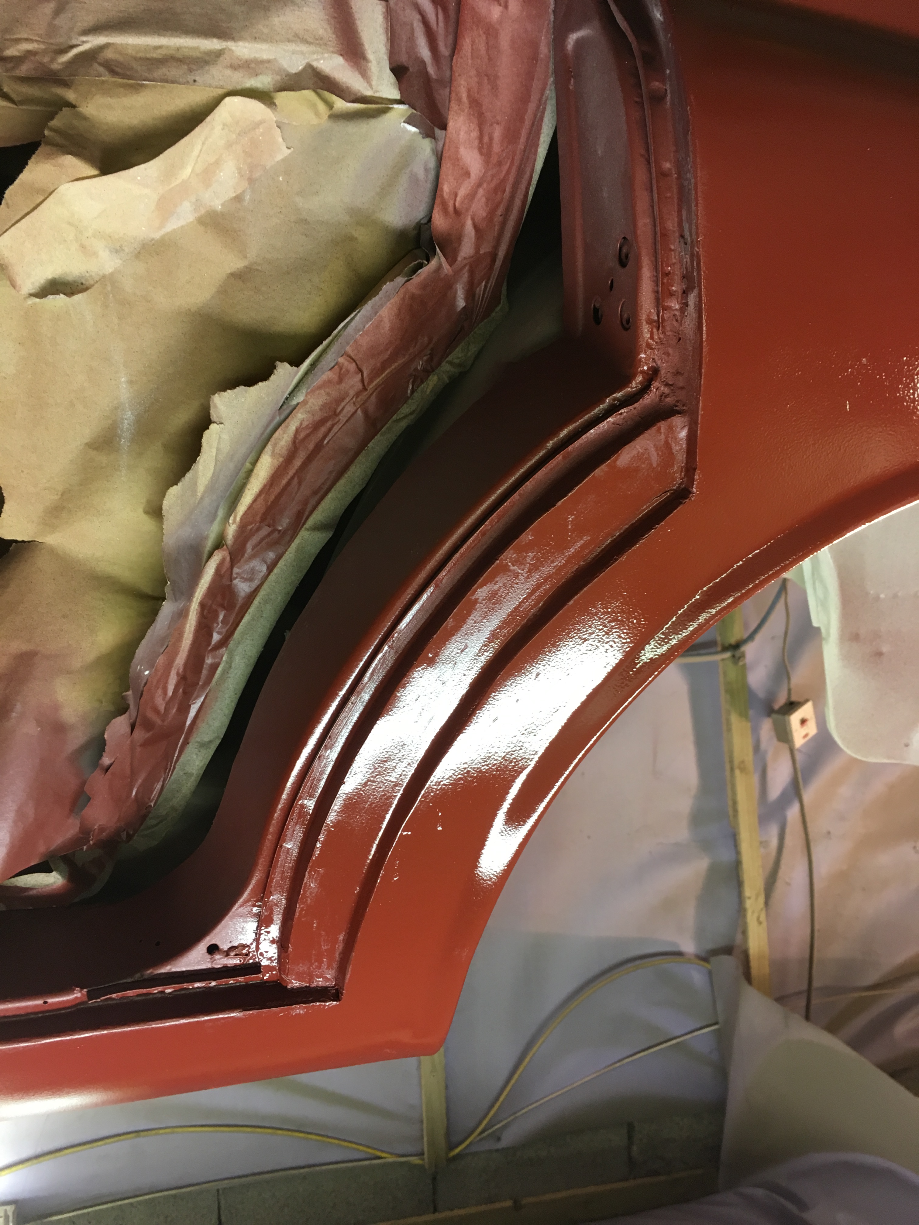

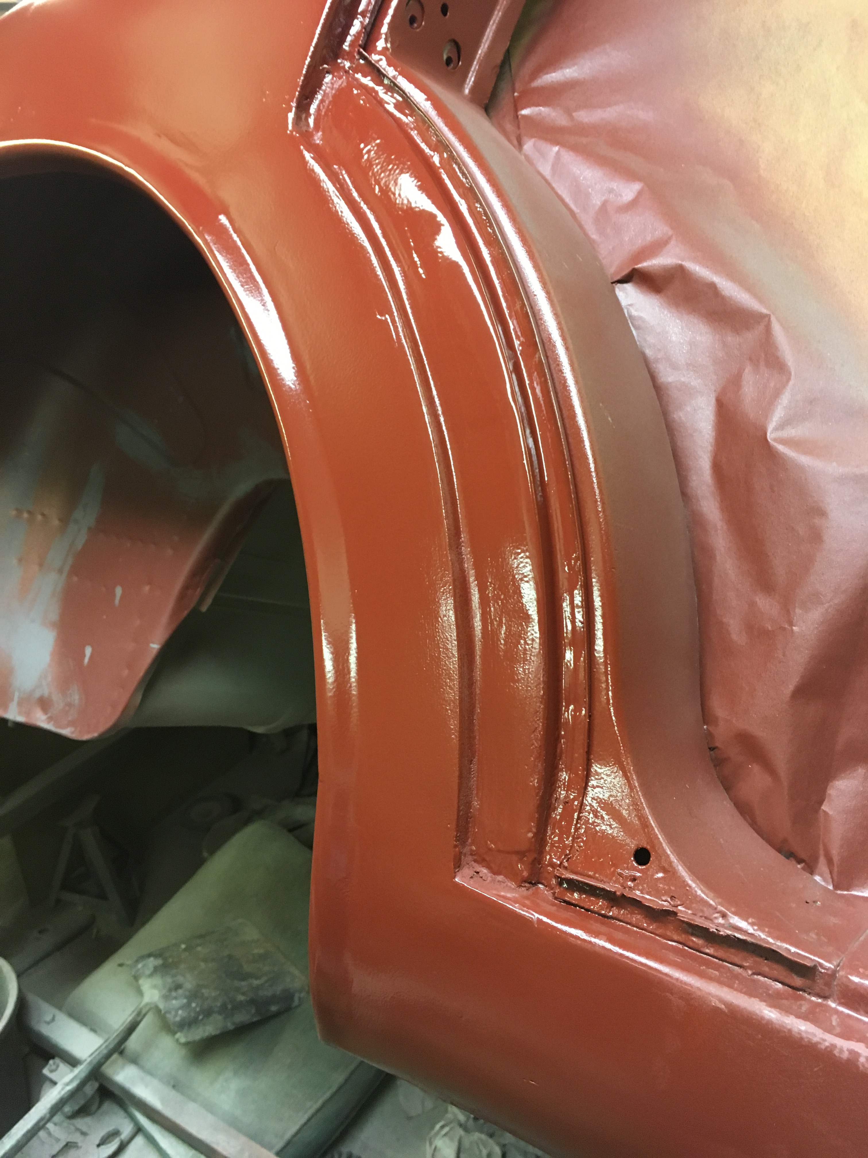

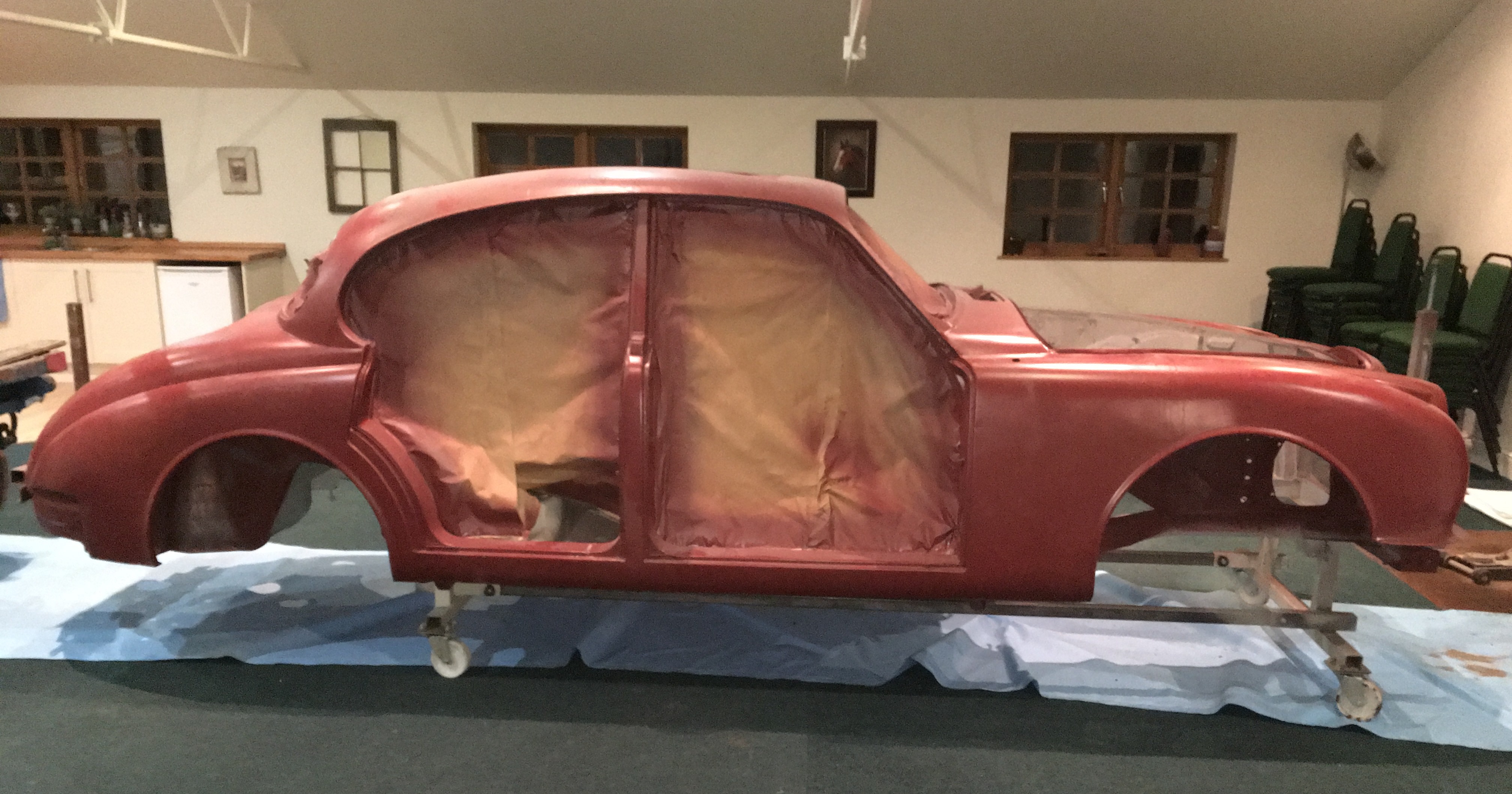

Got a chance to finish the arches and get a coat of primer on, fully welded the closing pieces by the door shut as recommended by Doug (Thank you Doug) so I'm happy that no water will get in there.
The epoxy primer mastic is really thick stuff shooting it through a 2.0 needle setup but without over reducing it there is quite a bit of orange peel, so it needs to be flatted back between coats, but film thickness is good so there is no issue there.
The body will get at least 4 - 5 coats of epoxy primer for a really good base, left for several days between coats and flatted back each time, should then have a dry film of approx 0.5mm of epoxy primer as a base, which will be left until I'm ready to prep for finished painting

I'm getting the car off the rotisserie tonight and onto a floor dolly so I can wheel her out of the workshop into another spot so I can start the front and rear axle rebuilds, I will post some pics when she's in the other spot as there is more room to take pics.

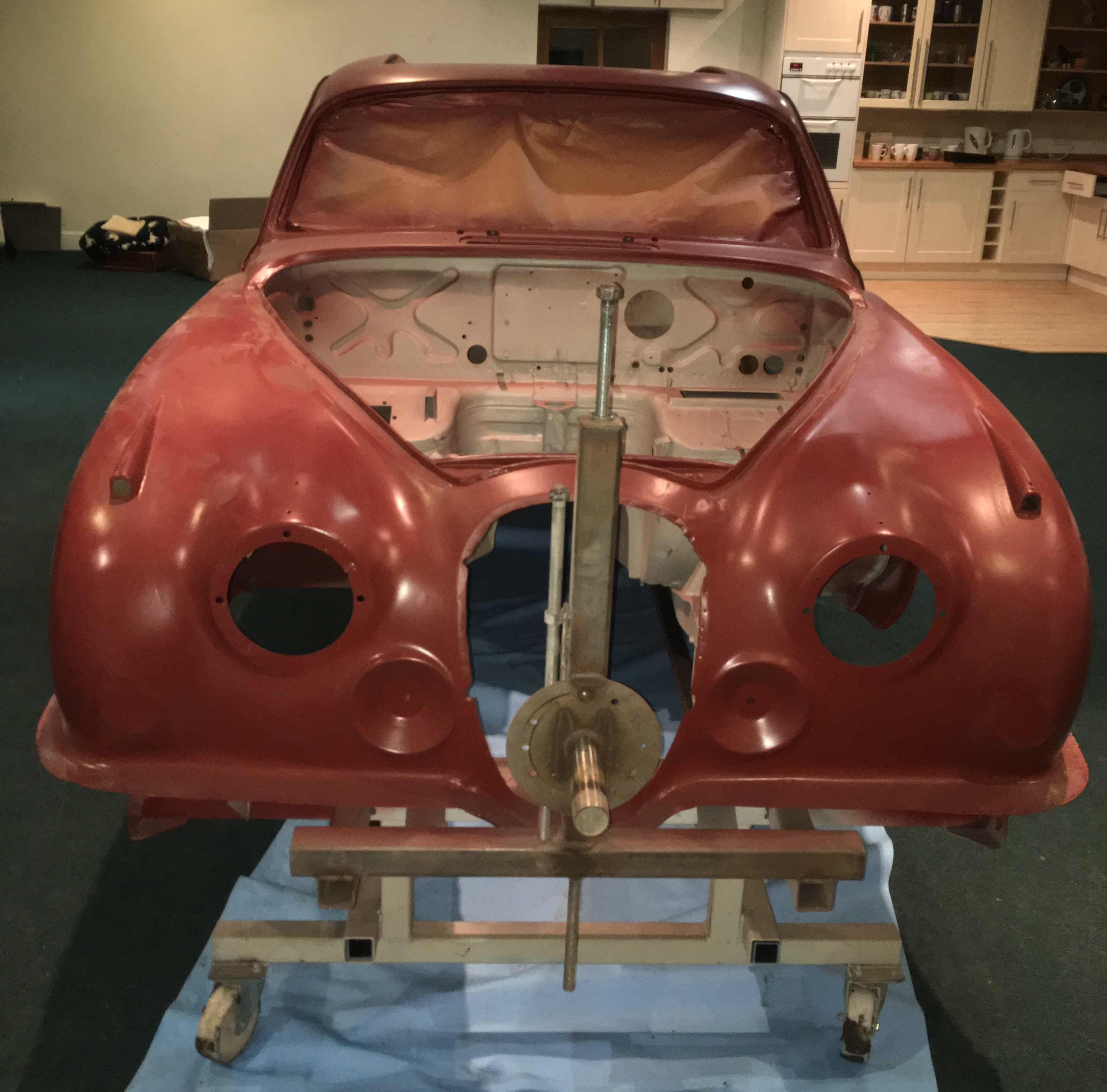

Pulled the old girl out of the workshop tonight and go her into another area, this isn't a work area so just need to make some space in the workshop to do the axles and some other bits.
I'm pretty pleased with the progress, it's good to see her out of the workshop for the first time in a year !
My workshop isn't big, I would say I can't swing a cat around in there with the car in it, but technically her the car on the rotisserie I actually could !
Will start on the axles tomorrow evening now.

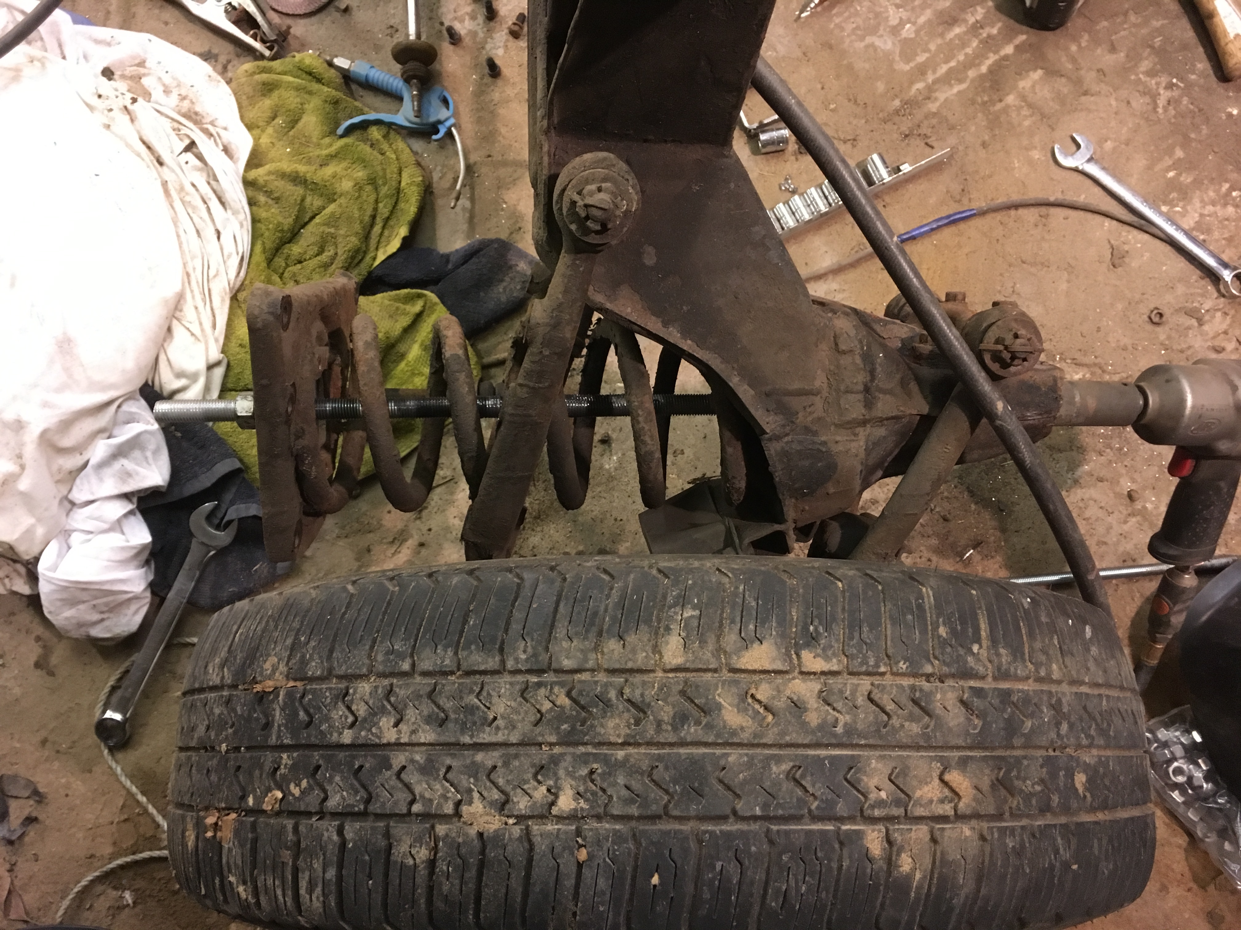

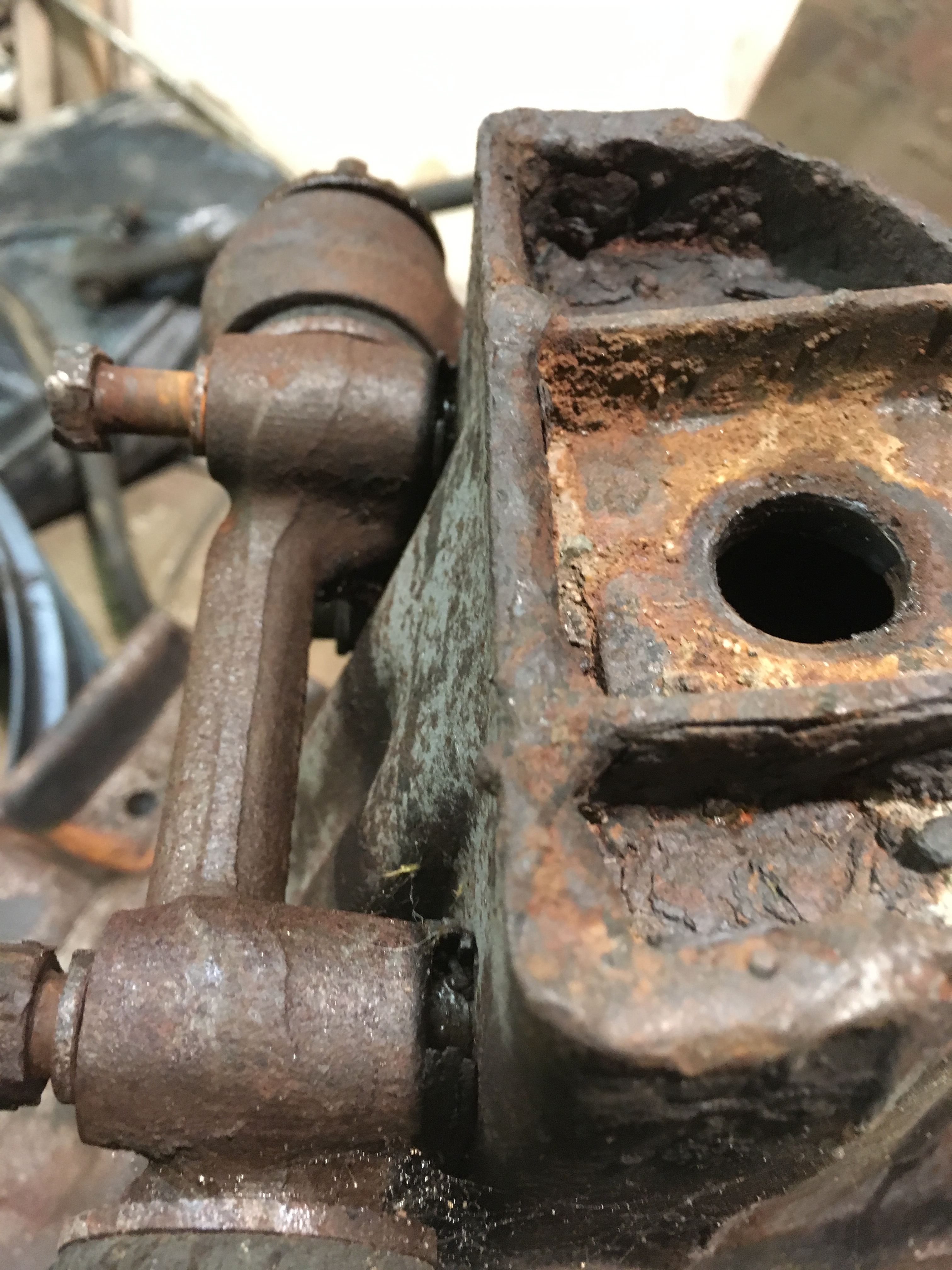

Started dismantling the front axle and got some initial blasting done over that last few days, I have been too busy to get much time.
I think the front mounts were pretty shot !!
I will disassemble completely now I have got the worst off and finish blasting the parts and get them back into paint.
Here are a few pics before and after blasting.
