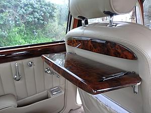

I took the entire front and rear seat from a Jaguar Vaden Plas for my 3.8s. You do have to modify the front mounts and for the rear you need to section it about 1 foot. I also upholstered the door panels and carried the design of the seats to the door panels to make it look cleaner and then everything looks like it came factory. I like these seats and love that they have the picnic trays!
https://www.jaguarforums.com/forum/m...st-done-73952/
You can see the modifications for the seat mounts on the link above.
These seats are so much more comfortable as the stock seats do not provide adequate back and zero heat support.
