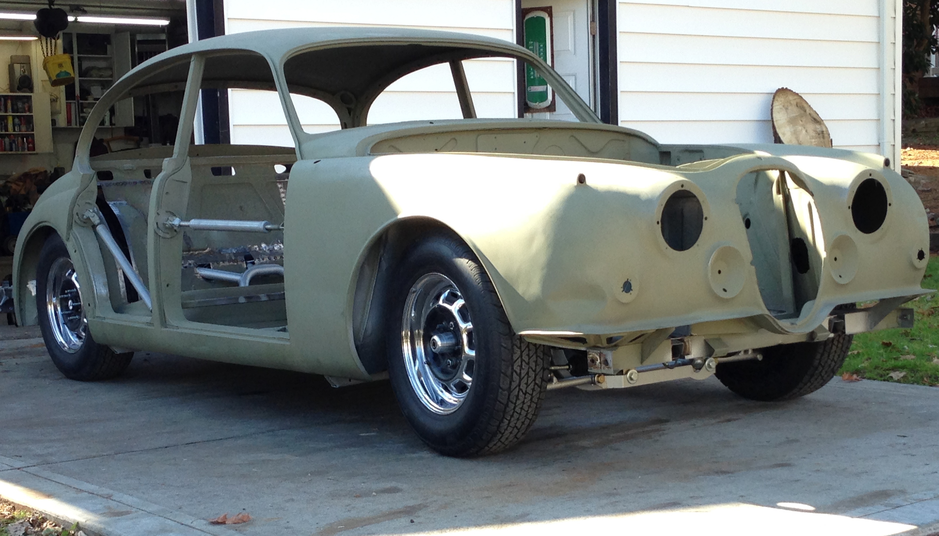

Default Ride height
Evoking,
I'll speak to my build and also recommend you look at Doug & Primaz' threads. (Thanks Tilly Jon)
Stock ride height is 7" measured from the bottom of the rocker panels. My build with the frame change and new tire size will net a ride height of 7.5". I lost ground clearance with the new frame. My options to lower the car were channel the frame into the floor, or raise the floor. Both sounded like too much work. How little did I know!
My tire sizes will be: Front 245 45 17, and Rear 275 40 17. I added 2.125" to the inside of the rear wheel well. My frame is wider in the front than stock, the wheel well remained unchanged. Doug and Primaz are the tire size expert on tires that fit in the stock wheel wells. I studied their treads long before in headed off in a different direction.
Find a dry and rust free car as possible. They are worth their weight in gold.
I've included a shot of my car with 215 70 15 tires off of the XJ12L. These tires are 1" taller that the ones mentioned above. Car is not level, no coil overs installed, only held in position with straight bars instead of the coil overs.
For me the MK2's have a wow factor. Not many around and very cool lines.

First of a V8 restomod Jaguar is an awesome driving car. Lickahotskillet and Doug I am sure can agree. My Jaguar is a very reliable daily driven car that gets a huge amount of thumbs up, positive comments/& headturns yet will smoke most stock cars with the horsepower.
The bad news is as lickahotskillet pointed out perfectly this is NOT a cheap build nor a walk in the park. The difficulty is that the V8 is a tight fit requiring a lot of minor yet time consuming mods to make everything work and fit. Then add the fact that there are no kits or parts made to do the swap so most if trial and error, etc. For added difficulty many Jag owners frown upon us restomod people which is why I left a popular forum site to only post here as at least this site does not allow the badgering and negativity other sites let occur. Other sites call our cars "lumps" and are very derogatory and thus you then have very few people to turn to for help. At least here there are some good people to give you good honest helpful information.
As far as lowering, my car is an Stype 1963 with the four wheel independent suspension. I ran QA1 coil overs all around and right now the car is close to what I want. I am commissioning a custom front drop spindle which will provide a more ideal geometry and stance for the front. I am running 17" x 8.5" custom CCW rims with 245 wide 40 series tires with no body mods. For more info check out my post "3.8S sleeper"
https://www.jaguarforums.com/forum/m...st-done-73952/
The Callam picture you posted is no lie a car that will sell for $350K to $500K but that is the creator of the Jag MKII so he is making a limited run of 12 or so. That car has a unique custom rear suspension with outboard brakes and I believe is independent rear as well.
For budget you should buy one already done if possible as others are right, it will be significantly less money. A V8 create engine/tranny will set you back anywhere from $6000 to $20,000 depending on your choice of quality and power,etc. This is not a simple drop the V8 in swap so if you have to pay a shop and even if you found a very fair inexpensive shop I would say to do the entire car you could easily spend $50-60K I think a good value would be budgeting - $7500 engine, $15K engine labor, wood $3000, wheels/tires $4K, paint $7500, brakes/suspension $9K, interior $7500 and that would be about $47K
Now look at my posting, Doug's, and Lickaskillet and ask yourself can you do that kind of work yourself? If so maybe you save about $15 to 20K if you are able to a lot yourself but not much more as the rest are parts or too specialized for any DIY.
Thus you will spend say $27-30K if you are skilled like Doug or Lickaskillet otherwise plan on around $47-50K

Evoking, sorry you are incorrect. My car is bone stock body. There are no flares or wheel arch's added. The Jaguar 3.8s came stock where the rear fenders cover about 1/4 to 1/3 of the wheels. I like that stock look and when you stuff a wide wheel that eliminates any inner fender well gaps, it looks cool and I've gotten many positive comments on how the rear fenders are filled with the tire/rim.
