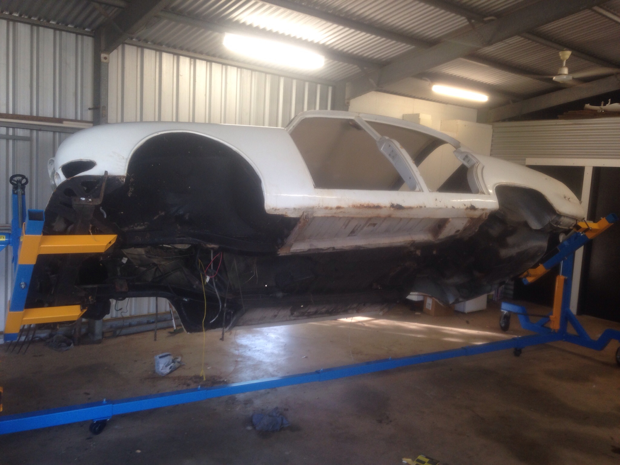

My car has had panel damage bogged over. The creases are to tight I think to straighten and not a lot of s type wrecks in Darwin Australia. Looking at my options ie costs to see if I can replace panels. Only need front of LH fender ans sills. The rest I can cut and paste.

Picures of damaged panels would help. There are many "panel beaters", "metal shapers" in
Australia that could be of some help possible, see All MetalShaping - Powered by vBulletin
