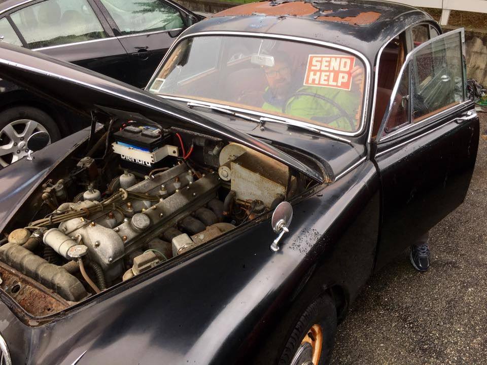

I have a 1960 steel sunroof 3.8 mk2. Numbers match the heritage certificate.

Here is a picture from the day I picked it up a few years back

Man !!!
You have to love those copper coloured wheels and that home made battery bracket....
Die Hard on the battery fits this situation !
