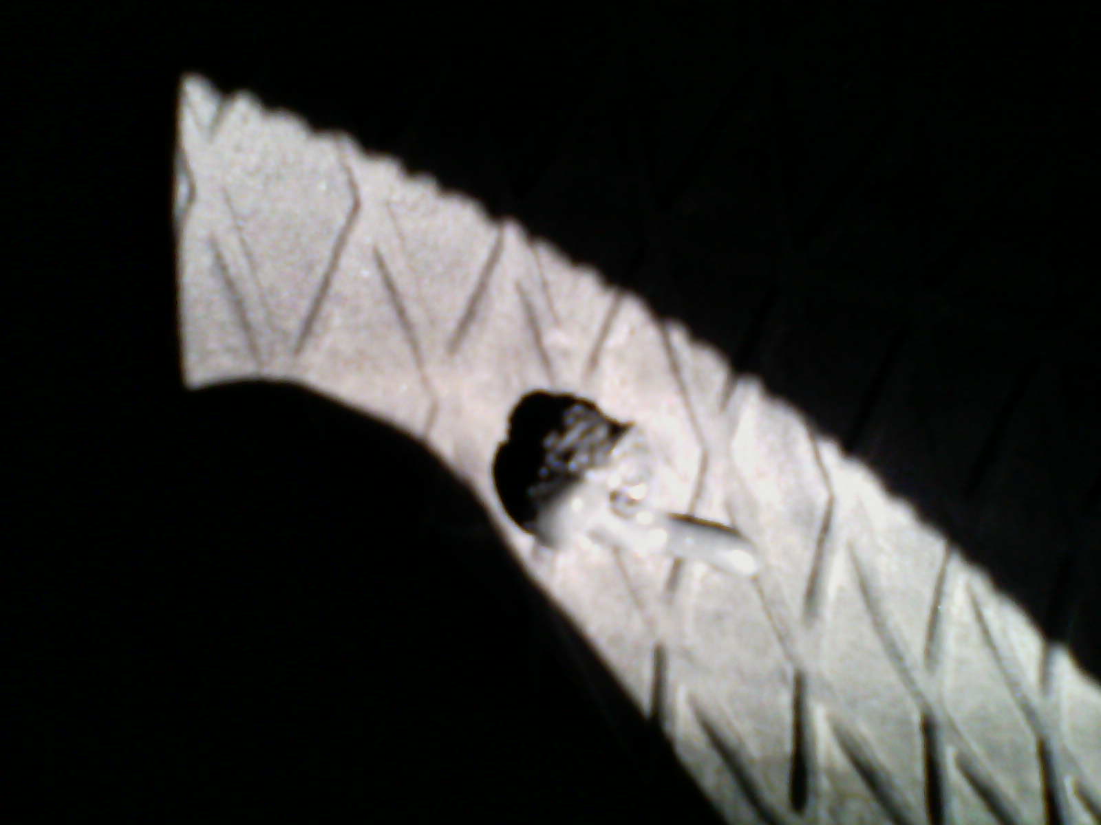

The experiment has ended, somewhat.
The tire was replaced this morning ($80 ).
During the entire time after the Slime plug was inserted with gray JB Weld, dried overnight, and then re-inflated, the tire always held air.
Here's what that plug looks like from within the tire. ( Pics )
Note tht the plug is upright and firmed.
The JB Weld covered and held.
Note the interior of the tire is clean.
