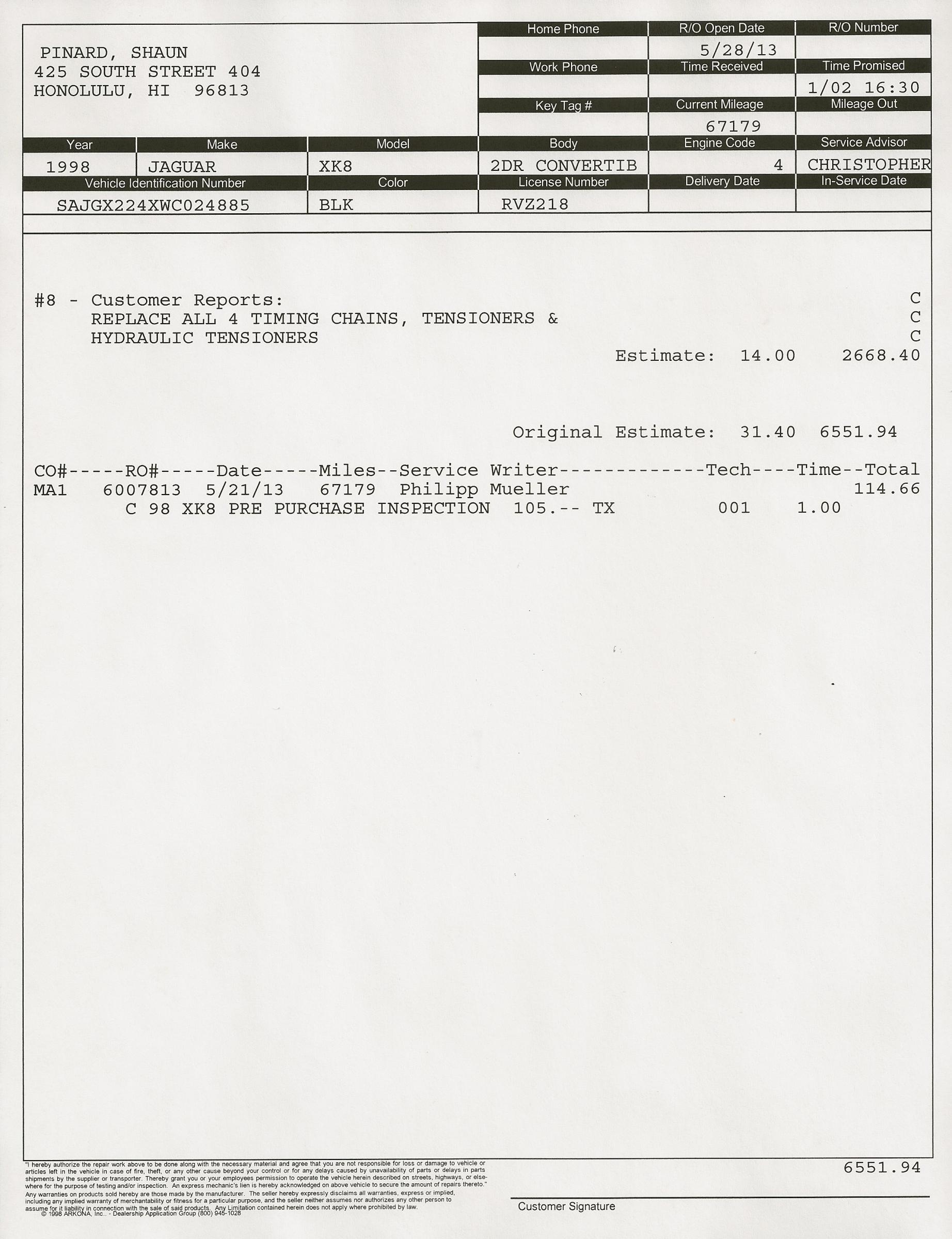

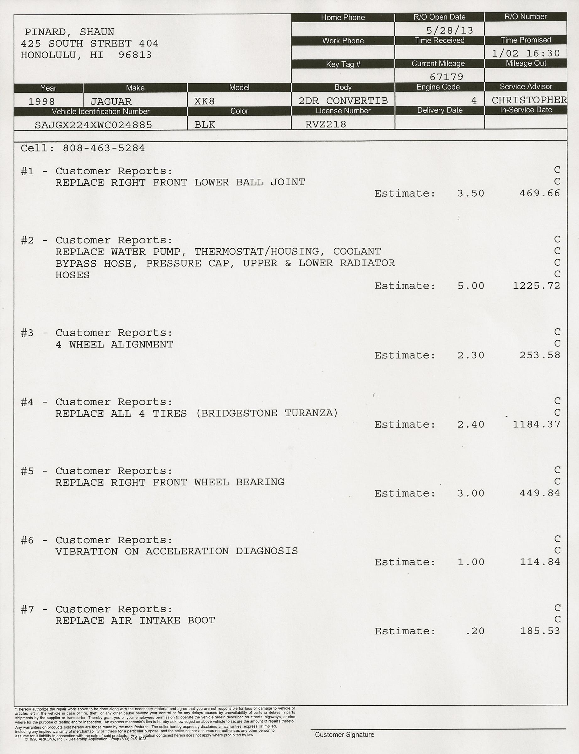

My 1998 XK8 Convertible (67,000 miles) and I met in Maui just a few days ago and now she has moved in with me. So far everything works. The mechanic who did the pre-purchase inspection recommends the following preventative maintenance (see attached).
I agree that the tires need replacing and I think that the two biggest risks to the engine are probably overheating and the secondary tensioners but am not clear whether the primary tensioners and chains need replacing as well (at $105 per hour, I have received an estimate of $500 just to remove and re-seal the two valve covers to see if it still has the original red tensioners). I'm not a mechanic and would love it if someone would look at the attached recommendations and let me know what does/does not make sense.

You've clearly done your research and identified tensioners and cooling system as the two main issues on the early V8. Do you intend to do any maintenance yourself?
Unless there are receipts and service history to indicate otherwise, upper tensioners will still be the original plastic type and are a ticking bomb. Rectification does not automatically require replacement of all tensioners and chains but there is always the possibility of wear being found on dismantling. Not replacing worn parts would be false economy.
The plastic impeller blades on early water pumps can break up and thermostats do stick. Again, it's not essential to throw everything away and replace perfectly satisfactory parts. If the Thermostat Tower is leaking, then an aftermarket aluminium one is a preferable replacement to having another OE plastic Tower.
With both the worn balljoint and wheel bearing, they should easily be able to demonstrate the wear / play for you. Unevenly scrubbed tyres is a good pointer that something is wrong.
Overall, there is nothing unexpected on the list although they may be being a little too enthusiastic with the new parts!

Welcome to this friendly Forum, since when did one have to pay time for a tyre change ?
Some of the work (#2 for example) is easy DIY and now's a good time to start - you'll get all the help you need here.
