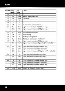

Goodday. I have been searching for a engine compartment fuse box diagram xf 2013 but couldnt find it on the web. Can someone refer me to where I could find such information. Thanks

Welcome to the forum David,
This information is in the Owner's Handbook. You can download this from the Jaguar website.
Follow this link https://www.jaguarforums.com/forum/xf-xfr-x250-44/ to the X250 forum for help, advice and information
You can also visit the Other Areas Region forum by following this link https://www.jaguarforums.com/forum/other-areas-43/
Enjoy the forums.
Attached Thumbnails Engine compartment fuse box diagram xf 2013-fuse-1.jpg   Engine compartment fuse box diagram xf 2013-fuse-2.jpg

Graham has nailed that nicely.
