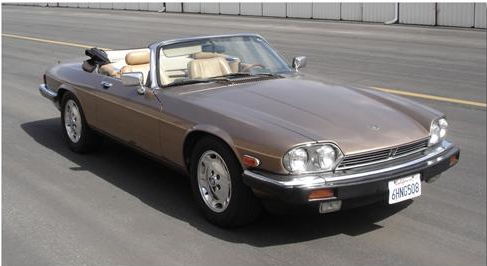

Hey everyone, just bought my first Jaguar today! Got a 1990 XJ-S convertible with a 115k miles on it. Previous owner dropped a new transmission in it 2 years ago and new engine 3 years ago. He was pretty meticulous in the mechanical aspects of the car from he told me. However, I'm now experiencing some of the cosmetic/electrical/other things he didn't get around to. I'll save my list of issues for another post...just wanted to introduce myself and say how awesome it was to drive the car home today after purchasing it, then driving down the freeway in Los Angeles. Plenty of heads turned and stared...very cool!

Congratulations!! I remember my first Jag (a mk1) how old am I ! And how excited I felt..thing is I am just as excited every time I drive the Jag (a bit later model now) But you forgot the most important bit..the COLOUR? What Colour is your top-less car??

Hey Neil, its brown. You can see it in the attached thumbnail. Its 1:25am and read a few hundred pages on the forum already.

I didn't look at your Pic.did I? Beautiful.

Brown? I am sure Jaguar gave the brown a more prestige name than "It's Brown" By the way how did you get a picture of it all alone in the middle of a "freeway"? Awesome shot.Love it. (6.00pm -06-05-'12)

that's actually a pic of the car on an airport tarmac. The former owner was a pilot. Actually more gold than brown..ha!
