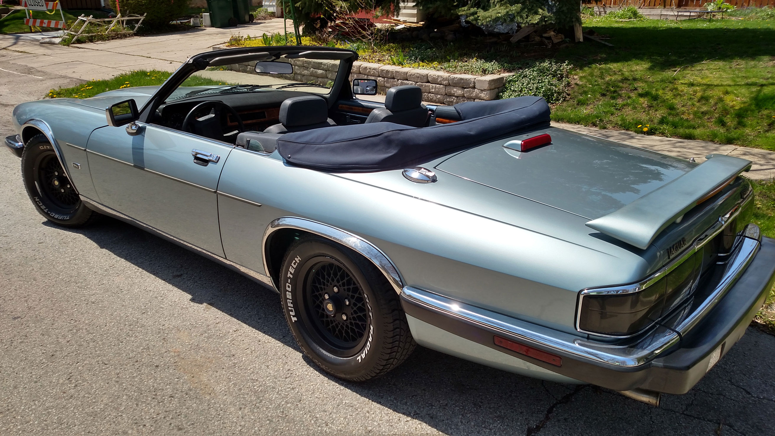

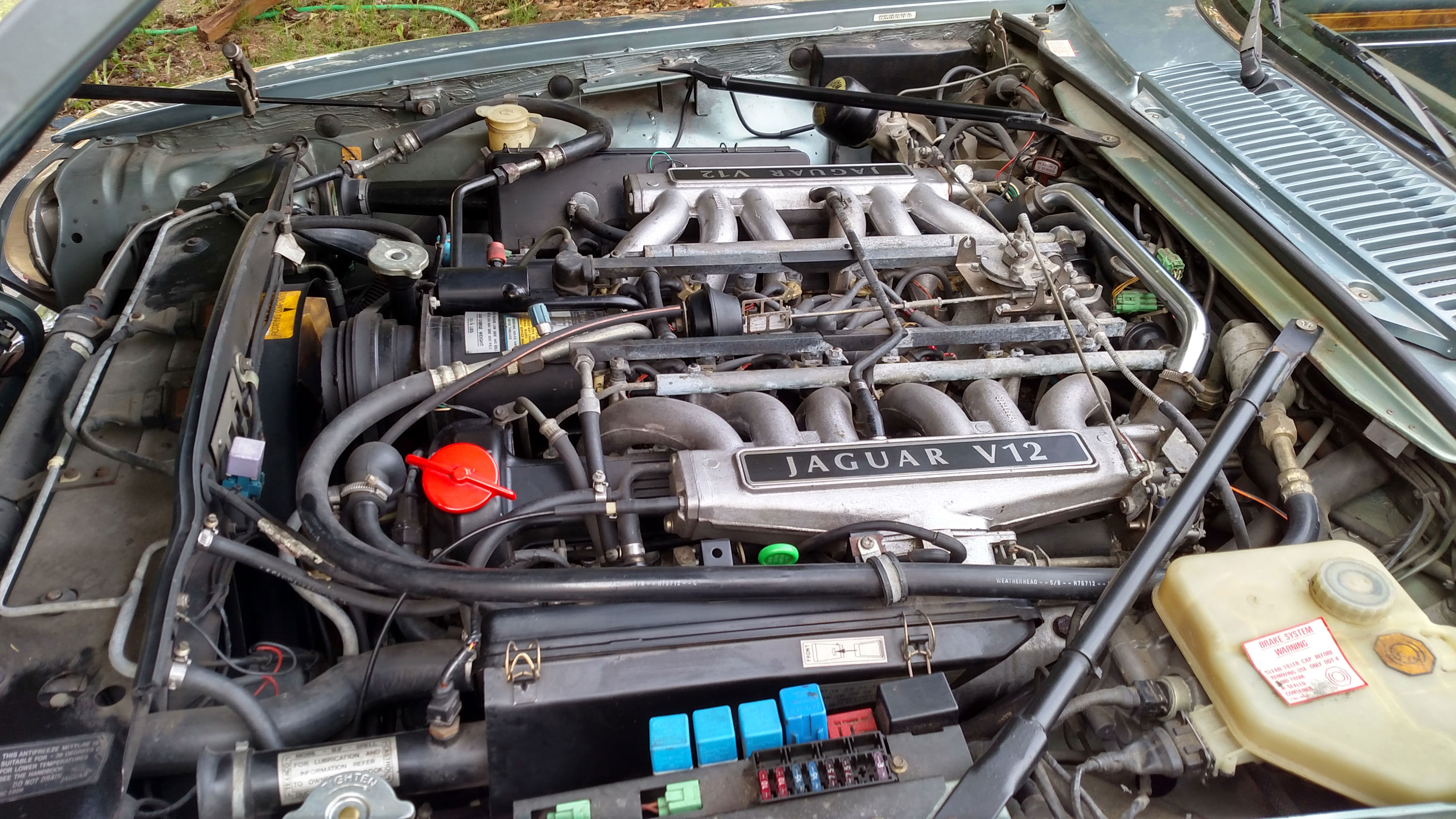

Hi,
I was recently searching for a Cadillac Allante when I came across the Jaguar XJS. The Jaguar has never been on my radar, partly because of "reliability" issues. I am used to dealing with the common electrical gremlins and leaky spots my Cadillacs have left, so my expectations for the XJS are hopefully grounded. I have noticed, However, That most people who have commented un the unreliability of the XJS appear to be individuals whom have never owned a Jaguar.
Despite the issues this car has I have fallen in love with it. I don't know if all the extra chrome is original to the car, but it really works well with the color. The bottom of the car has been undercoated and is quite immaculate.
The car needs a new top, and it has a couple tiny leaks that appear on the concrete after being parked for a weak. It is giving me a fuel fault 14 code and i have replaces the coolant temperature sensor, but have yet to eliminate the code. New thermostats on the way, so after I complete my coolant flush, hopefully the code will vanish.

Hello, Paul,
Niiice Caar!! In fact, that one is the only XJS I would consider owning; especially the convertible part, but also those tail lights! But I would prefer Black. Of Red.
The guys in our XJS section will positively Drool when you post over there! Sakes!! I don't even live there and I'm drooling!

Welcome.
Being a 1992, and Elinor's tail lights, it would be a 6ltr V12.
NOT an oil leaker in any way compared to the sister 5,3ltr.
I have ALWAYS stated the lack of reliability of any Jag is directly related to "The nut behind the wheel", who does not take care of any car, and the Jag gets blamed for it all.
ALL my V12's have been daily drivers, and do heaps of miles every year, and never ever break down.
The marking of territory is real, and probably coming from the transmission selector shaft seal.

6.0? Now I am confused. I have been working under the notion that it was the 5.3. I need to do more research.

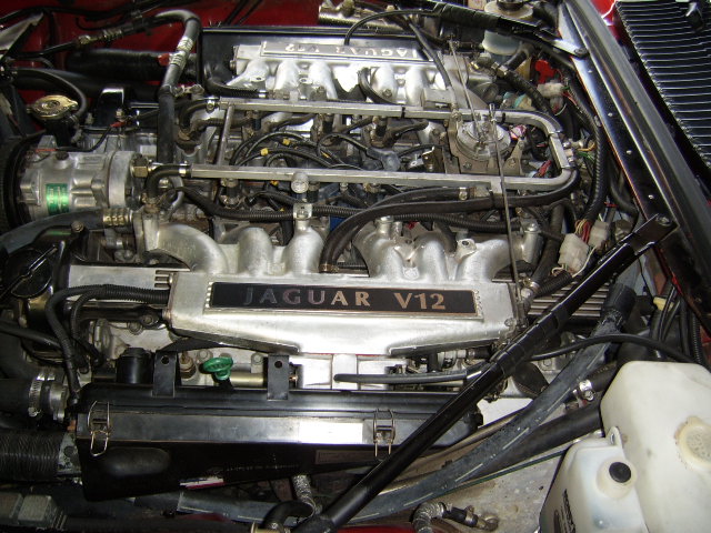

Mmmmm, the good old USA market got things differently to the rest of us.
6ltr has a 4 speed auto
5.3ltr has a 3 speed auto.
6ltr has an engine cover over the V, and Jaguar V12 plaques on the inlet manifolds.
5.3ltr has NO covers, and may or may not have those name plaques.
Here is a snap of my 5.3ltr.
