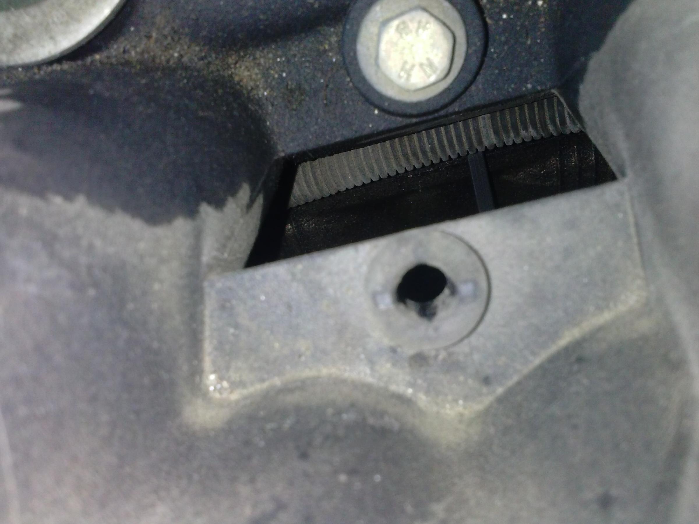

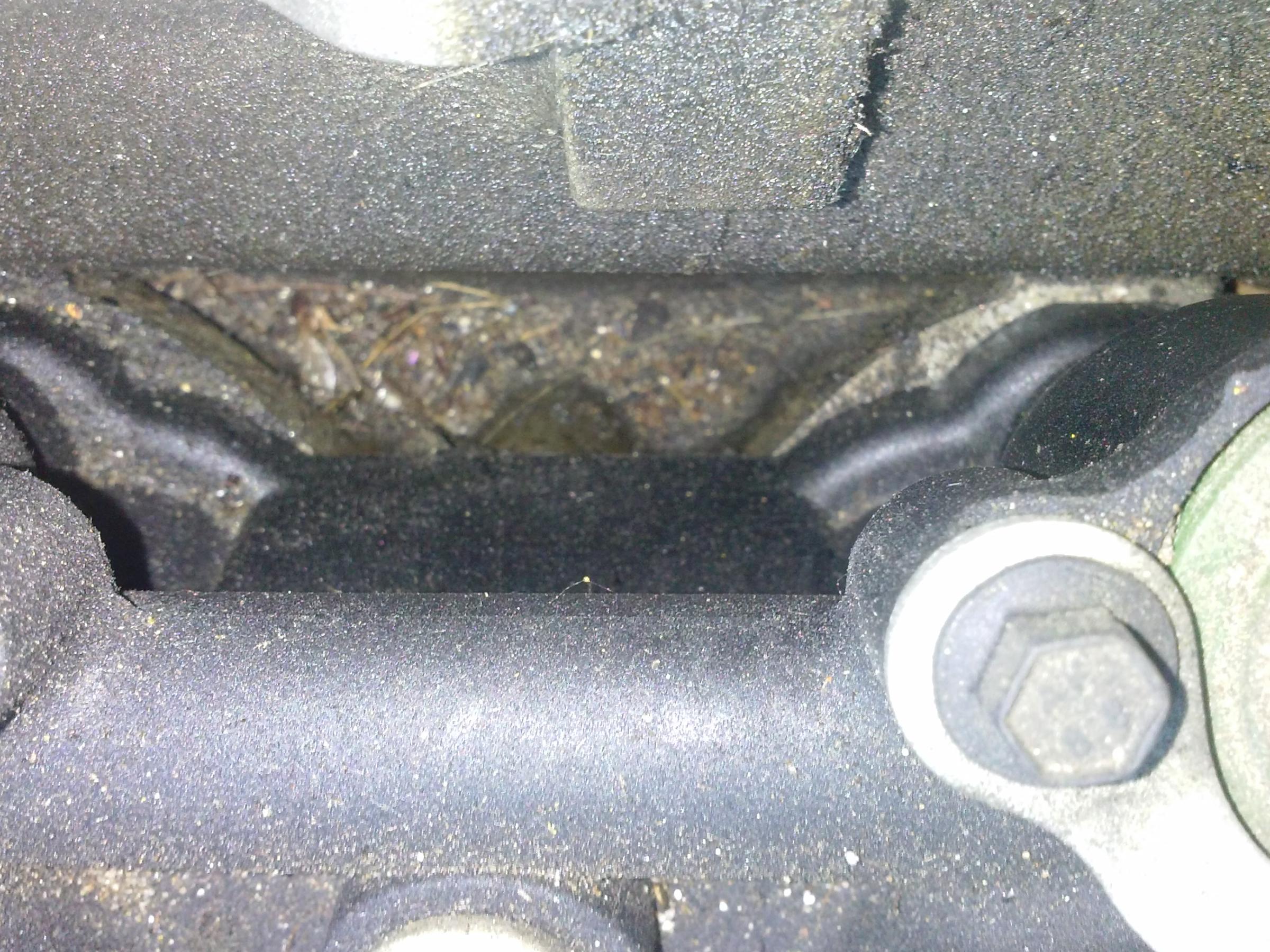

first of all, thank you all very much! Ill start with the V6 2000 S-type. It is 40 degrees right now so it is hard for me to dig too deep into the motor. I replaced one vacuum hose and the difference is night and day. When it gets warmer I will replace the rest of them. I bought a 3/8 plastic joint, 3/8s hose, and clamps. all for around 10$ at autozone. posting pictures of the hose that was my problem.

Richard WTG on the 3.0. All the vacuum lines should be replaced, as you now know they get brittle and crack over time and are a common problem reported here.
Use one of the forum sponsors here to purchase replacements most offer discounts to the members. You'll be looking somewhere under $200.00 for all the vacuum lines and less than a half day replacement.
