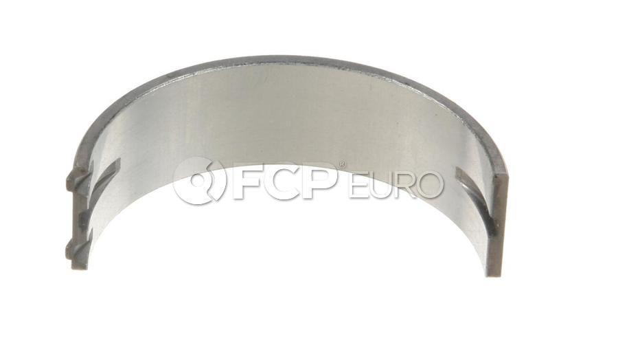

Originally Posted by kansanbrit
can anyone explain this to me?
Bearing shells have tapered projections that hold them in place against the direction of engine rotation...
Thanks but I don't think that is the reason, most engine shells have those. The AJ133 5.0 doesn't actually but should still not be rotated backwards. Personally I believe it is because the timing chain may skip if turned backwards because the tensioners go slack.

Kansanbrit: Your reason sounds good to me...
