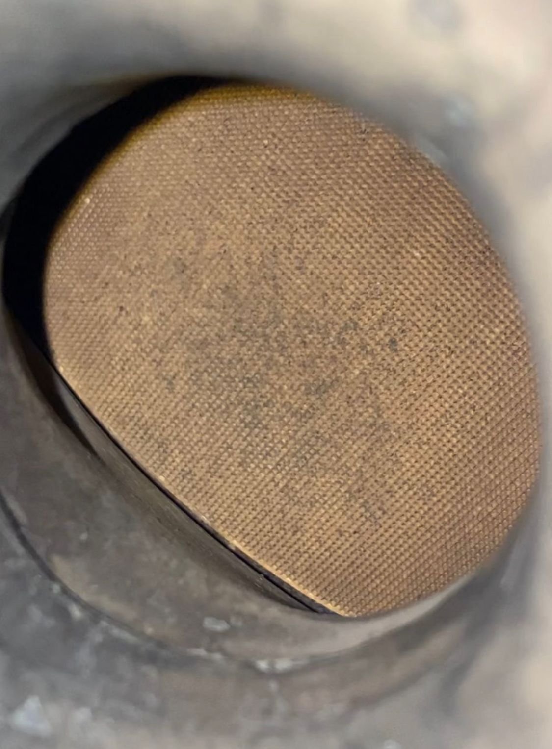

Old Jun 28, 2022 | 05:15 AM
elDariusVargas's Avatar
Joined: Sep 2021
Posts: 299
Likes: 40
From: Cluj-Napoca
My catalysts
Old Jun 28, 2022 | 07:25 AM
JagV8's Avatar
Posts: 27,517
Likes: 4,906
From: Yorkshire, England
It sounds good enough.
