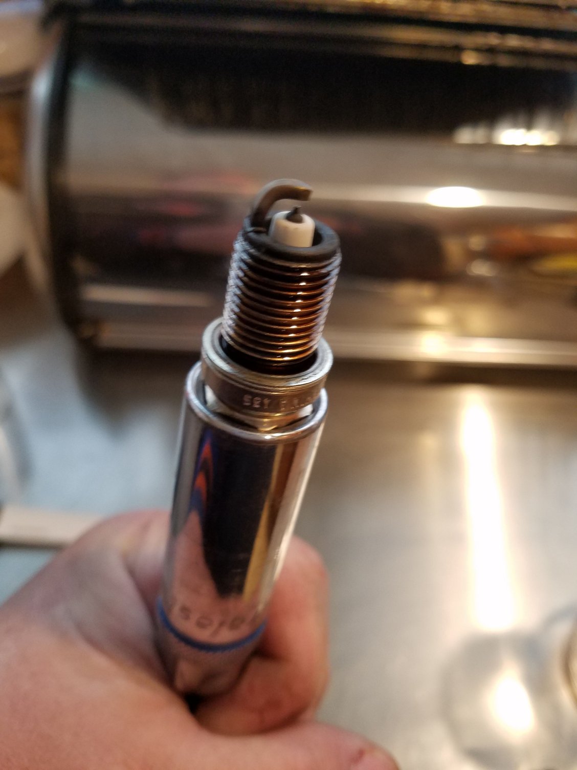

As I said, I'd already replaced the coils on cylinders 1 & 4. Pulled the plugs (which looked OK) and replaced them too, just to be sure. No improvement.
No idea where to go now (and with the closest Jaguar dealer over 20 miles away, it'd need towed if it's something I can't remedy myself). Battery is supposedly "new" and seems to be holding a charge well. Was running perfectly for 3 weeks, and then overnight, blam...
Here's one of the plugs I'd pulled, the other looks the same:

Anyway, swapped in another new coil I had on hand, and one of the plugs I pulled on Sunday. Seemed to be idling smoothly. Revved it, let it settle back down, and it wasn't misfiring like it was all weekend. Cleared the fault codes, let it sit running for 15 minutes, nothing when I came back except a P1000, which should go away once all the drive cycles finish. Still haven't taken it out for a road test (I'd rather do that during daylight in case there are any issues), but it seems to be a vast improvement.
Not sure if I should feel relieved or stupid, I was practically pulling my hair out all weekend trying to figure out what else could be the problem. Now, of course, I'm hoping that it's not just another temporary fix for an underlying issue that will return later. Think I'll finish swapping out the plugs on the other cylinders tomorrow, the ones I've checked don't look bad, but there's no telling how long they've been in there. They're Bosch platinum, so I don't think they're the originals, but at 124,000, I've no idea how long ago they were changed. I'll post an update once I get a chance to take it out on the road...
