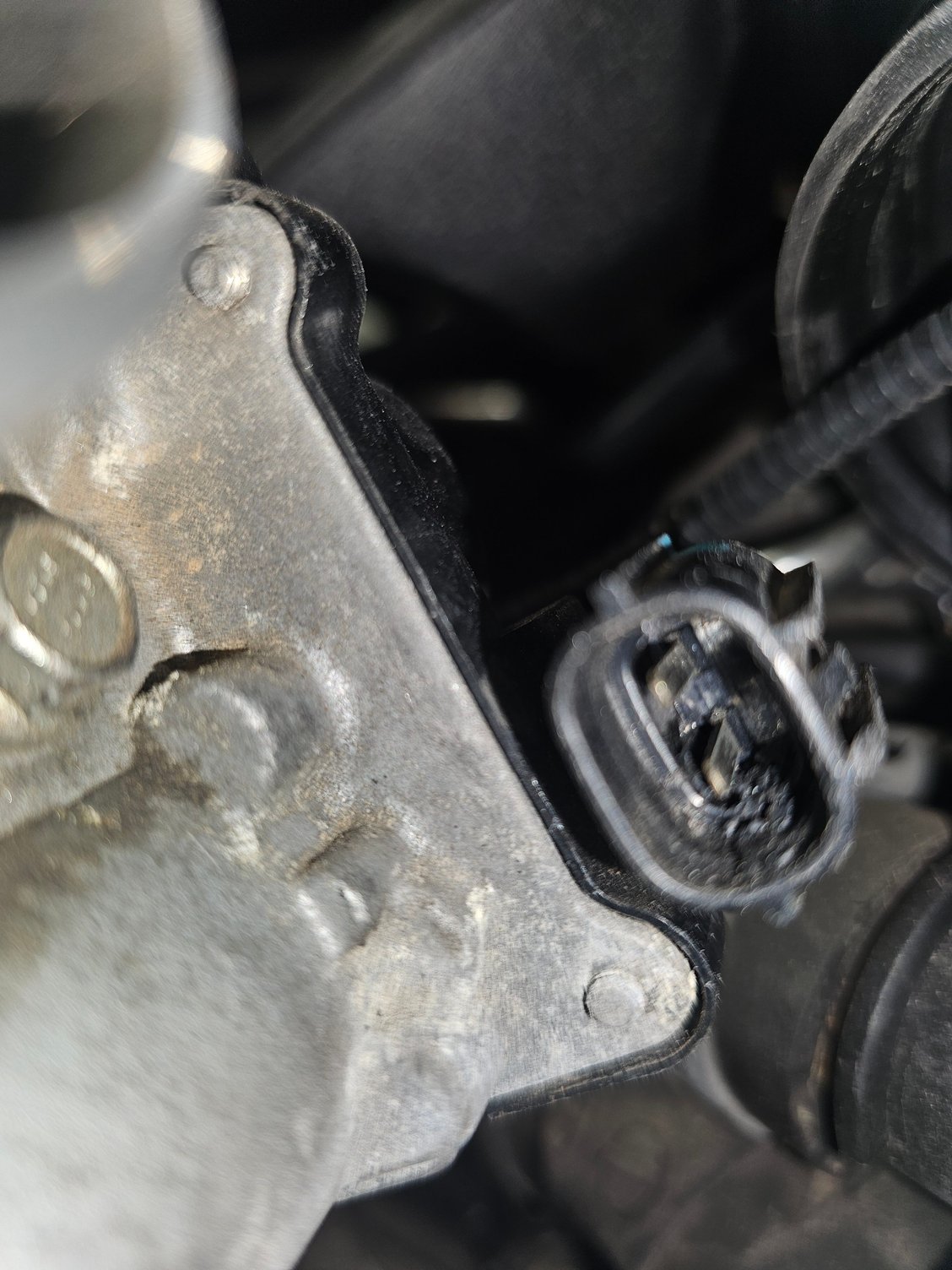

My two pin connector on the right side of the throttle
body connected to the throttle motor finally imploded in my hand when i tried to remove it. The wires are exposed. I can still connect them but I can't find a connector pig tail to replace it. I have also checked the Lincoln LS 3.0l website but can't find one. Any ideas on a after market replacement?

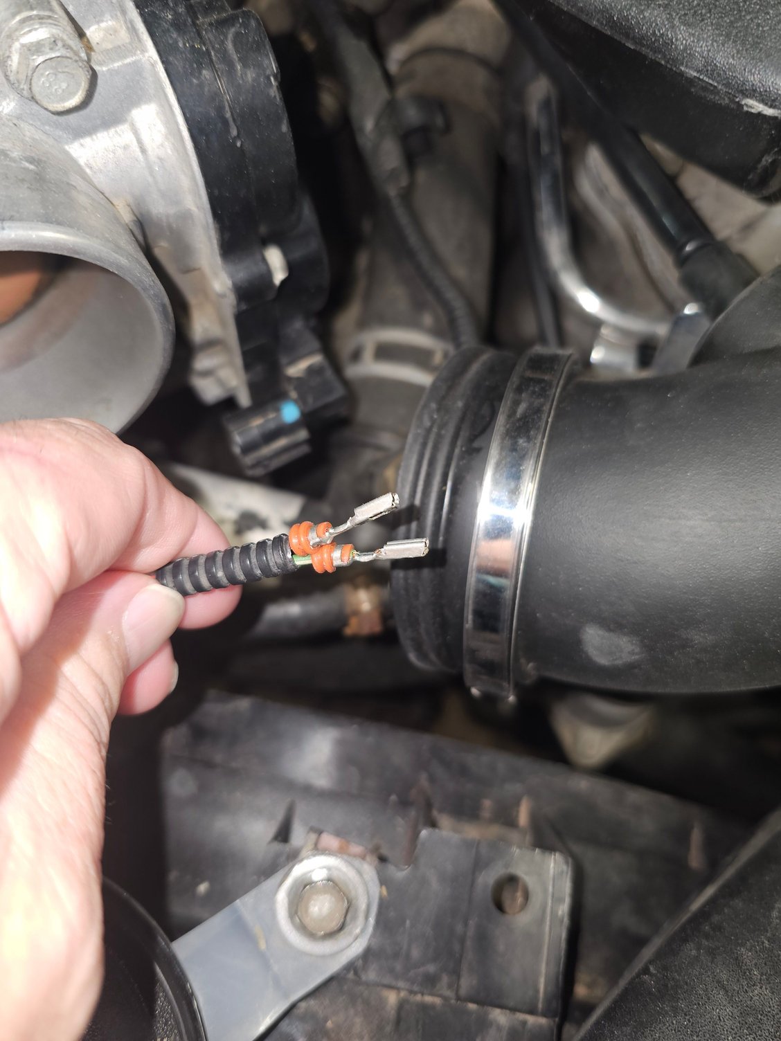

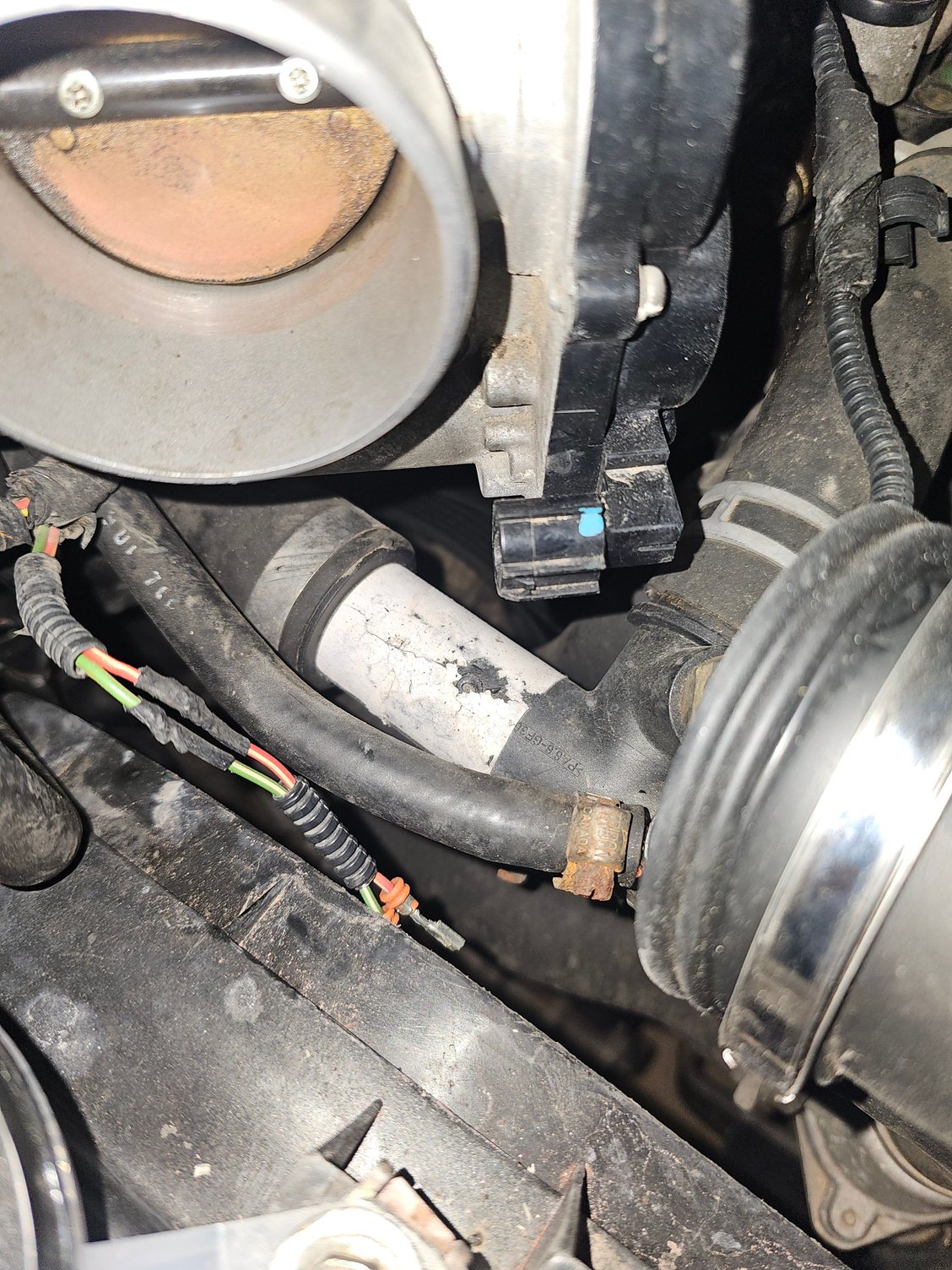

As a follow up...I was able to remove the wiring and clip. I used the original wiring with no issues.
