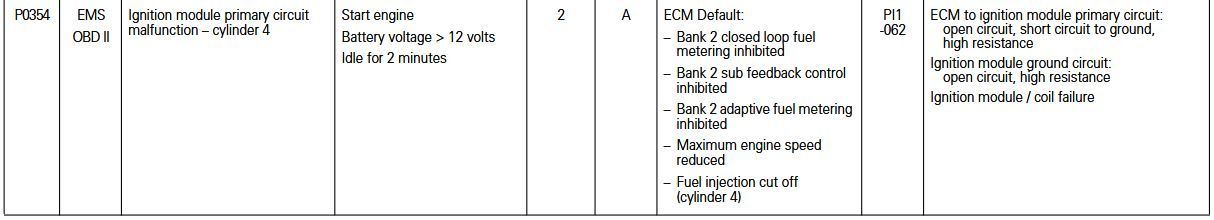

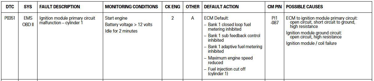

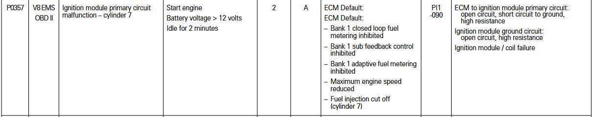

Here are published definitions and possible causes from the 2003 DTC Summaries manual:
When I see codes like these that affect both engine banks but share the same possible causes, I think one of those possible causes is probably the culprit. In this case, for example, perhaps there is a problem with the ECM to ignition module primary or ground circuit for all cylinders, but that the ECM is only triggering DTCs for three cylinders for which it is, perhaps, most sensitive.
It is also possible that the coil wiring harness is damaged, affecting only these three cylinders.
You can easily measure the supply voltage to the ignition coils on the Red wires with White tracer stripes. They should all have the same supply voltage with the engine running.
The coil power supply ground wires are Black and should have low resistance between any coil connector and a good body ground and should not be shorted to any of the coil Red/White wires.
The trigger side of the coil circuit would be most easily tested with an oscilloscope to view the voltage waveforms as the ECM grounds each coil to fire it, but testing this side of the coil circuit is dangerous since ECM damage could result from even a minor mistake.
You can also inspect the ignition coil wiring harness. Often the most vulnerable point is where the harnesses bend at the rear of the engine and where the coil harnesses wye into the main harness.
Another possible cause of these kinds of codes would be water ingress in the ECM electrical connection and corrosion on the connector pins.
