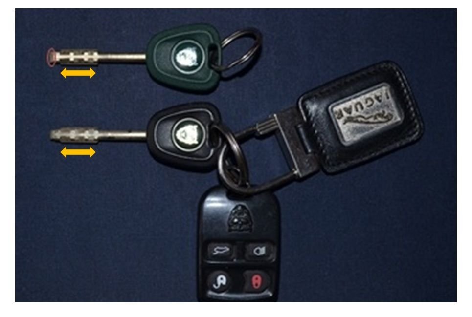

Originally Posted by raymo
2006 s type trunk wont open, I have 2 keys but none of them turn in the key hole?????
Perhaps you have two valet keys? They are cut slightly different so they won't open the trunk or glovebox. They only work the door and the ignition.
I think the difference is the bevel on the end, but am not positive. Anybody know for sure?
If the trunk won't open with the remote or the dash switch, check the valet button in the glovebox. If accidentally depressed (easy to do), it inhibits the electric release.

The regular key has a smaller bevel on the end.

Right on about the valet key..i took one of mine and filed it smaller to work the trunk....that is my daughters key..at least if she loses or misplaces it i am not out the way expensive original one
