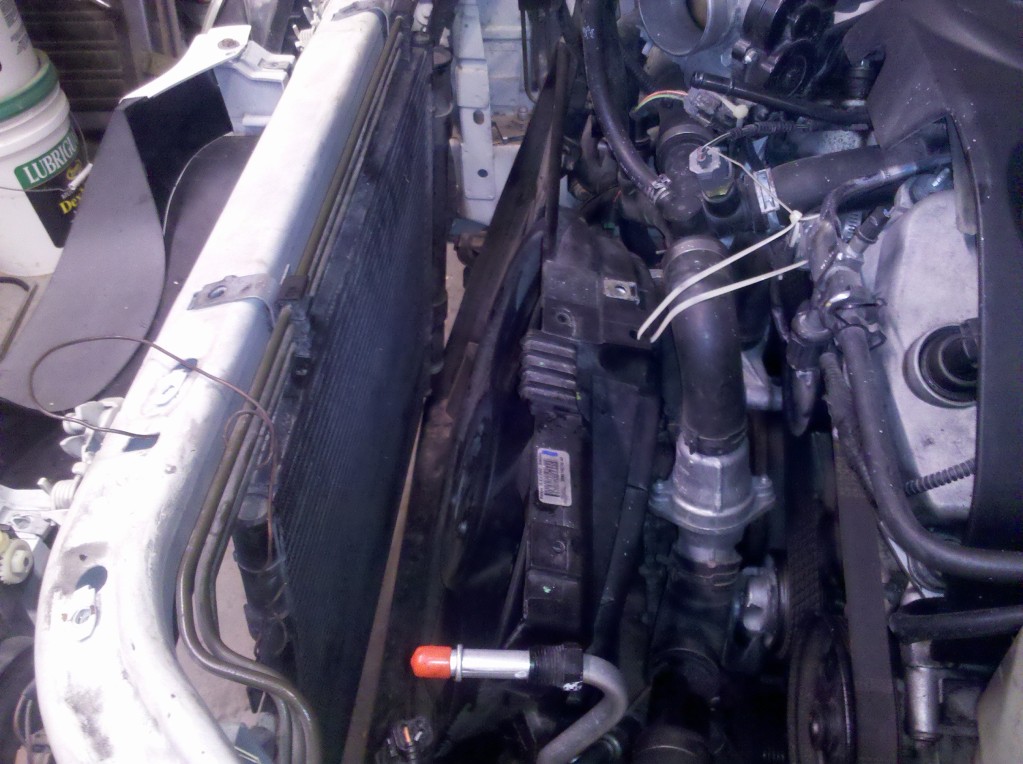

Got the rad separated from the vehicle this evening. Boy...I'd have to say it was a real (bitter ex-wife) in comparison to the Excursion! Lower shroud mounting was actually clips, but the lower condenser mounts attach to tinnerman clips on the rad side tanks. A/C line caused most of the trouble; interference with lwr hose nipple on the back and mounting boss for condenser/pwr strg cooler on the front. Minimal ATF loss.
Front:
Rear:
I removed the foam seals in preparation for taking it to Kirby's - doubtful I'd get them back, think they'll re-stick reasonably well with some 3m spray adhesive. Also pulled the tinnermans off, just in case.
temporary upper condenser supports of baling wire; temp upper fan/shroud mounting is a single zip-tie.
Also used a zip tie for right side of pwr strg cooler:
Dug out the radiator repair bill from the Exc. 'cuz I'm getting aged and couldn't remember where I got it fixed nor by whom and find that "Clean, rod, repair was only $58. $36 more for a plastic tank (cracked) and $2.97 in taxes brought the total to $96.97 and I seem to recall it was a same-day turnaround. So I'm hoping for ~$60 on this one as I don't need any tanks, only new seals and a re-crimp, or so I think.

Zane nice job buddy. How long did it take you to get to this point, 1 or 2 bitter ex-wives?
BTW you taught me something, I did not know that one could get a radiator "resealed and crimped" makes sense though.
Thanks for the pictures.

Hehe...thanks Rick, I don't "know" it either...but will find out in a few hours this morning....owing to the fact that my Exc had two side-tanks, and collision force absorption coupled with inadequate welds on rad-supt during first rebuild caused the lower mounting foot RHS to crack the side ..wait...no! top and bottom tanks on that one...cracked the rt side of the bottom tank...and the shop replaced that....I'm "***"uming they can break loose otherwise functional side-tanks and replace the seals on them......will update later....
Getting from where I thought I was (pop off the xmsn cooler lines and a spare fastener or two) to having it dismounted consumed the entire Rush Limbaugh podcast of 26 Sept - all three hours...but if you get them...you know each hour is only about 33-35 mins due to lack of ads.....only one bitter-ex thus far....DCCV would normally consume another bitter but with radiator out perhaps only rises to the ire of a disgruntled ex-girlfriend...
