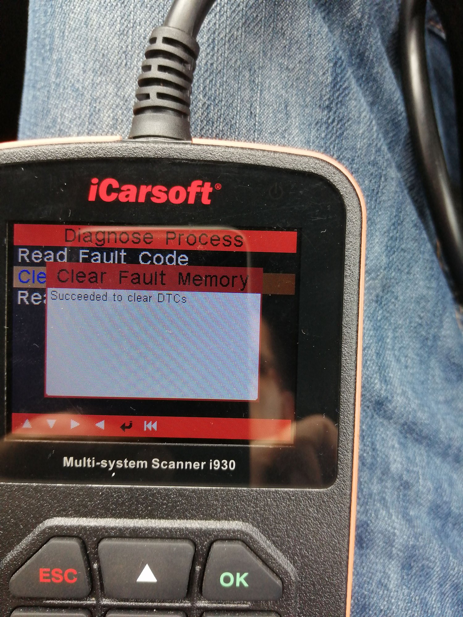

Good afternoon all my S type has the abs and tc lights I have a icarsoft 930i scanner which read a fault to the O/S/R speed sensor I have replaced the sensor 2 times now along with the abs mouldle I have checked the abs loom all connectors are clean still I have the 2 dash warning lights on abs and tc any body had the same fault and knows how to fix the problem without it fixed I am unable to get a new MOT
