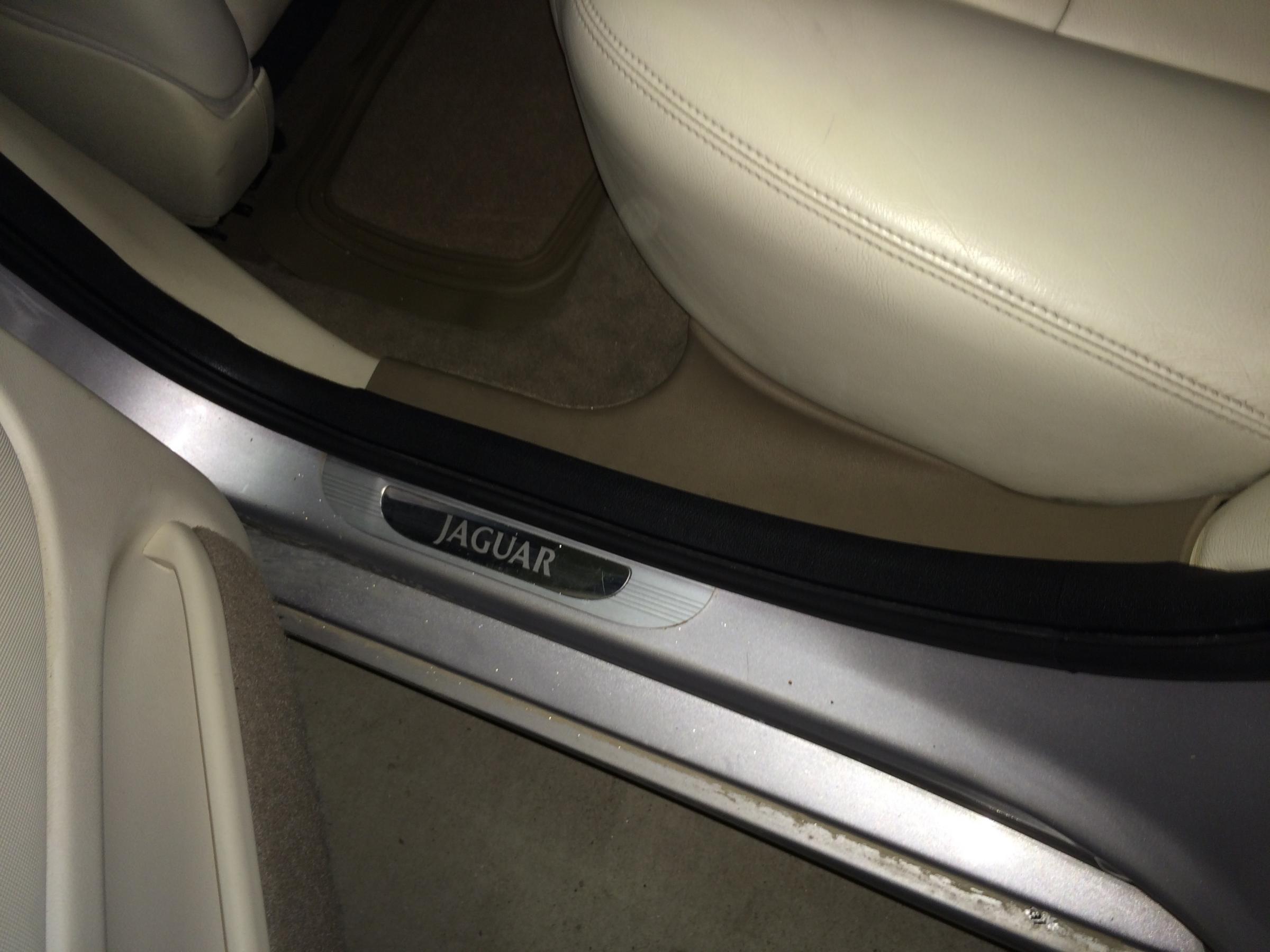

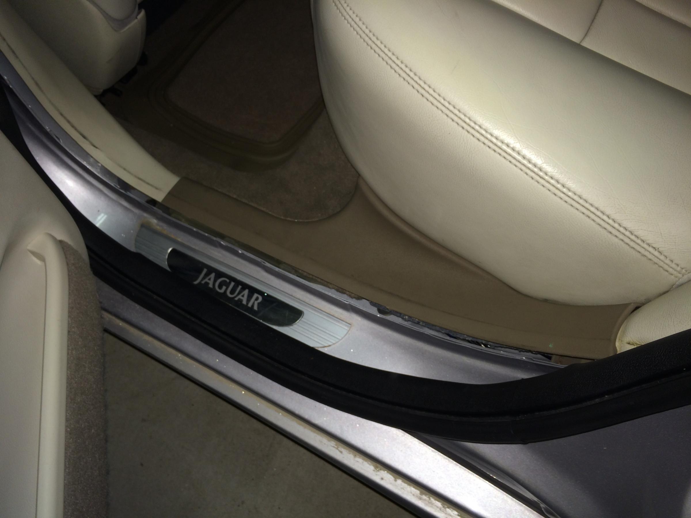

I then removed the threshold cover from the drivers door area to gain access to remove the footwell trim cover and the side pillar trim cover.
You can then remove the weather stripping from the bottom and sides of the door to make removing the trim panels easier. The weather stripping simply pulls off of the metal door frame.

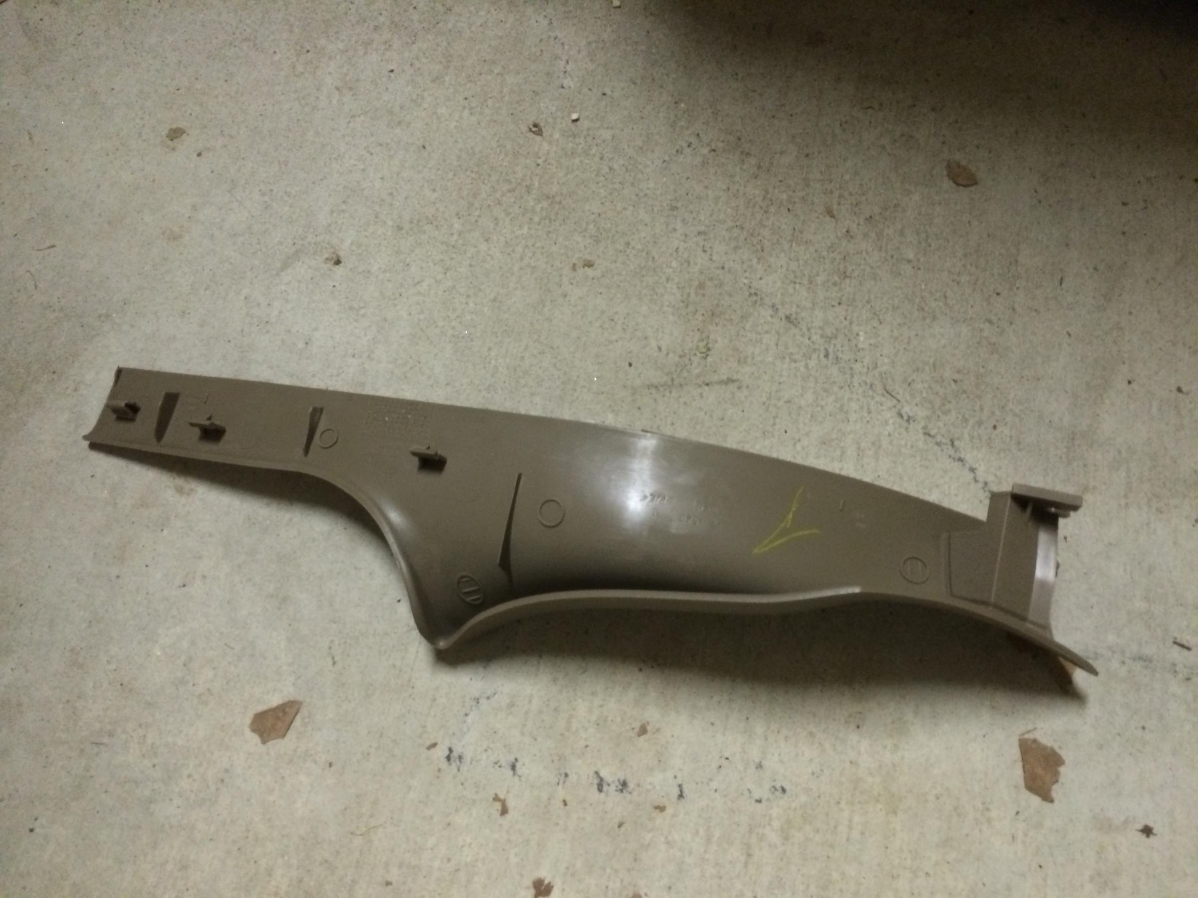

Then you can pull out the footwell trim panel which has two clips on the door frame and it comes off by pulling it back towards the rear of the car.

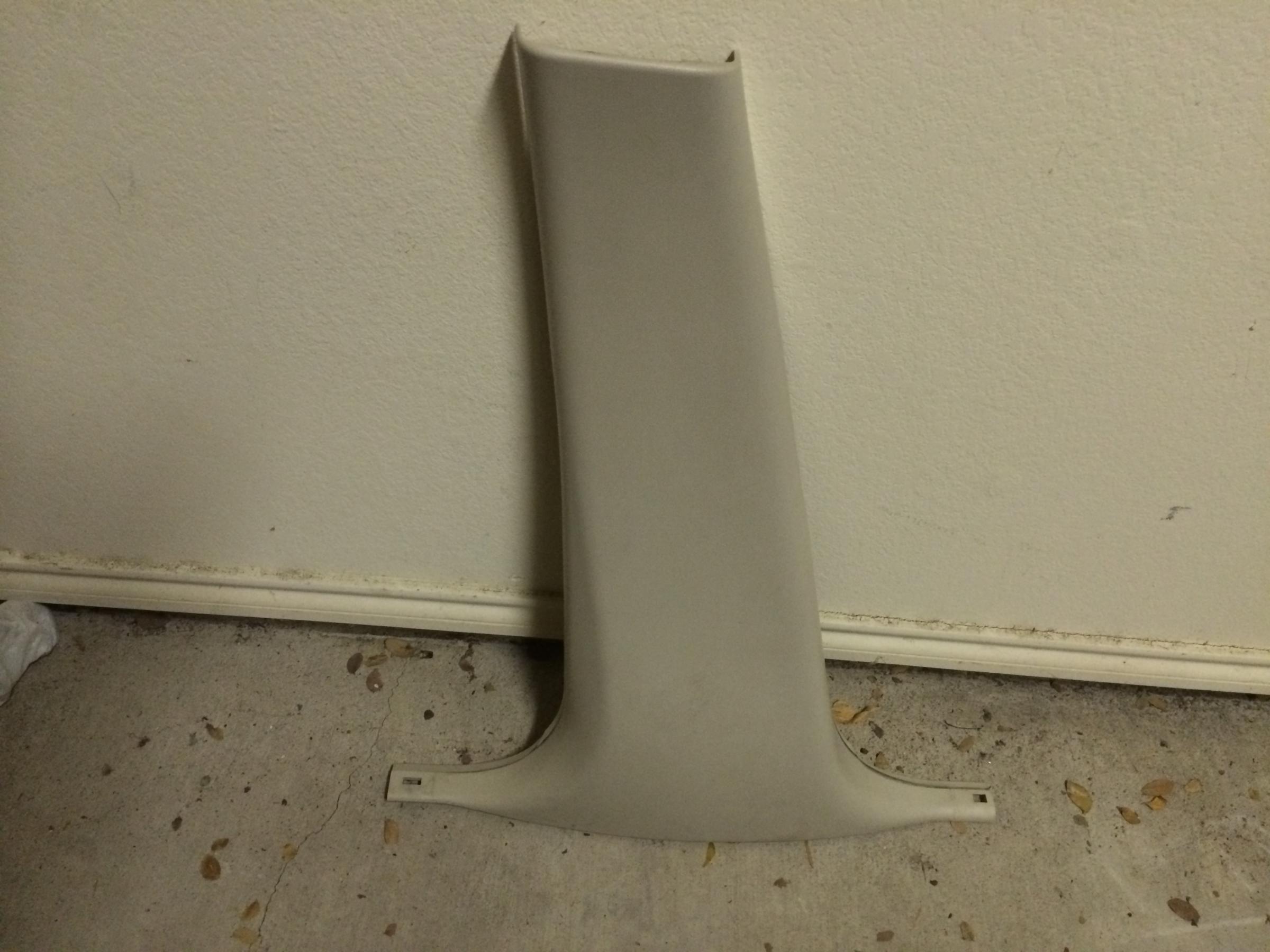

Then the center pillar trim pulls off. There are two clips near the bottom and then two more at the top.

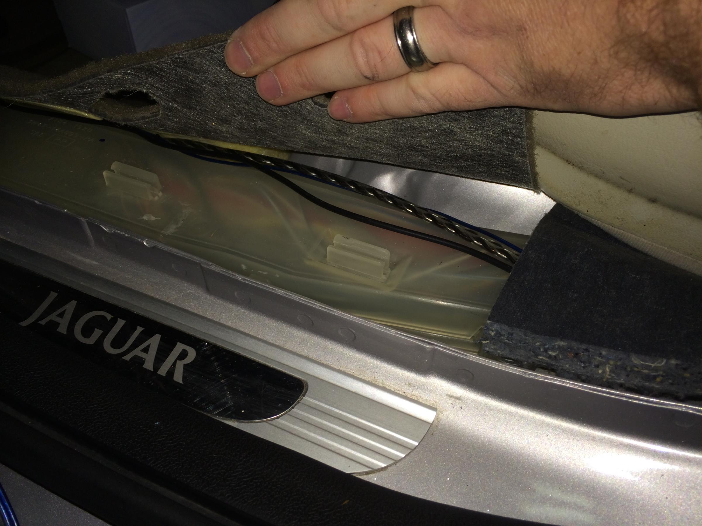

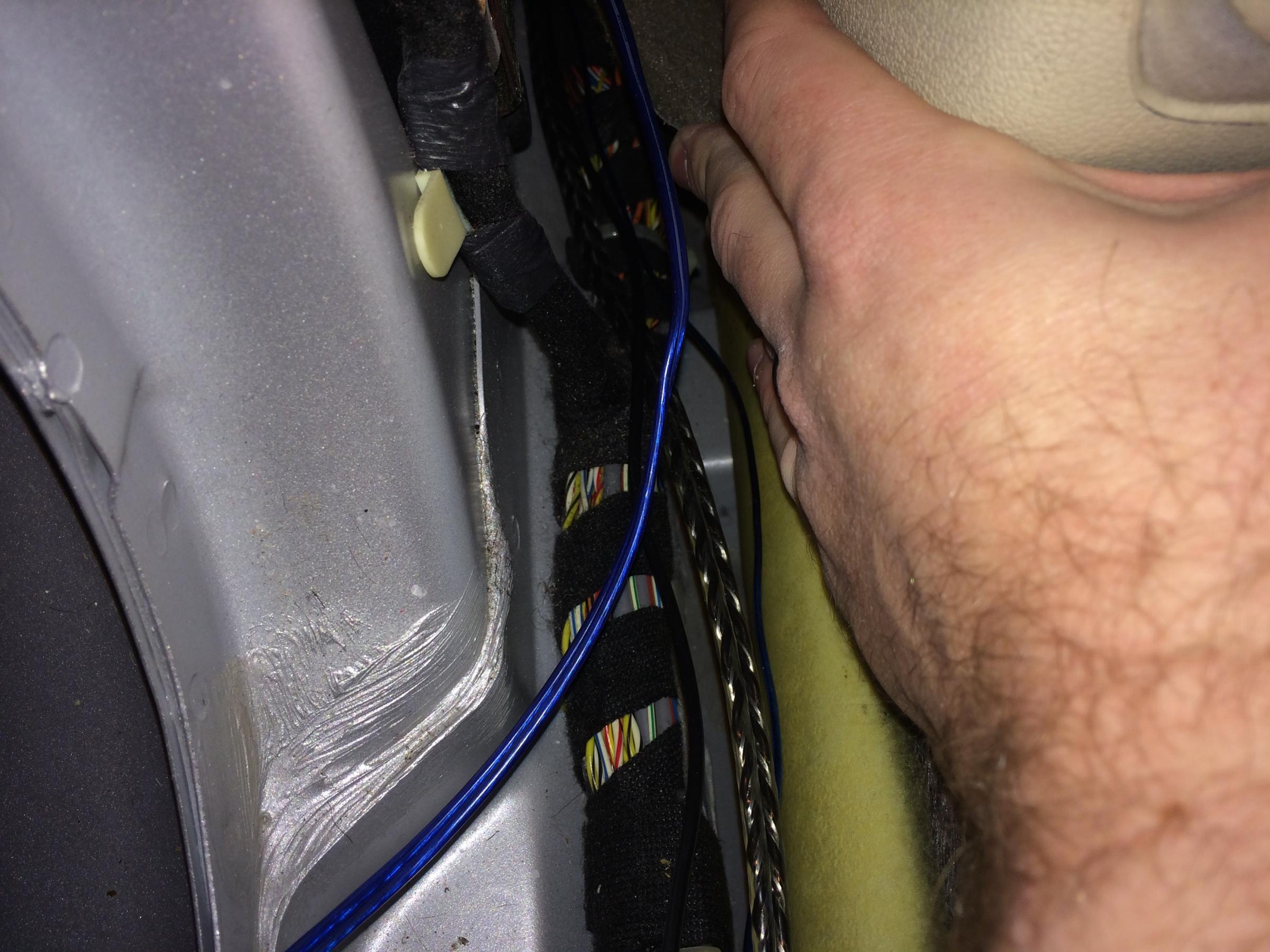

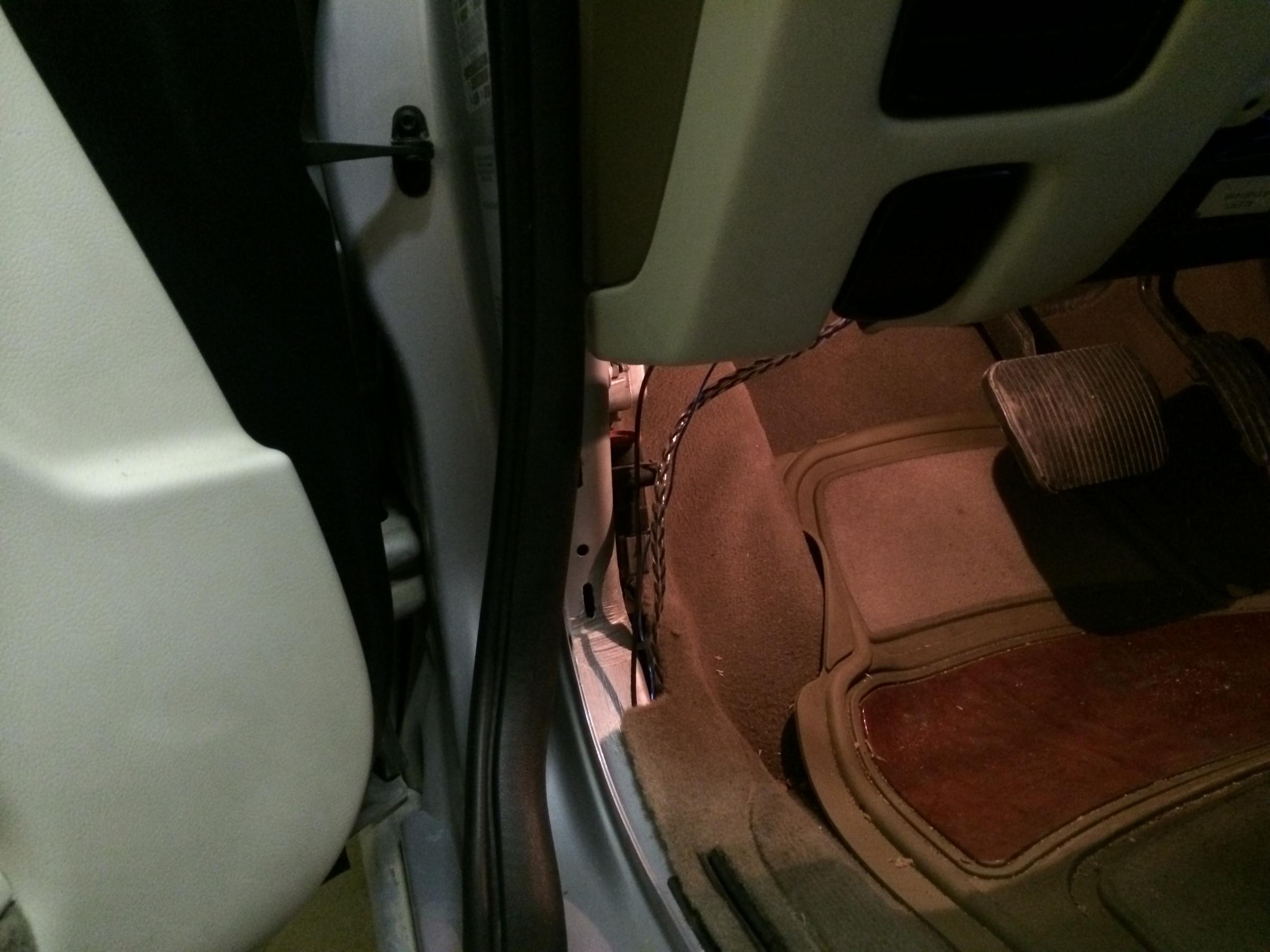

Next, comes running the wires needed to work and power the sub woofer, amp, and backup camera. This can be accomplished by running the wires from the opened console, under the steering wheel, down the side of the foot well and into the wire management conduit that runs right next to the door frame under the carpet. This will get you to the center pillar between the doors.

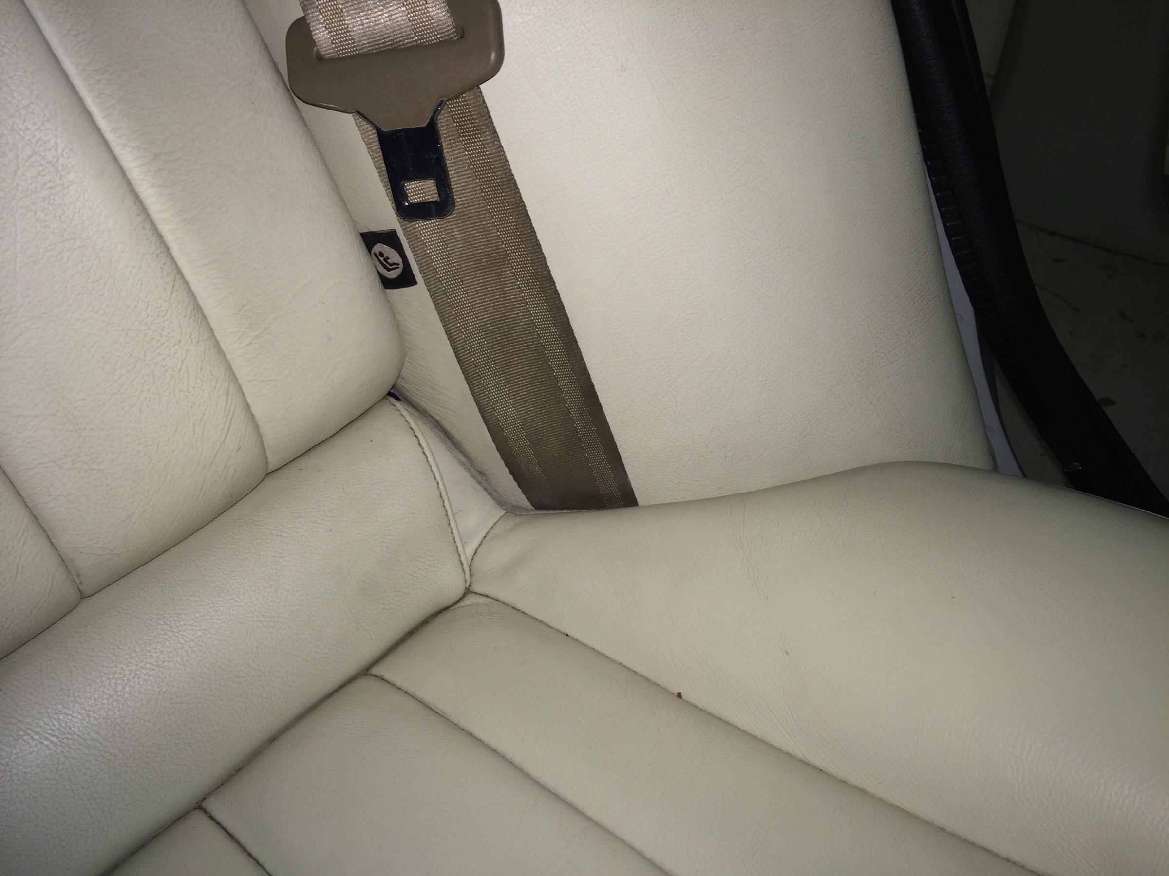

From the center pillar I decided to run the wires under the rear carpet and up between the seats and into the trunk. All of the wires I needed (remote turn on for the amp, sub woofer dual RCA speaker wire, single RCA video feed for backup camera, and a power switch from the backup camera power relay up to the head unit to let it know when to automatically switch to the backup view) fit between the seat and the back hidden out of view. I ran the wires behind the seatbelt and up into the trunk behind the folding seat. It takes a little maneuvering to get it just right, but it is clean and less destructive than other methods.
Pushing the wires between the seat and the back was much easier over near the center of the car and then they slid right over to the edge where I wanted them. Just some tucking between the seat and the side and all of the wires are hidden out of sight without having to drill holes.

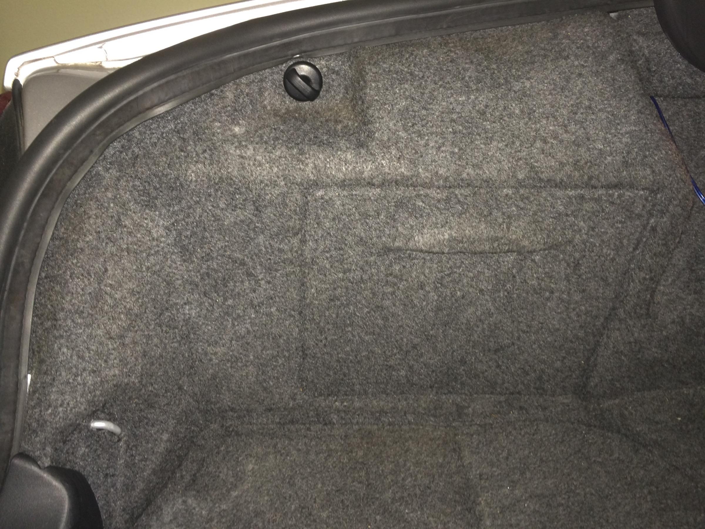

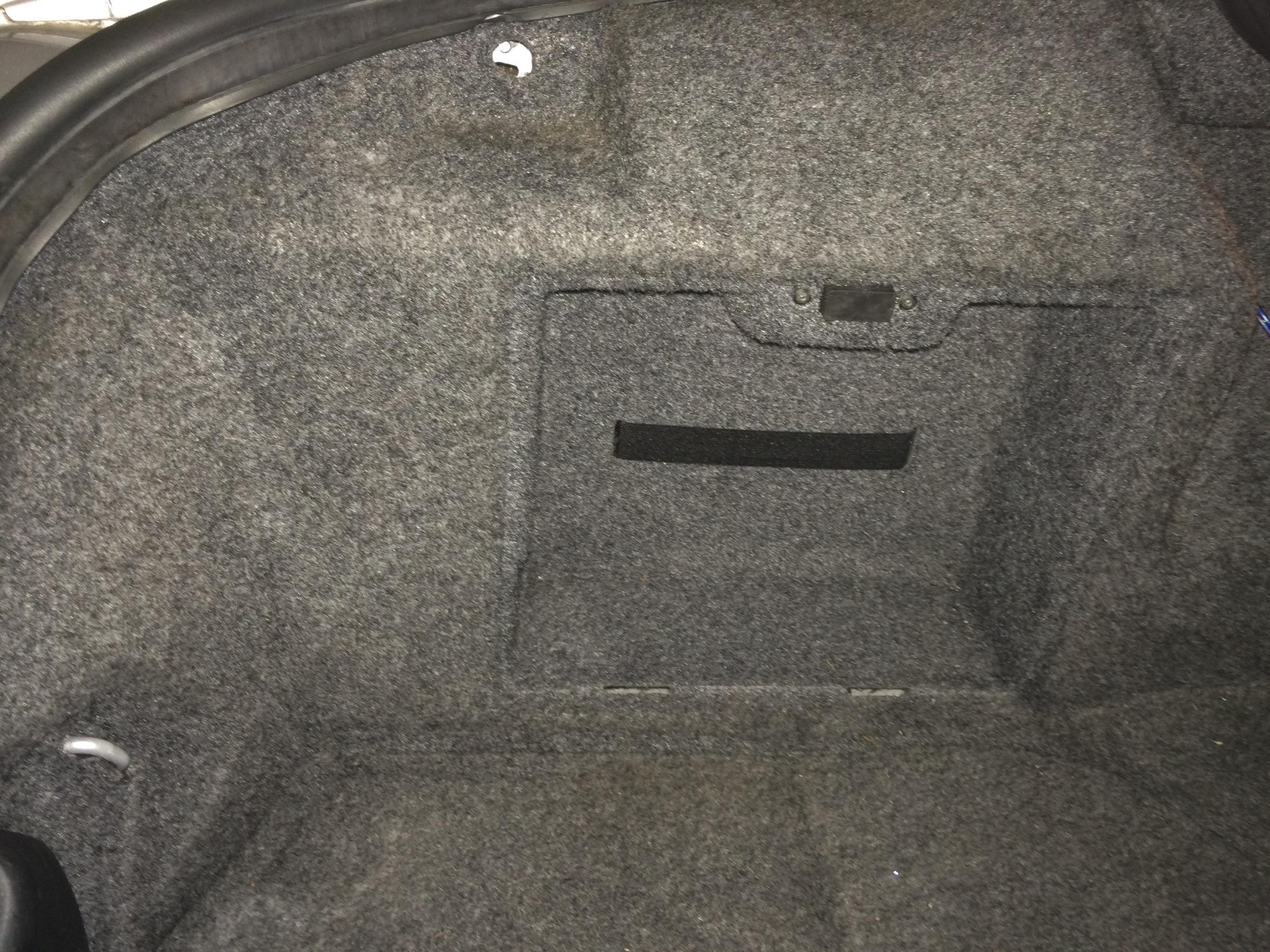

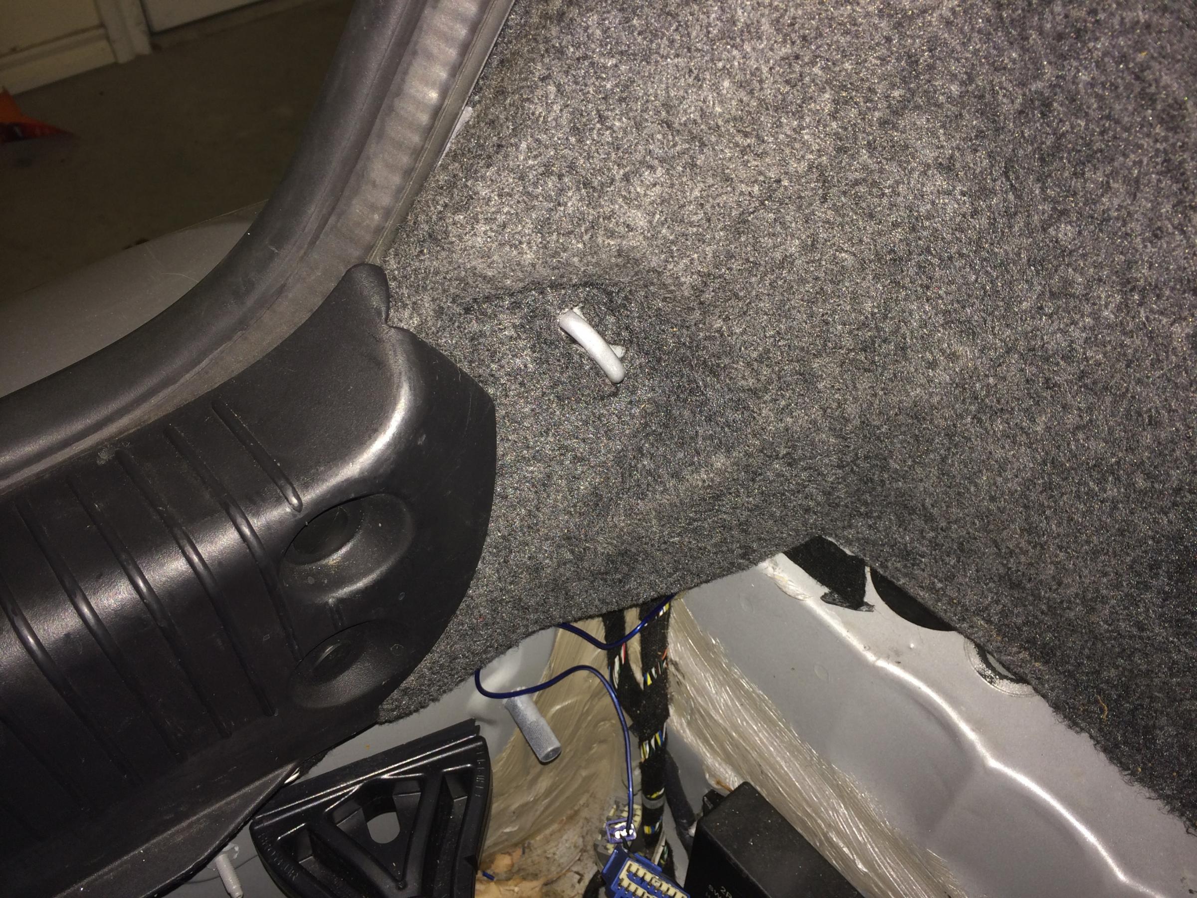

Getting to where the wires are that are needed to hook up the backup camera is pretty easy. Unscrew the black cargo tie on the driver's side of the trunk and pull the molded carpet away to reveal the rear light assembly.
Hooking up the backup camera was a bit of a pain. There is some weirdness with the reverse lights which is usually where you tap in to get power for the backup camera. To put it simply you can't really do that with the Jaguar. I went and bought a relay switch from AutoZone to wire everything up to work correctly.
You find a wire that is hot when the car is on and wire that up to the poles labeled 30 and 86. Then find the wire on the reverse light that changes from a hot to a ground when in reverse and wire that up to the pole labeled 85. Then on the pole labeled 87 your wire up the positive power to the camera and to the wire on the back of the head unit that senses when the car is in reverse so it knows to switch to that input so you can see the camera output on screen. Just find a ground for the negative on the camera and you are done.

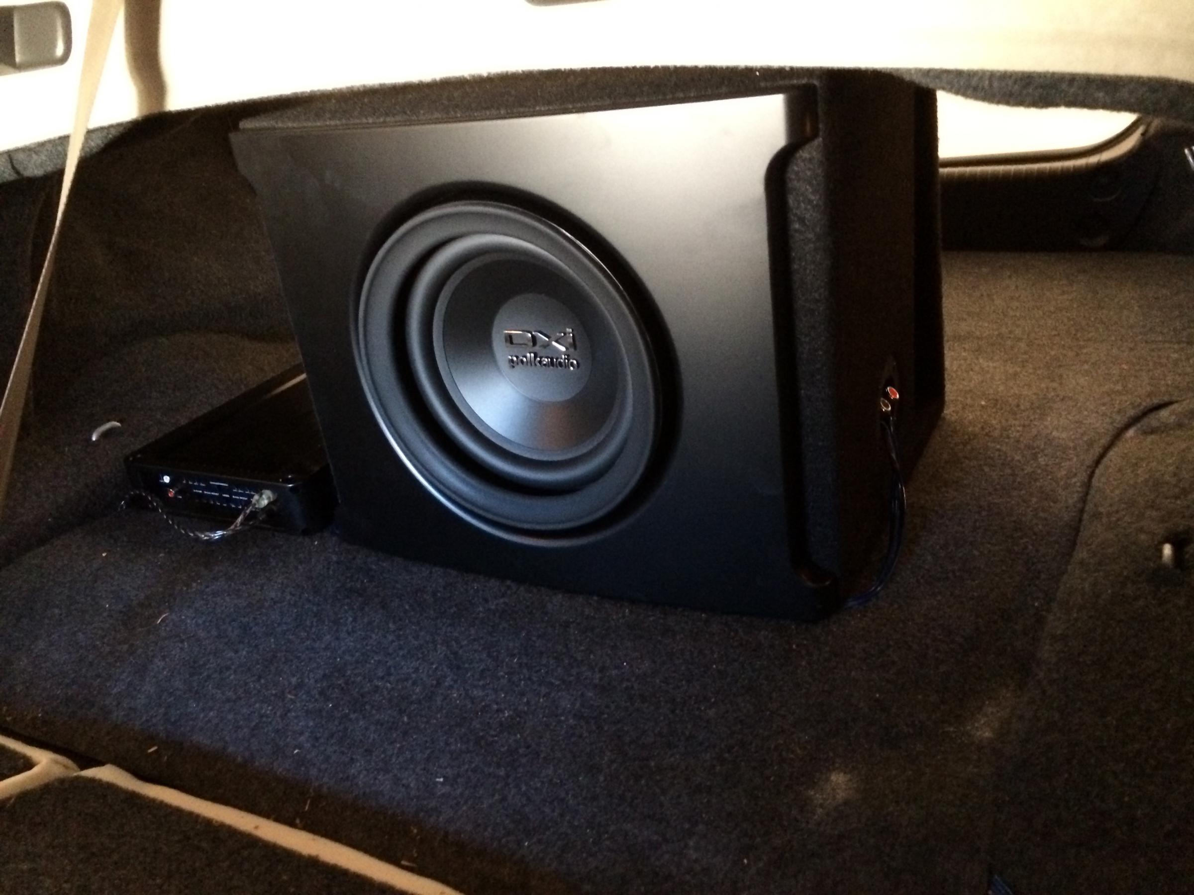

The sub and amplifier are positioned right up next to the rear seats with just a little space between. This leaves most of the trunk open for hauling groceries or luggage as needed. I also have attached the sub woofer and the amp to the floor with extra strong Velcro. I made four pieces of double-sided hooks Velcro by sticking two pieces of the glue backed Velcro hooks together. These were used to attach the carpeted sub box to the carpet of the trunk. I then put four pieces of Velcro hooks on the bottom of the amp and just stuck that to the carpet of the trunk next to the sub woofer. This makes for quick disconnects and removal if the need arises.

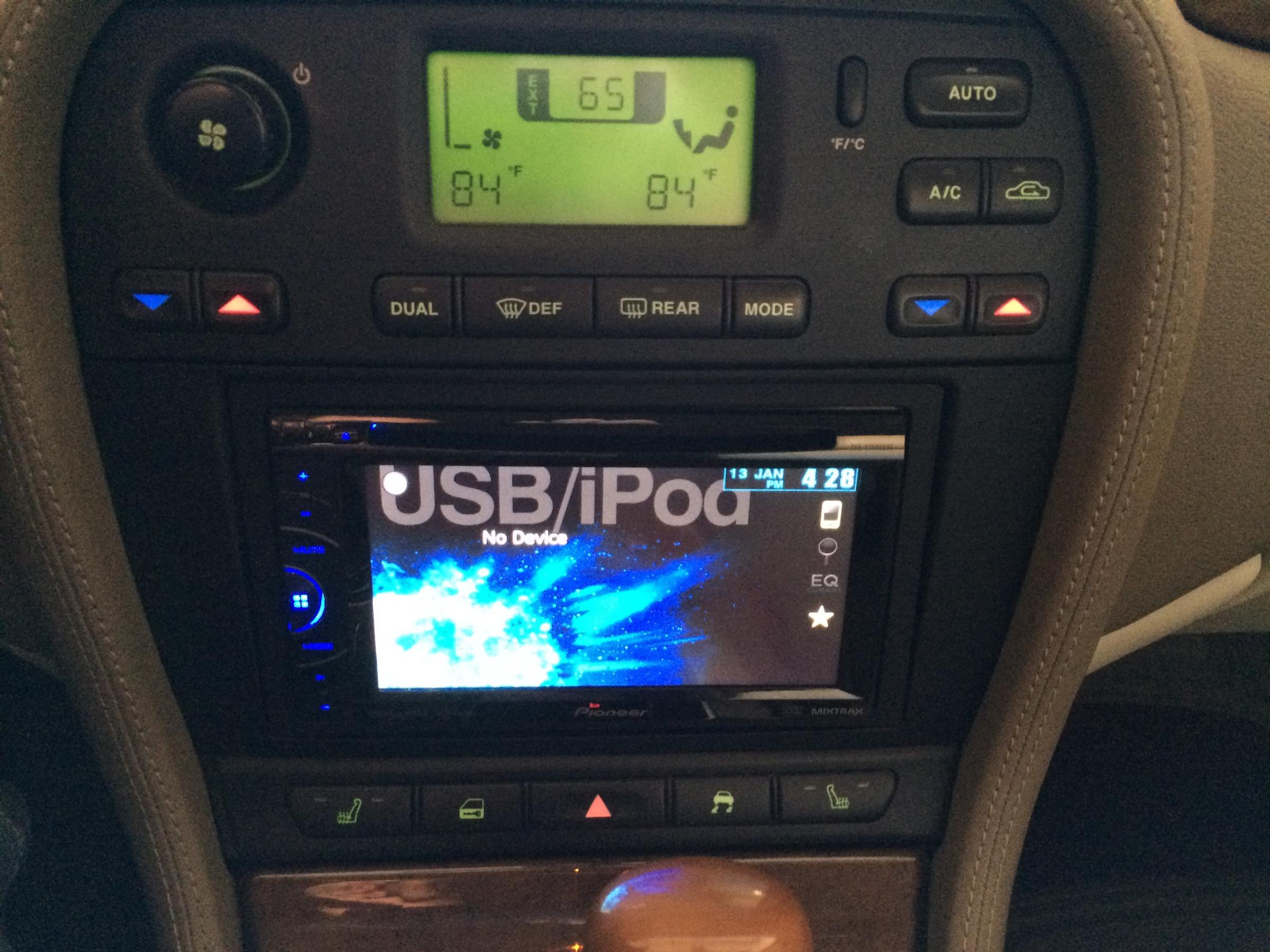

Here is the new head unit in place.
Watching The Hobbit...
