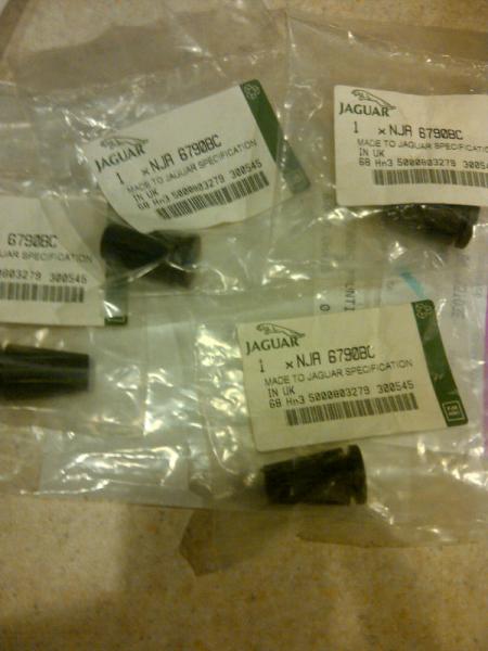

Default Mounting Grommets Arrived!
Finally found the parts thanks xjrguy!!!
Here they are if anyone else is interested...

Okay so I took a shot in the dark on this one - there is very limited documentation out there covering these so there was a 50/50 shot... Needless to say I got the wrong 50%
Anyone looking to replace the beauty panel grommets on their STR or other engine with a plastic beauty panel. I just found out rather expensively that the tall part DOES NOT fit through the openings on the panel and the one I did mange to fit through is too tall to let the panel sit flat!
Instead if you are looking to replace yours you will need the shorter ones:
Part Number:
NJA6790CC

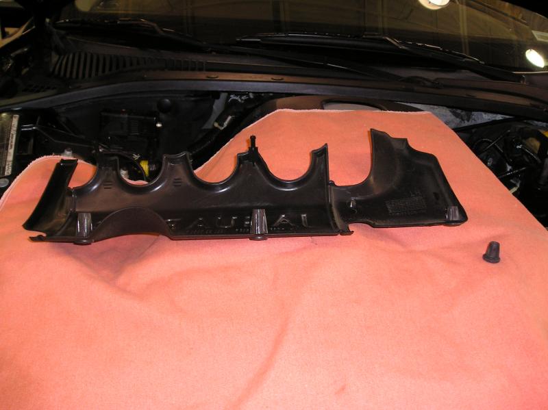

Well, sh** CB....... please accept my apologies for steering you wrong! I went back and re-checked the notes that had been put in the parts catalog. Obviously someone goofed when they added the comment about the 4.2L SC. I have corrected that, and confirmed myself that the tall grommets are actually used in the normally aspirated 4.0L XK8 and XJ8 engine covers. The two rear grommets [on each side] are the tall ones, and the single front grommet is the short one that is COMMON with the 4.2L SC cover and the early S-Type 4.0L cover as in the parts bulletin I posted.
Geez, what a mess........
Again, terribly sorry for the error. Especially since I'm usually one that is cautioning folks to be accurate with respect to models, model years etc.
My turn to stand in the corner......
