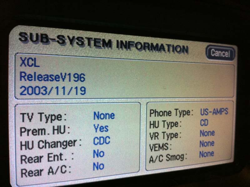

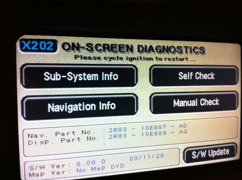

My Navigation firmware version before I stuck in the 2009-2010 DVD disk was SW 8.00.0 03/11/28; XCL Release V196 2003/11/19.

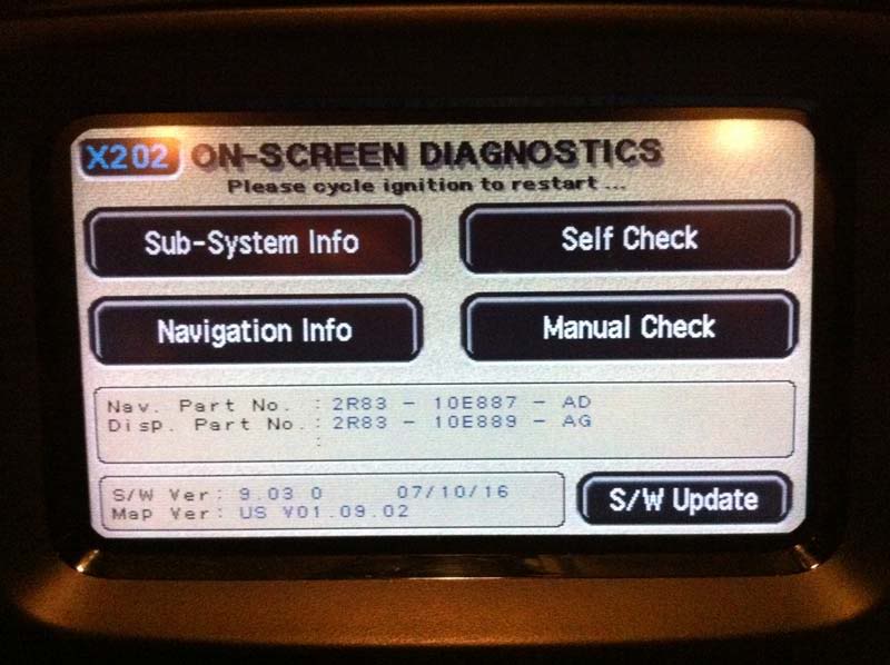

After I put in the 2009-2010 DVD disk (all sorts of stuff was going on on the nav screen and climate controls) I have SW 9.03.0 07/10/16; X409 ReleaseV313 2007/10/15.
You can easily stick in the 2009-2010 DVD and update the firmware.. pull the disk back out.. and stick in the old 2007 map disk and the system works with the latest firmware and older streets.
