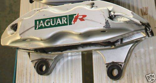

No, only up to about 2005.
All the Brembos are 4-piston. See the photo (sorry it's from an auction listing).
Thanks very much for clarifying this!
