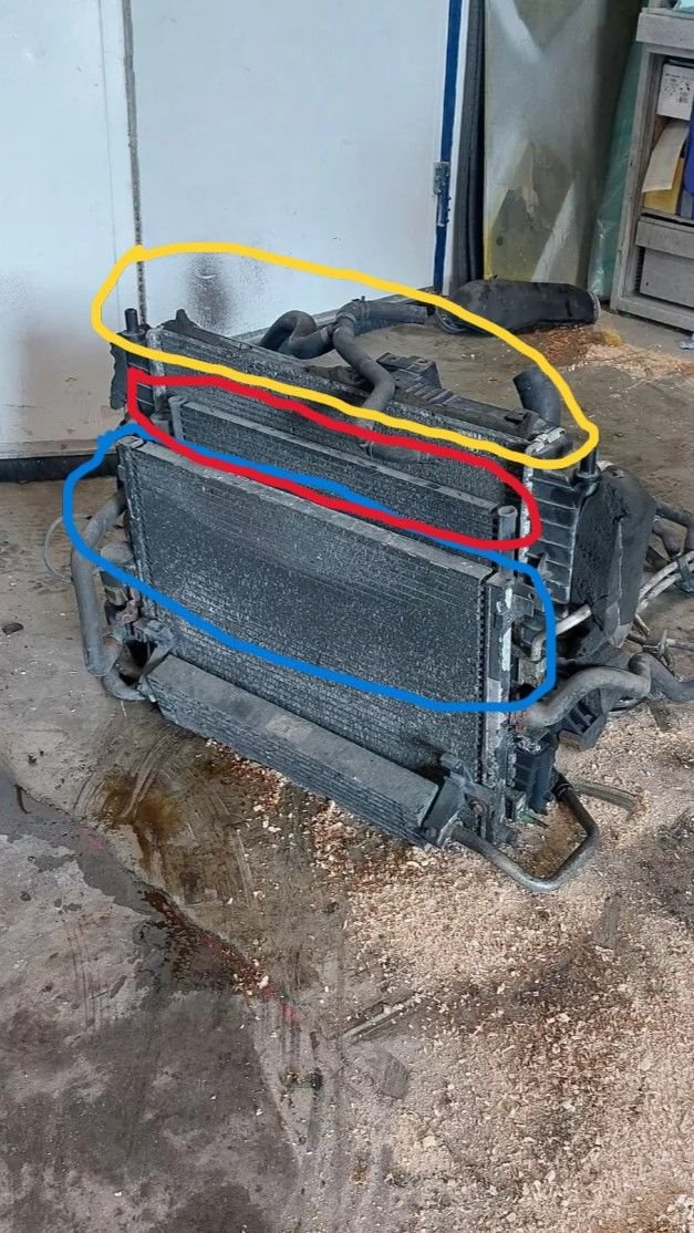

Ok, so I went to the mechanic and we removed the engine undertray, from the looks of it the radiator that is leaking is the one marked with blue, can anyone tell me from A to Z which radiator is which? Tried finding a schematical sheet but to no luck.
Attached is a photo from an Ebay listing.
Also the leak has gotten far worse.

Supercharger radiator about 2000€ brand new haven t been able to find a used one. Absolutely brilliant.
