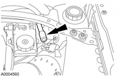

You can just keep driving. As the car cycles hot to cold and back it will work the air out of the system. I still did not see if you used the bleeder up by the master cylinder? I find that for a week or so after draining the coolant it will take smaller and smaller amounts of fluid to top up the system.
Jaguar/Ford added that additional bleeder on the early 2000-2002 cars because air can get trapped in the heater core. They dropped that after the 2003 update but I don't really know why?

On the early cars you really should be using both bleed ports. Here is the best diagram I have to show where to look for the heater bleed port which is kind of hidden and the hose is usually tucked back into all the rest making it hard to see.

Thanks,
I definitely didn't see that valve when the tank was off.
Will have a look.

All of the above people are right, search for the bleeder tbird6 mentioned I have always bled that way on equiped cars, driving the car and continuously topping up is another way if not overheating. Can take a long time though. Mike.

There is nowhere on my tank for a third pipe connection.
I think we're getting wires crossed somewhere...
tbird6, is this 3rd bleed valve-pipe section seperate from the expansion tank itself - where does it lead to?

As I recall it's not on the tank. I expect JTIS shows it
