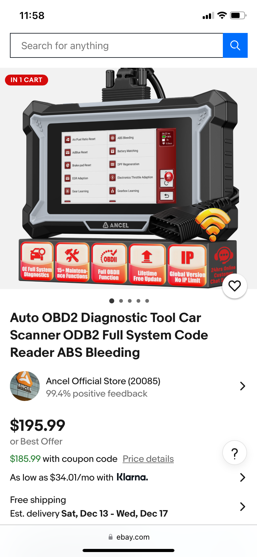

Looking at buying a scanner for myself…. Seen this on eBay and wanted to inquire what you all think. I would like it to also clear codes ect. Basic stuff I guess. Not sure what I need.

That's a hopeless ad - it doesn't give detail what it does for your specific kind (i.e. model) of car (or any, really).

I sadly do not see a sticky with scan tools to be honest. I did a search and well… so many with hit and miss or way to costly. All I was hoping for was around 200.00 or so something I can use to scan codes clear them and maybe do real-time graphing. No auto service locations around me will even look at this car. lol it’s like the only one around for a hundred miles lol. I live in po dunk nowhere. So I am at the generosity of one of my friends that has a scanner, but his is like 2,400.00 way outa my price range.

Before spending $200.00 on a hardware scan tool, I would suggest you spend about $10.00 on an ELM327 OBDII interface and another $10.00 or less for an app that runs on your smartphone and will allow you to scan and clear all or most Powertrain (P-prefix) diagnostic trouble codes (DTCs).
If you use an iPhone, you need an ELM327 with WiFi capability and the Dashcommand app.
If you use an Android, you need an ELM327 with Bluetooth capability and the Torque Pro app.
If you find that you need more functionality, for example the abiity to read Jaguar's proprietary Body (B-prefix), Chassis (C-prefix) and Network (U-prefix) codes, I would recommend looking at the scanners from Autel. Their more affordable scanners typically have the same code reading capabilities as their high-end professional tools, they just don't have bi-directional communication, programming and other professional-level functions. Launch is another company that offers similar scan tools at many price points. Some of our members have had success with the Jaguar-specific tools from Foxwell and iCarsoft, but do your own research.
Even if you wind up purchasing a $200.00 unit, it's handy to keep an ELM327 in the glovebox just in case.
