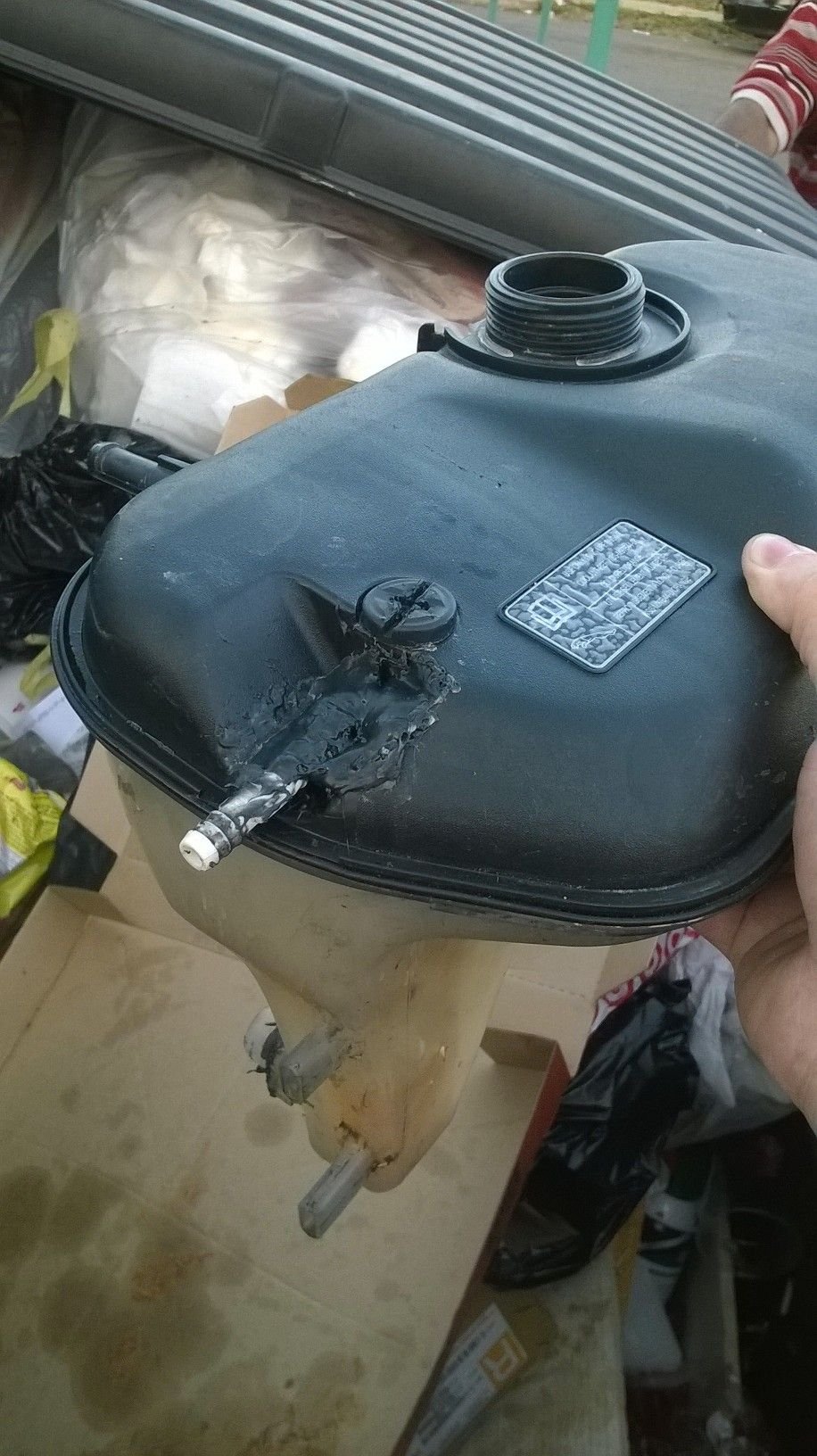

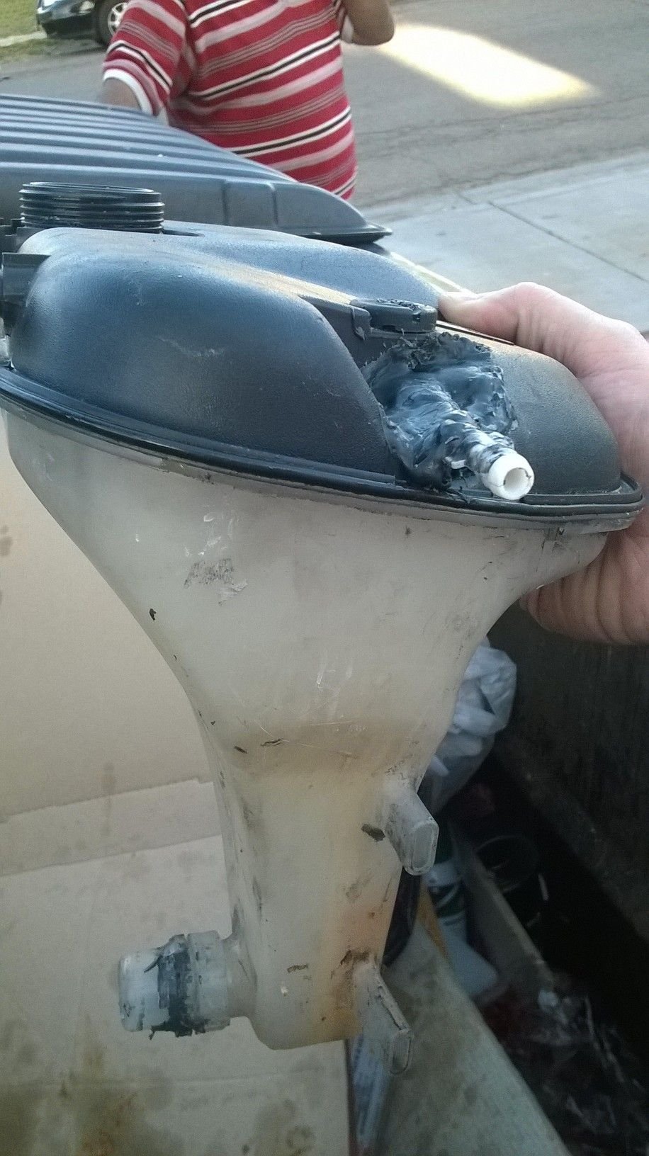

Seller said airbag light was common, he would recharge the ac before I picked it up to see if that solved the issue, and that he just replaced the coolant expansion (after noticing "a very small leak"). He also showed me the old tank...it was sitting in the dumpster next to the car. It looked like it had melted, see pics below.

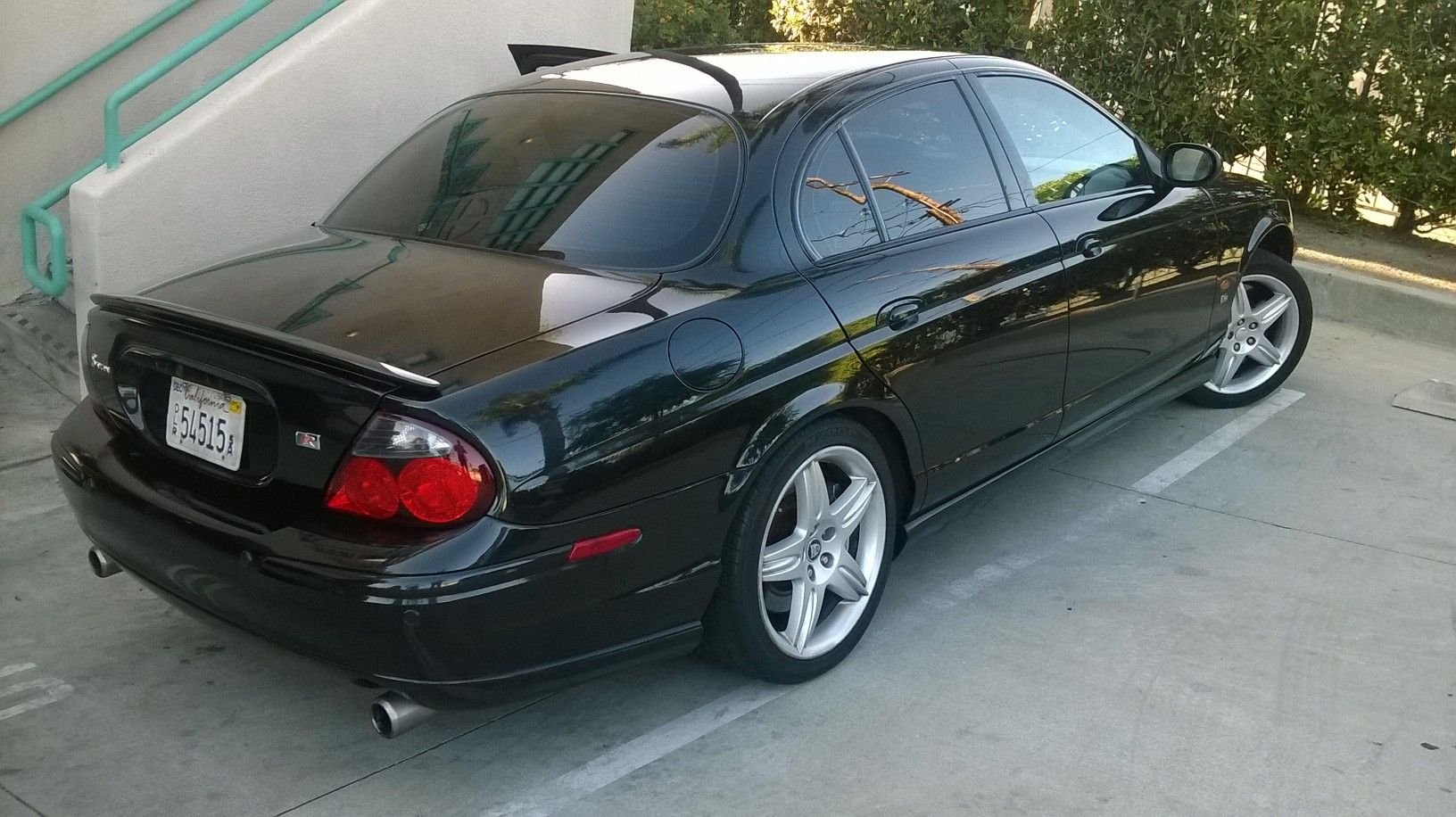

Here are some other pics of the car, otherwise very pretty....

I don't think it melted. I think someone tried glue/weld to try to fix it. Then gave up and bought the new one, which is likely fine.
a/c is likely to be DCCV (and then, maybe, its module) - not a big issue to fix
airbag faults often give flash codes and those can be looked up to find what's wrong. The light is meant to be on (but no flashes) for some conditions - have a look at the handbook.

+1 on the patch up attempt, it looks like some effort has been made to seal up the bottom connection also which is a QD connection, so you should make sure that's not leaking. Get the AC pressures checked and post the results.

[QUOTE=JagV8;1201495]I don't think it melted. I think someone tried glue/weld to try to fix it. Then gave up and bought the new one, which is likely fine.
QUOTE]
Jag, that attempted repair made me laugh. It looks like a first grader trying to build a car out of cardboard and sticks. Funny stuff. I guess like all first graders, the guy got a trophy for a good try.

My head aches after looking at that repair!

Looks like the exact same wheels as mine! What size are they my friend, do you know? Having LIMP MODE issue, possibly due to incorrect rears.
