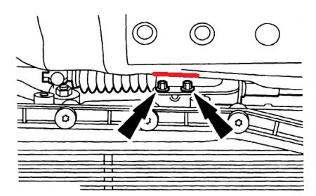

Leedsman the bolts are located in the tunnel part of the frame work. "To cut a hole trough" would require removal of the driver seat and the carpet around the tunnel. Your idea is plausible but still requiring alot of work.
I have been racking my brain and the only temporary fix that still comes to mind, is back out the bolt that is still there and put some anti-vibe thread compound on it (kinda like loc-tite) but you don't have to heat it up to 1500 degrees to break the bolt free to fix the shade tree'er later.
Being an STR and I don't know the "spirited" driving habits of the OP, I can't say my idea would last to long.
There is a pic floating around here somewhere of these bolts. Joyces car won't be back until tomorrow (shes traveling this week) or else I would take a pic and post it up.

Heres an illustration:
Basically from the red line to the 2 bolt heads there is LESS than 1.5" to the tunnel. This illustration is the (drivers side US version) looking up.
