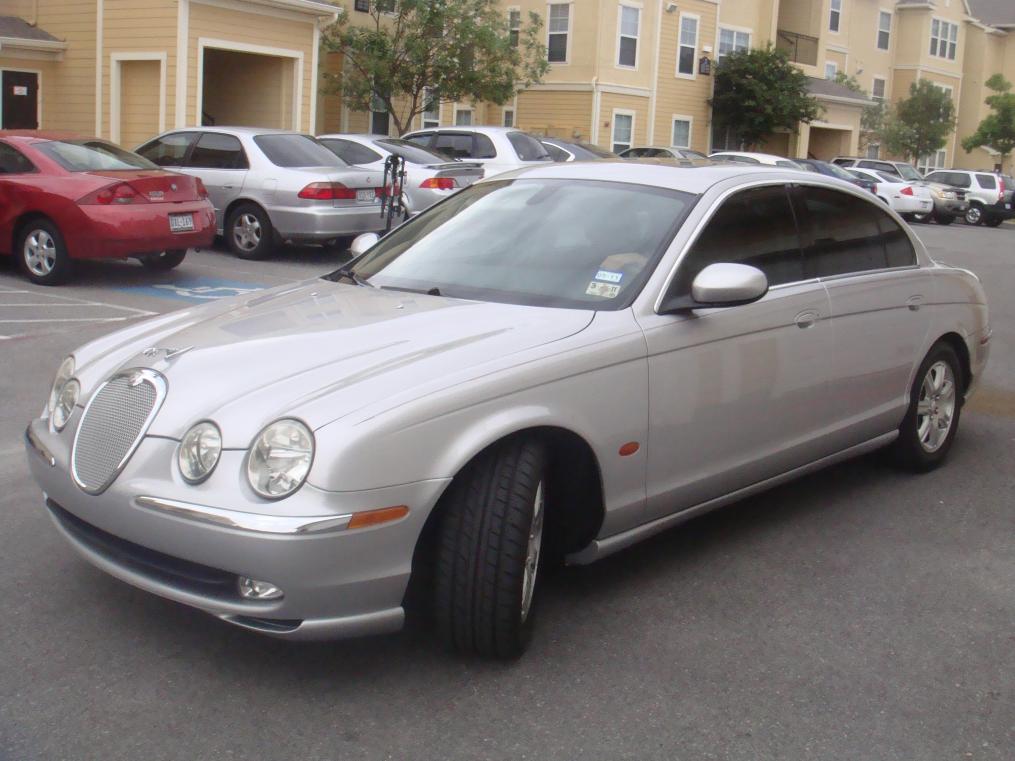

Ready for a Ride!
Thanks Everyone. Got my cat back running
Best Regards,
Rizwan
