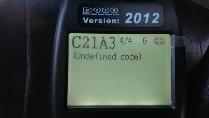

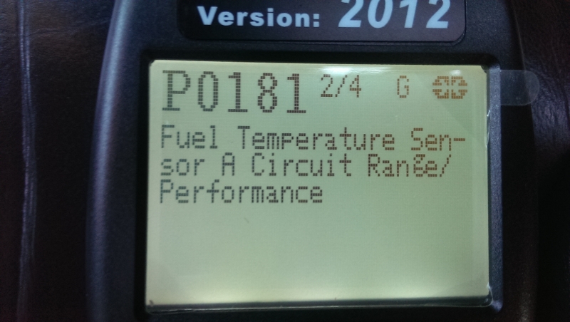

Hi all,
I have another update on this, but not a happy one
I had an engine flush and oil and filter change yesterday and all was ok for the day afterwards. However, I went out for a spin today for a test drive and the Engine Management Light came on again.
I pulled the codes and got:-
Can anyone help?
These errors look seemingly unrelated and the performance of the car is not affected in any way?
Perhaps I should just cover the light. LOL.
Thanks
Mike

Old Nov 10, 2013 | 08:39 AM
JagV8's Avatar
Posts: 27,506
Likes: 4,902
From: Yorkshire, England
Ideas:
look them up in JTIS / codes PDF (free downloads)
use Search
oh - post #2
fix engine-related before any others
13 years old and some faults - not a shock, really - probably very fixable
