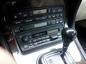

See attachment, that is my car => view of the radio.
I don't think this will work on my radio, mostly because I don't even have that kind of radio
Biggest problem is that I don't have a jag -garage locally, and I have no problem driving up to one, but as I am no client of theirs, I sincerely doubt they're going to do it for free. And I'm kind of on a budget here... Got more expensive problems to deal with first, however this would make life certainly more enjoyable (having music while working on/driving this car)...
