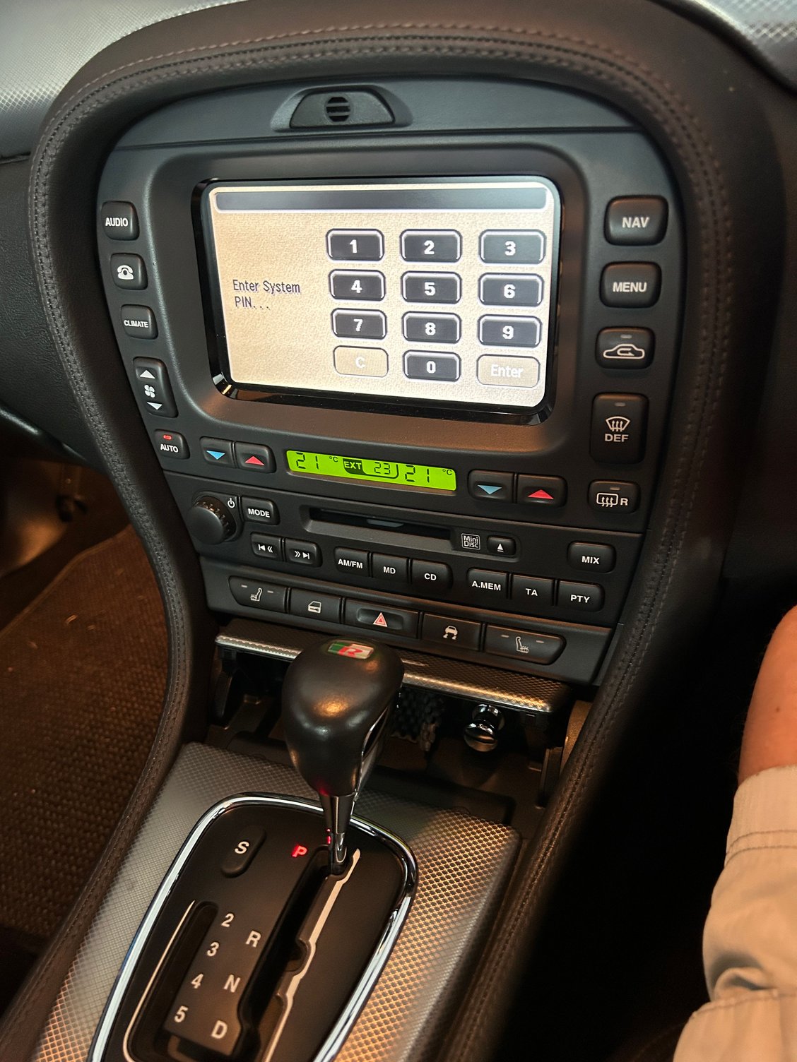

Exclamation Enter System PIN
Following a battery disconnect my 2006 STR is requesting the entry of a 'System PIN' on the centre screen and the only option is for Climate Control - no SatNav, Radio, Phone or Menu options.
It's a japanese import and there's no Radio Code card in the documentation (I'm assuming they are one and the same)
Any ideas how I can overcome this??

Maybe post a photo of your dash as I'm unclear which variant you have (sorry).

Default Does this help? Thx

Try simultaneously pressing:
>>, A MEM, PTY

Brilliant that worked a treat thx.

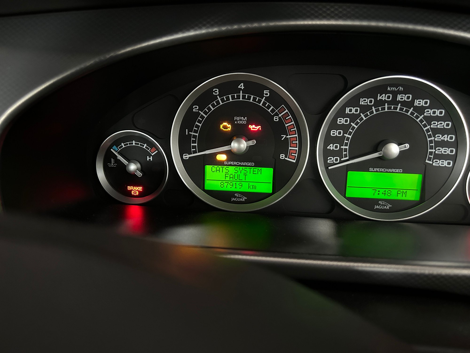

You don't know how I can clear the CATS error do you? Came about after fitting H&R lowering springs, have checked the plug/socket/wiring and disconnected the battery and it's still persisting. 2 different techie/engineers have looked on their diagnostic tools and reckon it's the rear left hand damper but it was okay prior to the new springs and at NZD1600 it's an expensive replacement especially if it doesn't clear the fault.
