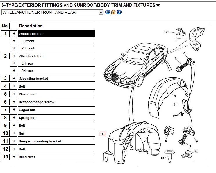

Originally Posted by weldboy
On my 02 S type the front wheel liner in front of both wheel are pulled away from the fenders. It has some kind of clamp thing that is broken. How does it work to hold it and where can I get some to replace them. Thanks
There's a lot of different fixings used on the wheel arch liners:
The Parts Manual list and illustration may help identify the missing items.

It looks like the mounting bracket # 3 in the diagram picture it's attached to the liner with no way I can see it fasten to the fender to hold it. Thought about cleaning it good and silicone caulk it and drill and use some small plastic push pin plugs in it. Thanks GGG for the diagram picture.
I believe what you are needing is number 40 in the cataloque illustration. Item clips to the inside of the bumper cover, and holds a j-nut for the wheelarch liner fastener.
Cheers,
that looks correct! So how does it clip to the bumper cover?

If it's the one I think, looked at edge on it's a U shape i.e. folded over metal and just pushes over the bumper edge. It's then held there due to the screw passing through it, which passes through the bumper as well. (Mine are all rusted up and a pain to get off.)

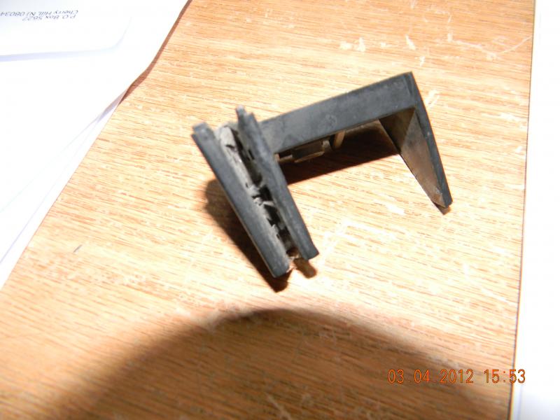

Look at this:
https://www.jaguarforums.com/forum/s...olution-69292/
Might you be referring to these? These have the screw that attaches to the wheel well liner and they attach to the bumper cover... one on each side.
Attached Thumbnails Front wheel liner loose-dscn1448.jpg   Front wheel liner loose-dscn1449.jpg
