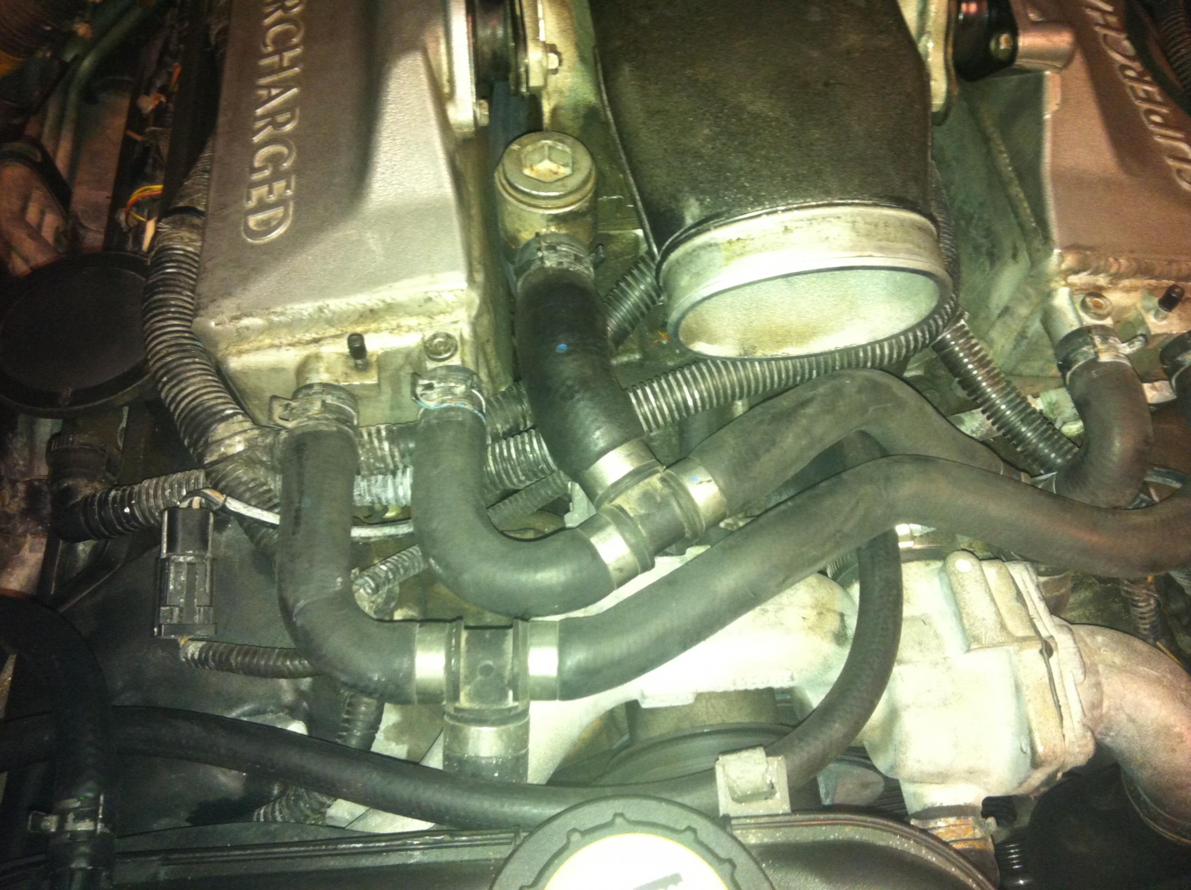

well guys I got her running Tuesday. Turns out a hose on the fuel pump had came off thus not pumping fuel. Put it back on and she fired right up. Couple of issues though. There is a noise coming from the upper part of the motor. Its ubove the intake so I dont believe its the valve train. Any thoughts? Ill be reading up. I know some of the hoses are bulging as well.

Any picture of which hose and which pump it was? The STR is a bit complicated in that area.

ok here is a photo of 2 hoses I can see bulging.

It would be a good idea to change all the hoses you can get to. The cars are now old enough that the hoses are decaying. The ones you show are easy to change so at least do those.
