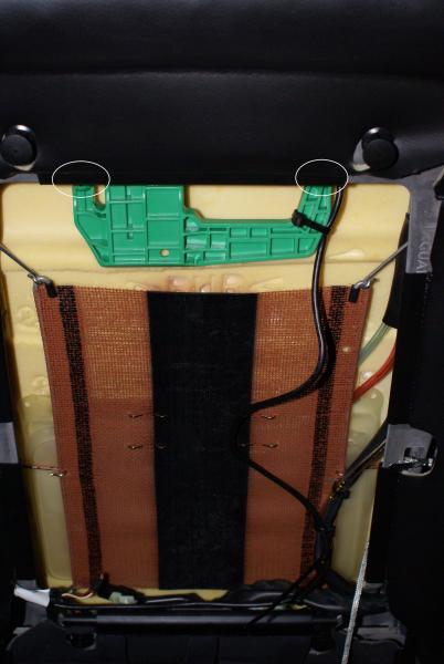

are u trying to fit back stock non lcd headrest or the lcd one?
the stock one shud just pop in with little push , dont push too hard , its all plastic
if it doesnt pop , and ur headrest goes power up but not down then u might have broken plastic part
cheers

Yes, I am just trying to fit back the original stock non-lcd headrest, that got pulled out manually - and will not seem to go back in.
Yeah - I've read elsewhere too, that supposedly, it should just push back in - but it does not seem to ever make even contact with anything to give that final push, to - in order to "seat" it. When I look down into the tubes with an LED flashlight, I also do not see any plastic or recepticle the bottom of the posts can even fit in to. It is perplexing. I know there's got to be something obvious I am just plain missing...

There are notches on the bottoms of the headreast steel posts, which make it appear as though they should just push/snug right into some type of retainer mechanism/receptacle down inside there. However, when peering down into the seat-back holes/tubes - I do not see ANYTHING for these to engage with. I put the headrest back in, and it just slides all the way to the bottom (with ZERO resistance or ever engaging/contacting anything), then pulls easily again, all the way back out.
Perhaps I need to remove the seat rear panel? How is that done? I certainly don't want to break anything more here now, than I feel I already have!

Thanks guys, for the links and the guidance. I finally found it/figured it out! - The picture posted by godfatty, in combination with the link from carelm, where within that string, someone mentioned how the seat-back pops out, gave me my "cure".
The plastic retaining mechanism had apparently, been retracted too far down within the seat and jammed, so that it wasn't able to go back up on its own for me to re-engage the seatposts into it, without that seat back being removed, and me manipulating it far enough and realigning it to secure it back onto the headrest posts that way. - So... ALL FIXED / ALL BETTER now, and once again, I have an absolutely PURRRRRFECT (and fully functioning once again in every way) kitty.
