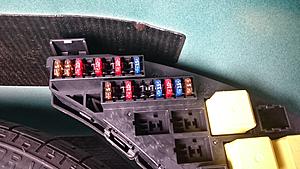

Whilst checking all the fuses I noticed a blown 10A in the boot fuse box, second row 5th from the right - photo attached which shows it missing. I havent looked up what its for yet. Did replace it but no change.
