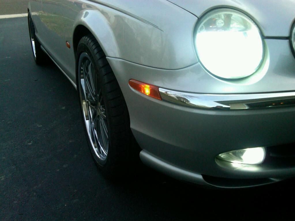

I have 6k in mine - head and fog. It looks cool, but If I were to do it again, i'd go 4300. The light it puts on the road, and signs etc is a bit blueish...
Here's a couple pics, and my car is silver.
George
