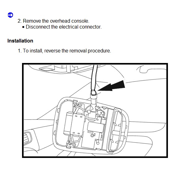

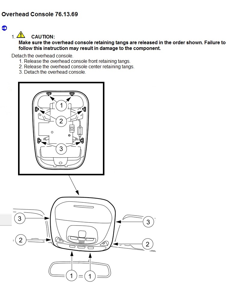

By 'dome light' do you mean the Overhead Console? If so, here is the relevant extract from JTIS:
(click on the images to enlarge them)
There looks to be plenty of opportunity for breaking plastic tangs if these aren't released properly. Perhaps someone who has removed and replaced the console could offer some further advice.

Start With The Front Edge And Just Use Light Pressure As You Pull Down On The Console. Don't Try Pulling The Clips Out In One Go..Instead Try To Pull On It In Stages By Tugging On It In Small Increments.
