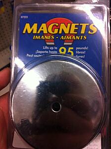

How To Magnetic Center Support
Even after reinforcing all the original screw holes and drilling new holes for the screws, a small portion of the center of the hood liner was still touching the engine cover when the hood was closed. A quick way to test if yours is (and I bet it is) is to take a piece of tape, lay it sticky side UP on a center / tallest area of your engine cover and close the hood. When you open the hood, if your tape is clinging to the fabric or has pieces of fabric on it, it means the fabric's touching the engine.
You'll need to find a way to create a support. You could always drill a hole into the metal of your hood (VERY risky!), but here's how I avoided doing that in a completely risk-free, safe and smart way.
I went and bought a special magnet from a hardware store (called "Ace Hardware"). It's a $10 or so magnet with a hole in the center, which is meant for screws or hooks to be screwed into it.
It's pretty simple, I took the hood liner down and placed the magnet against the center metal of the hood where I knew the fabric was drooping.
I drilled a small hole through the fabric of the hood liner, making sure it lined up close to the magnet screw hole.
I put the hood liner back over it and lined up a screw and washer against the hole and screwed it in.
What wasn't simple was finding a screw that would fit the hole, I only found a screw with a bolt head and it was way too long, so I had to use a dremel to cut the bolt to length.

Warning: The 2005-and-newer S-Type models have aluminum hoods. Magnets are useless with aluminum....
