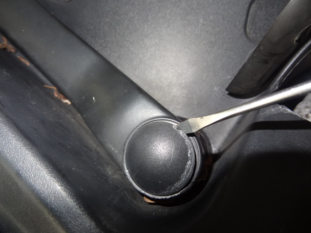

Using the small flat head pop off the covers on the windshield wipers:

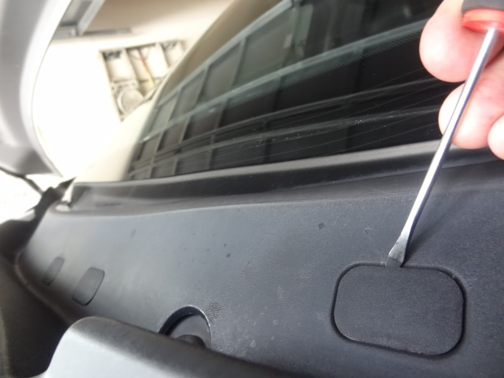

On the top side of the cowl near the window remove covers making sure to remove all of them including the covers near each hood hinge:

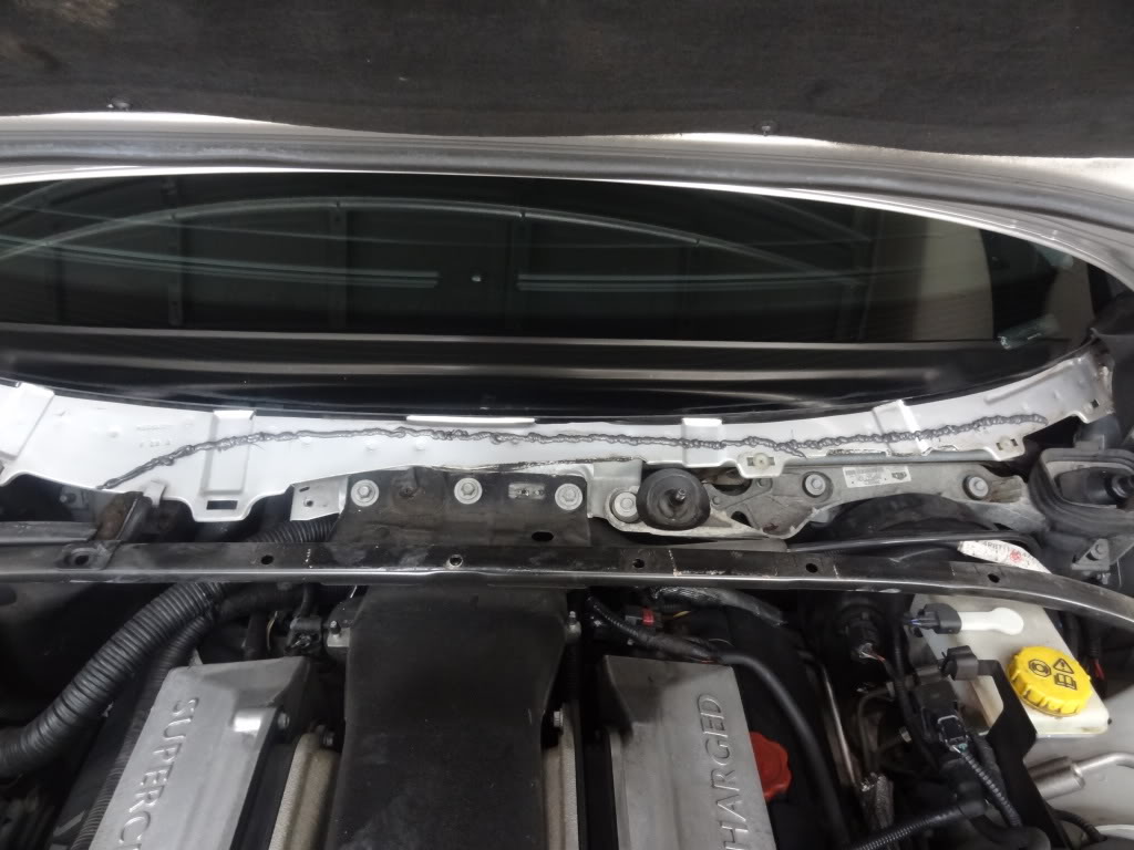

Using brake cleaner spray on a rag or paper towel and wipe off all the dirt to make sure you will have a good bond for the silicone. You will see in the pictures below I tried to make a good semi-curved line from one side drain to the other while still allowing the water buildup to runoff. A straight line or line curved up would defeat any purpose and probably buildup standing water:
Don't worry to much about it being beautiful as the panel is going to cover it up.

Correct, but not a dam...more like a channel. Someone else had posted they ran silicone under the top of the panel but that would adhere it to the window like you had stated. I didn't want a permanent 'glue' fix. The dealer TSB just says to put some sticker over one of the torx screw holes located above the TB but that seemed to be a bit like the lazy way out. So I ran a channel in an upside down crescent shape to run the water off into the drains on each side of the engine bay. One drain by the driver side windshield wiper and the other by the cabin pollen filter.
