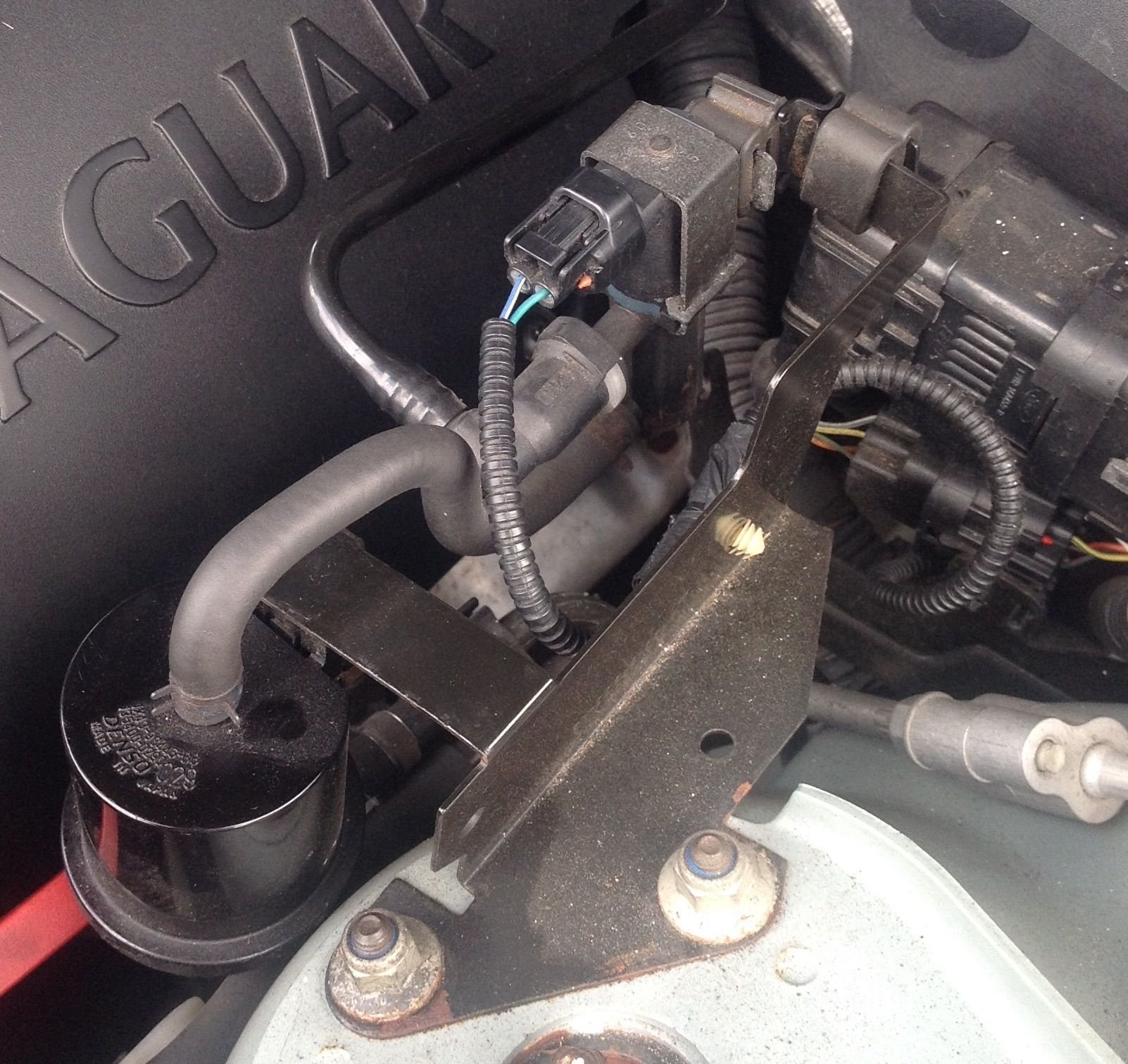

Hi can someone identify & let me know what this does,it is making an Intermitent clicking noise, thanks

That's part of the EVAP system, it's suppose to click. Do you have any stored codes.

Hi mikey, thanks, no codes as yet.

A fair idea of whether all is OK is to get an OBD tool with live data such as an elm327 ($10 or so) then look at the monitor status followed by the fuel trims.

That's your pulse width modulated Canister Purge Valve. It thumps when it purges the charcoal canister. Normal thing.
