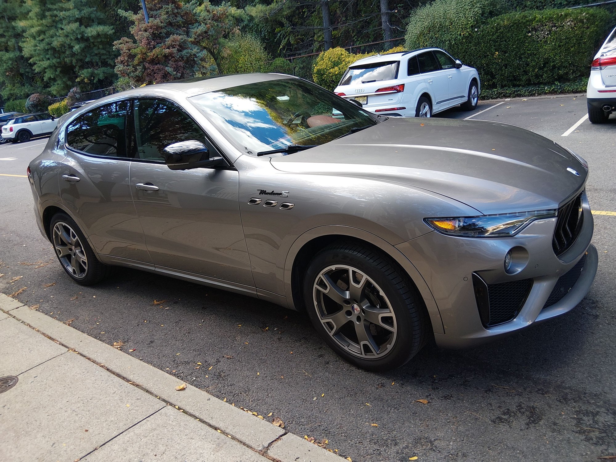

At his urging I looked at very clean Jag Fpace with the 542 HP V* which is an evolution of V8 found in the STR and according to my mechanic a lot of the same issues with coolant hoses/pipes etc. I looked on here and found very similar stories so I decided I wanted something different with different foibles. So in one afternoon I drove the Fpace V8 542 Hp (it's a beast but a bit small for me) and the 6Cylinder 395HP (which I found to be a more refined car) and the one I took home ... A 2022 Maserati Levante with a 3.8L V8 twin turbo Ferrari motor that makes 545 HP. This is are which I am forbidden to work as that would void my extended 24 month warrant. yes it is fast as ****. I now own 4 Maseratis, the Lamborghini (Leno owns 2), a 2015 Lincoln MKX and a 454 1999 Chevy Suburban (tow vehicle for the racecar. At 74 my plate is over loaded!
