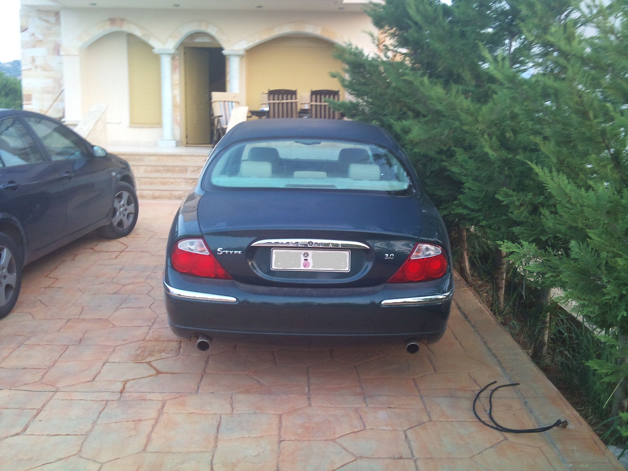

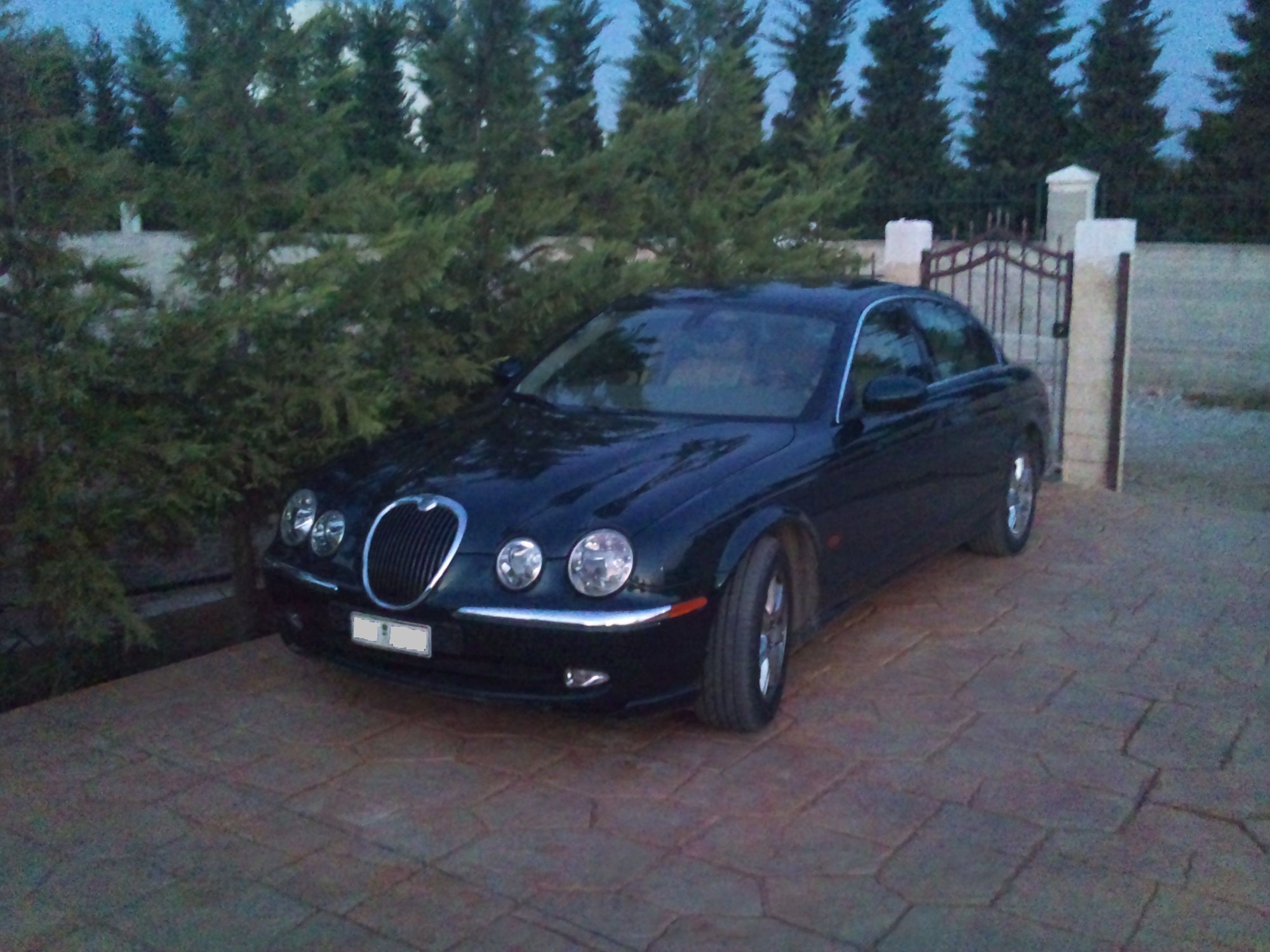

Hello i have a jaguar S Type 3.0 V6 AUTO gearbox, 2002 year model, this is a car that was inherited from my late father , the car is standing still under a protective hood, with the battery disconnected for almost 10 years now, and before commencing any actions to bring this beautiful car back on the road, i would like some guidelines, should i empty all the lubricants,oils,fluids, gasoline if there's any left in the fuel tank, replace the old battery with a newer one? Should i just load to the road assistance truck and take it to the auto garage? Do you think that it's worth all the hassle? Should i try to crank it by hand from within the engine?
The car has not started for many years now, and I don't know what kind of difficulties i will come up to while I'm trying to make it work again. As for the wiring i am not so sure if it's ok or if it has been eaten from mices since it is parked in a privately owned open space garage though. Any information or feedback you may have or can provide it will be really helpful to me.

Your S certainly looks to be in good shape, worth keeping alive if possible. Where in Greece?
