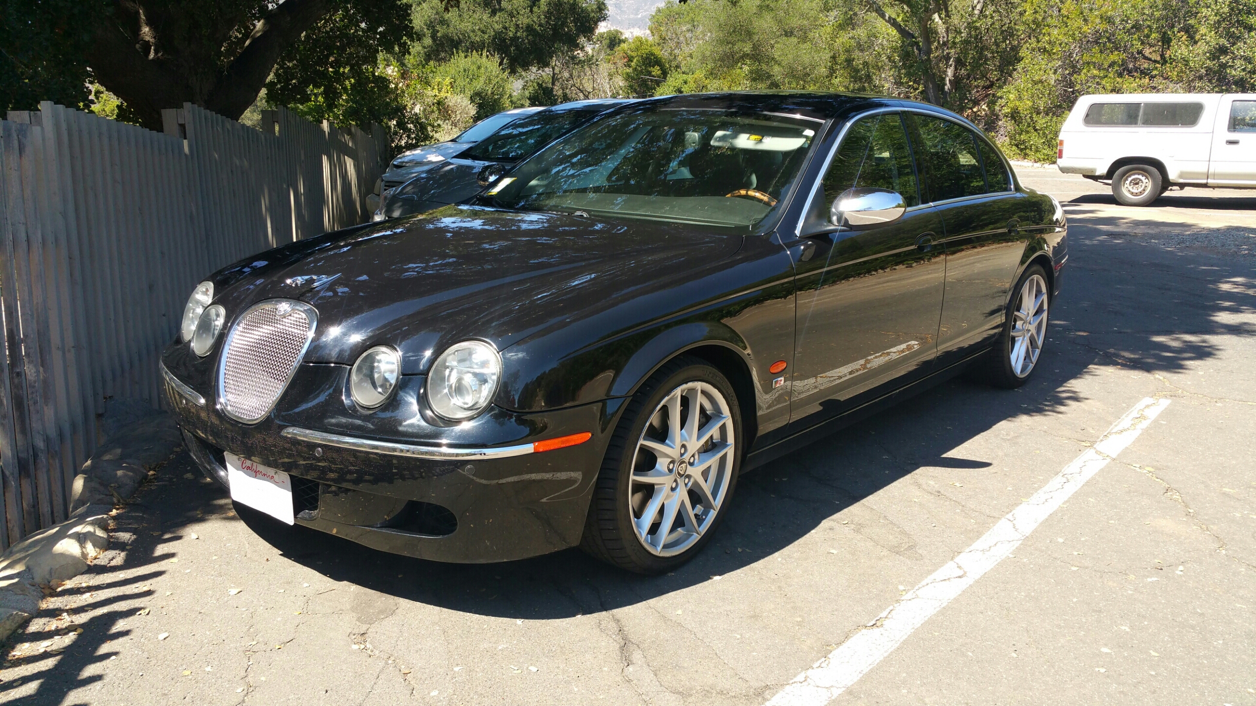

Hello,
Just this week I bought a used 2007 STR with 74K miles on it. I am very happy with the purchase and so far it has been an absolute joy to drive. However, before I bought this 2007 STR, I was considering a 2005 STR, but a pre-purchase inspection revealed that apart from seemingly normal wear and tear (brake pads, front tires, wheel alignment), the A/C compressor was leaking and some suspension bushings were worn out. For my current 2007, the A/C blows cold and so far I haven't heard any clunking noises (which, according to my research, is an indication of bad suspension bushings). However, I went into this purchase knowing that at some point the suspension bushings would have to be replaced and I would like to know if it is possible to order the suspension bushings alone or if I would have to order full control arms when the suspension bushings go bad. As for installation, I am willing to install bushings and control arms myself if the procedure is not too complicated. Also, I would like to know if there are any other components that have a higher chance of going bad on STR's.

Looks good. Congrats. Is that the one from the Oak Tree?

Yeah, it is... How did you know?

I would also like to paint the chrome bits on the bumpers black to match the exterior color. Anyone know where to get the proper paint and maybe the proper procedure?

nice car , looks great . as for the chrome blades maybe get them rapt . or get some second hand painted blades from ebay.
plastic chrome is a very average paint base . and some one may want your chrome ones.

Congratulations on your purchase. You have a very uncommon R. That chrome strip you are wanting to paint is part of the Luxury package which includes the chrome side view mirrors, wonderful upgraded leather and that fantastic burl wood I see on your steering wheel.
In months of nationwide searching I found only ONE R with that option and sadly I could not afford it.
It is your car but I hope you will be respectful of it and reconsider or remove and preserve any parts you feel need "upgrading". You might change your mind down the road or the next buyer might appreciate those very things you are changing. I know I would.

After my purchase I found the original window sticker in the glove box that lists MSRP, specs, installed packages, etc. I was aware of the luxury package installed on the car but I had no idea how rare it was to find a car with that package (it definitely makes me reconsider painting over the chrome bits)! After seeing pictures of other black STRs with the black bumper bits instead of chrome I liked the look of that and wanted that look on my car as well, especially for the front of the car. Would it be advisable to maybe buy some other secondhand chrome bits from ebay and paint and install those while preserving the ones that came with the car?

Sure, but you will have to rmove front and rear bumper covers to swap out bumper blades.

That's why i said in post #9 to rap them .you can just peel it off when your done and it protects the chrome aswell and looks as good as paint , jagbits has the blades in chrome and in primer ready for paint new in stock .so there not irreplaceable , it is surprising what parts you can still buy new .
But as Rick said the bumper needs to be removed and the foam backing all so to gain access to the retaining clips ! If I were you I'd rap them black or leave them alone.

Will the chrome blades need to be removed in order to wrap them? (I apologize if this is a stupid question). Also, will the black wrap match the black on the car and how much would wrapping cost?

No a professional would not need to remove them for rap .
also you would need to ask them if they can match the perl or not . But seriously I'd doubt you would notice if they were just gloss black !
My side markers are gloss black and so are my head light washer covers and you can not tell un till you put your face right up to them and even then they look really good .
