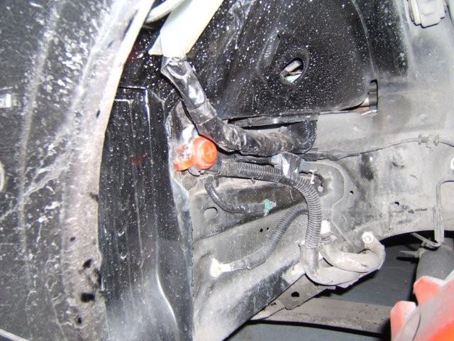

Please check that the valet button is not pushed. It's in the glove box.
Remember you have a spot in the front wheel well to hook up a battery charger so you can pop the trunk!
This is a Lincoln LS but the S Type is the same.
Attached Thumbnails Lock out of Boot (Trunk)!-front-wheel-well-battery-post.jpg
Hook up a battery there, not a charger. Repeating, hooking up a charger without a battery connected has a strong probability of damaging electronics in the car.

The release catches are in the boot, if the is no battery connected, will powering it from the wheel arch point work?
