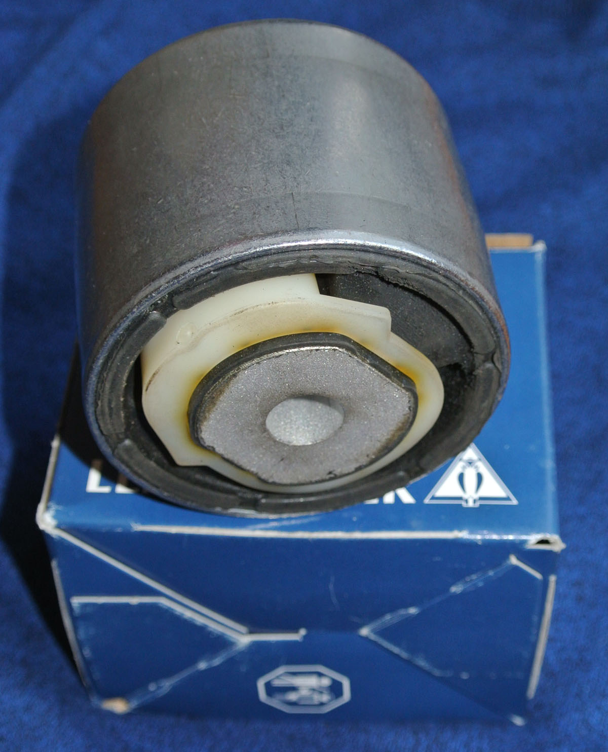

I found a bushing made by MTC.
Is MTC better than URO?
Old Dec 3, 2013 | 11:32 PM
cats4.2's Avatar
Joined: Oct 2010
Posts: 85
Likes: 14
From: Mississippi
I found an answer to my question on Bimmerforums and other places. MTC is not very good.
I'm getting Lemforder again.

I think your smart because we have been told Lemforder is part of ZF and is an OEM supplier.

That bushing is not hard to do. My buddy did the big bushing on a 06 S we flipped. Easy job. Definitely get the Lemforder (sp?) as they are the original manufacturer for many of the suspension pieces on our cars.
