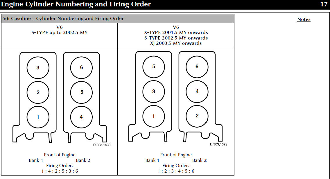

In my experience, there is often only one problem coil pack and other (for want of a better term) "sympathetic" misfires indicated on adjacent cylinders. For a 2003, your scanner has indicated misfires on all cylinders on the left side of the engine as viewed from the front. This side is unfortunately under the intake manifold, which limits your opportunity to swap out coil packs to determine the problem units. I would consider replacing all three coils with OE quality parts, Denso, Jaguar OE, etc.; The R&R on the manifolding as 3+ hours, so playing around with cheap parts in not recommended. The Lincoln LS parts, I believe, will not fit a 2003 as four connector coil packs are used and the LS have only two pins. The above is the cylinder numbering chart from the tech manual:
Old Mar 12, 2019 | 12:57 PM
rallyStype's Avatar
Joined: Sep 2018
Posts: 7
From: California
Thanks for the info and the pic for reference. My plan is to pick up new plugs and coils and replace them all at this point to avoid having to do this work in the other side in the future. Any ideas about the other codes or are those thrown any time other codes are thrown? Thanks again!
